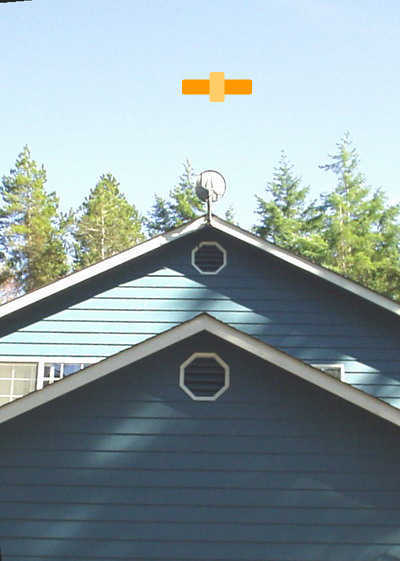

The Dish is located on the edge of the roof, like the one in the picture below. I won't be able to work on it untill tomorrow though.
