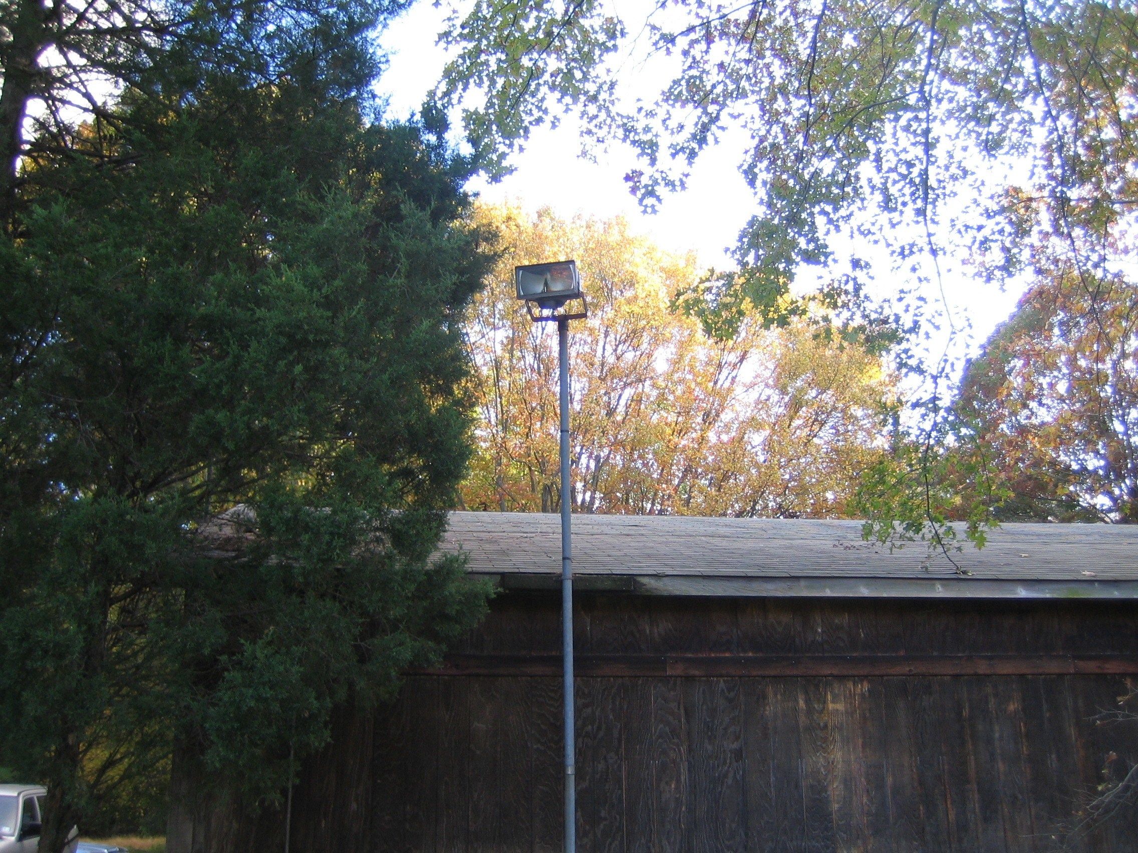

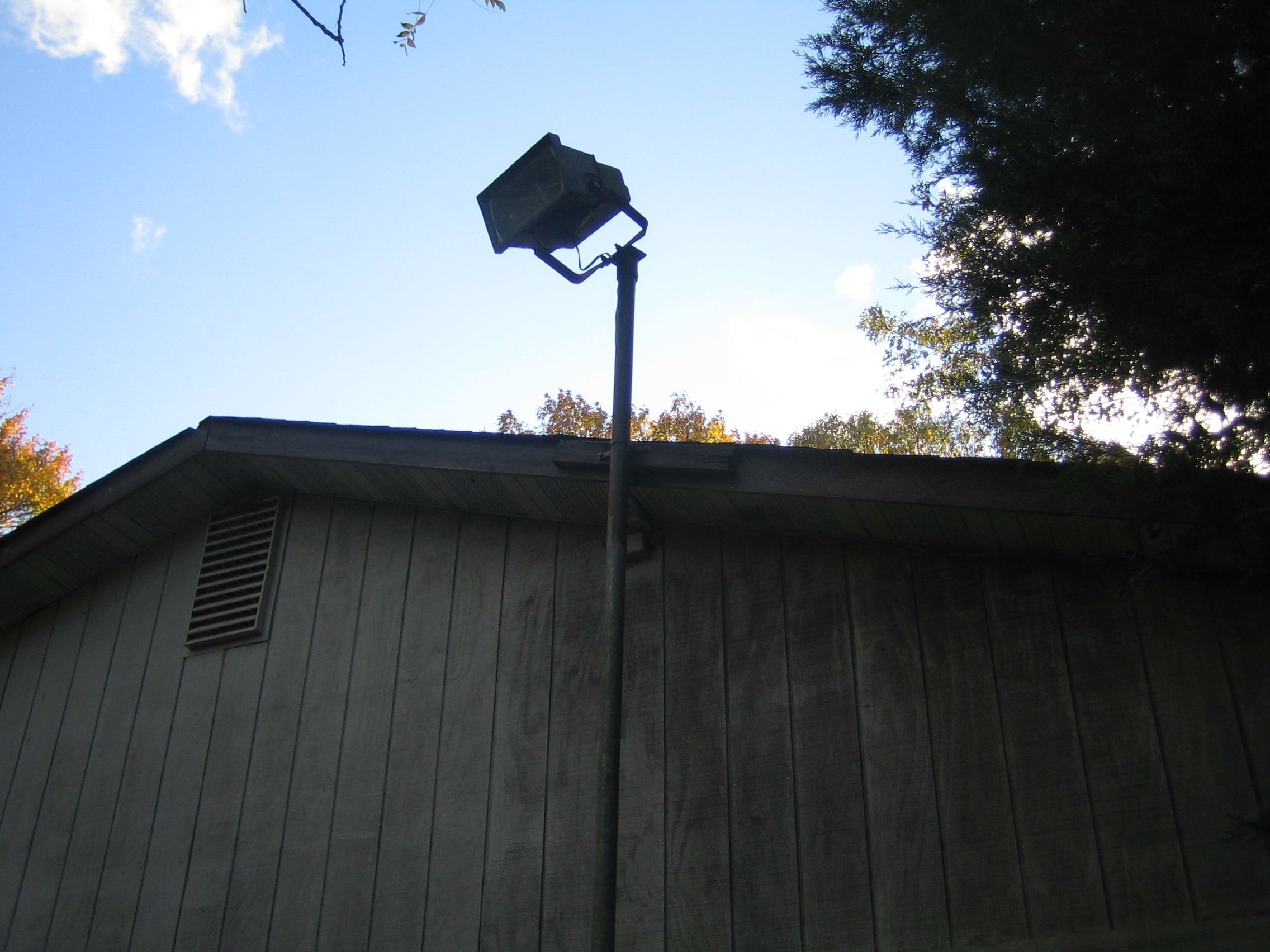

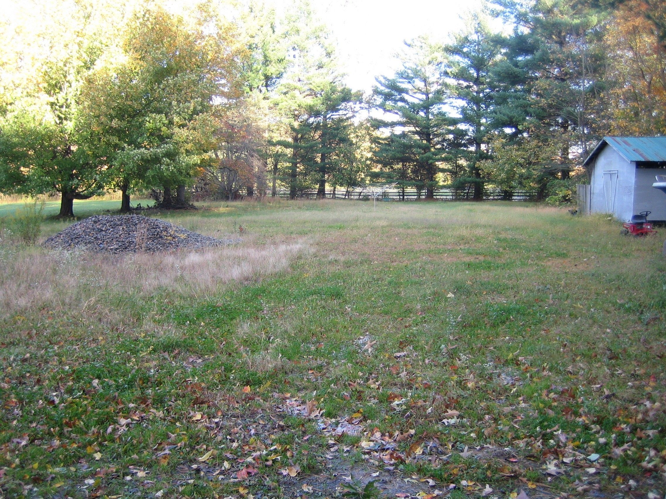

ok, before i bite the bullet and bury a metal post in the field thats in the pic, i think i may give one of these light post a try( removing the light of course, they are not needed) bearing in mind any one of the 3 choices are a few hundred feet from the house,, the building these posts are attached to is across my driveway/parking lot on a separate 1000sqr ft. bldg thats on my property?any helpful suggetsions would be great, i know roof clearance is going to be an issue depening on which way the dish has to face for true south, and willing to cut down trees!, putting up a Geosat Pro 90cm and a motor, thanks

The light post seems like the best/only choice you have, I would cut one just above the height of the bottom of the roof, and mount the dish there.
Man thats not the most conducive view for satellite reception.
Where there is a will there is a way!
