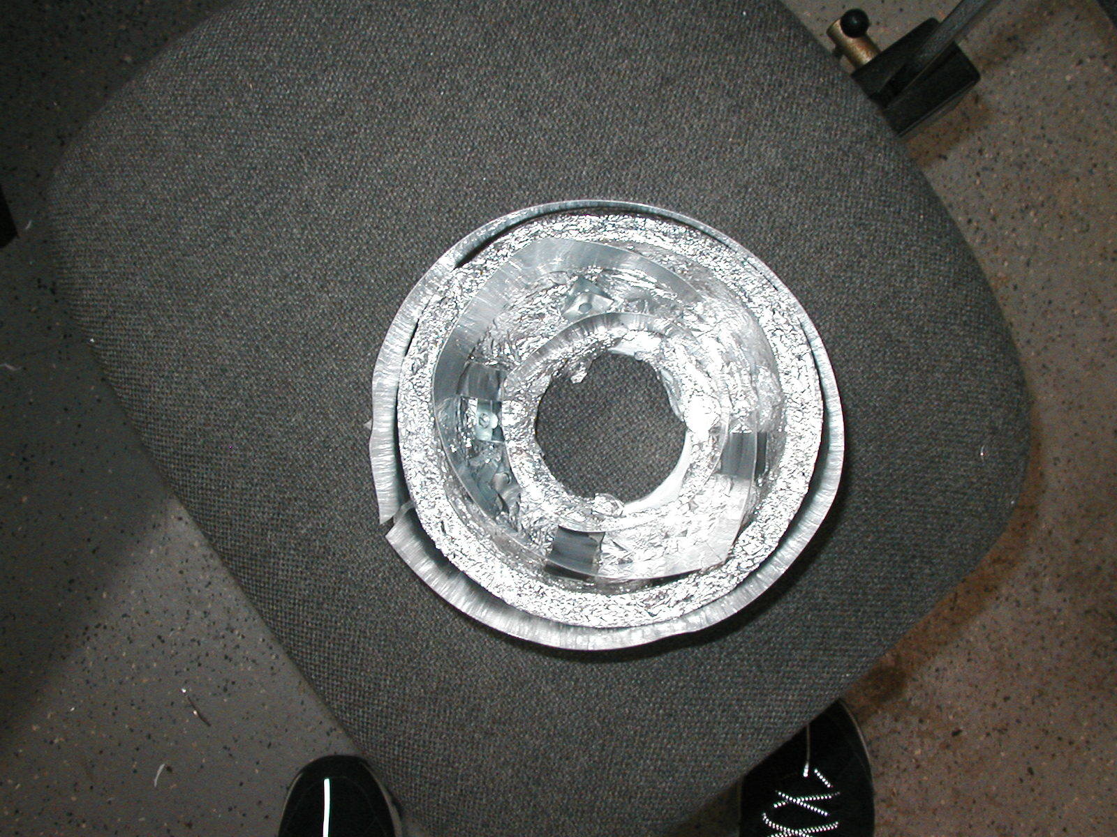

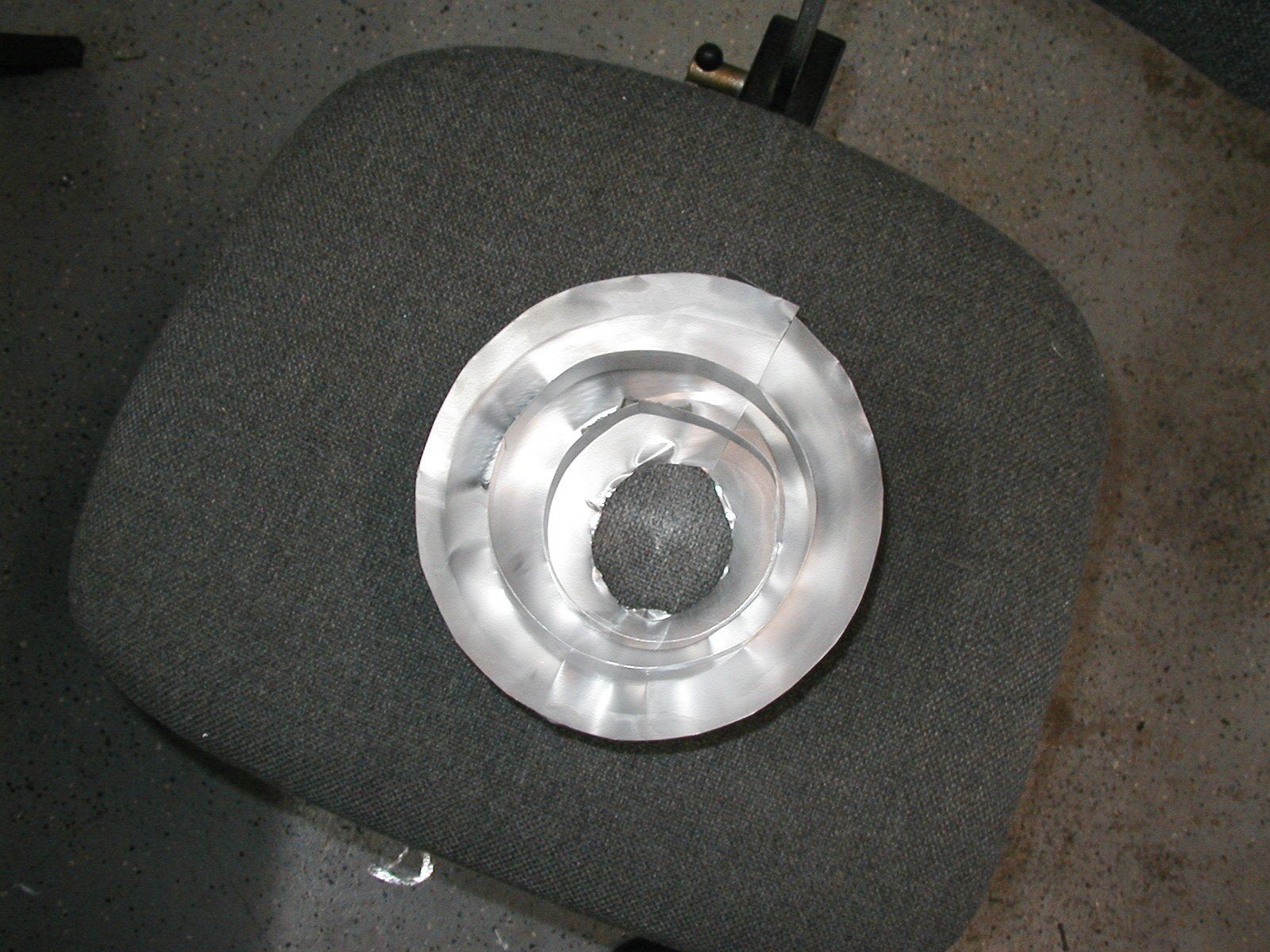

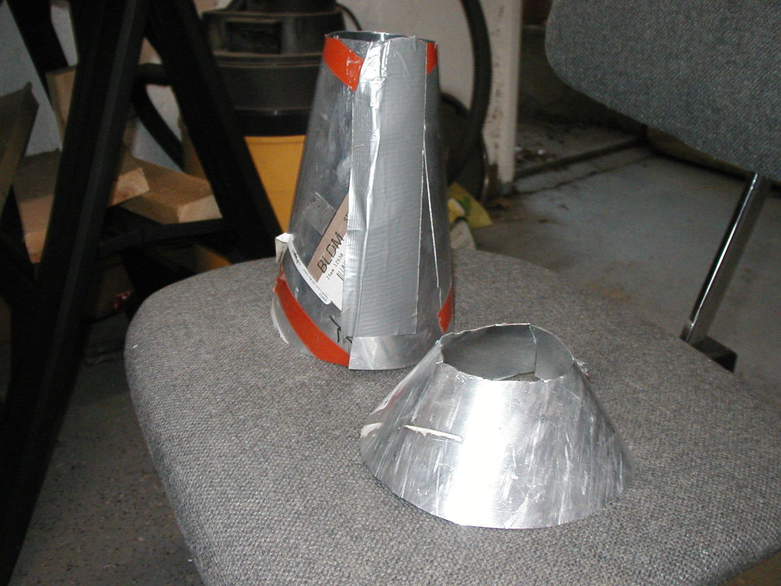

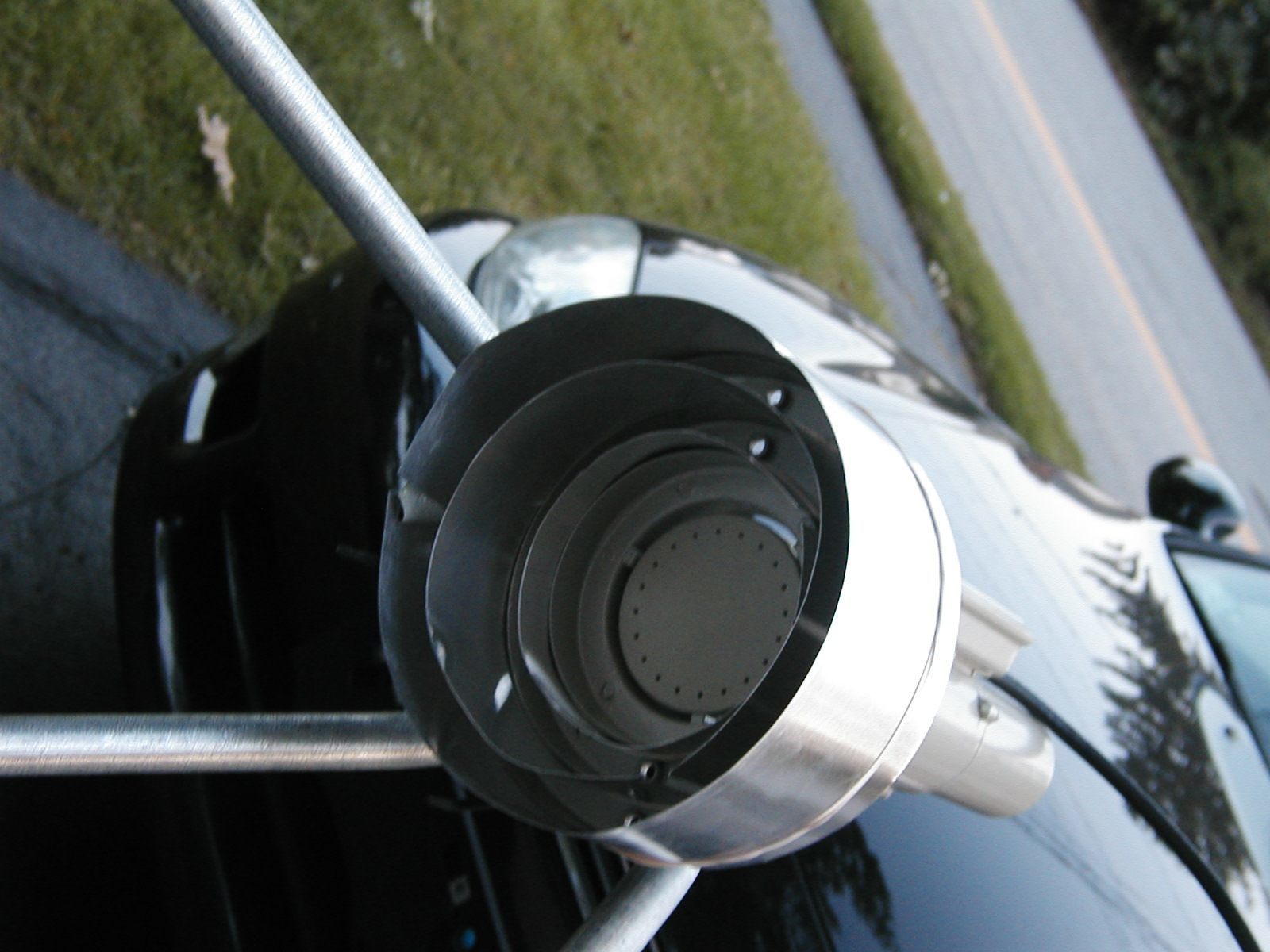

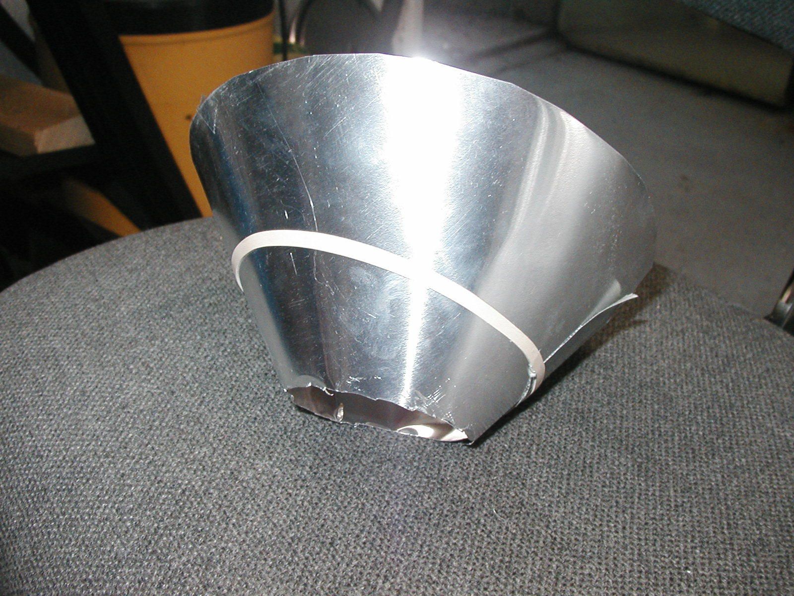

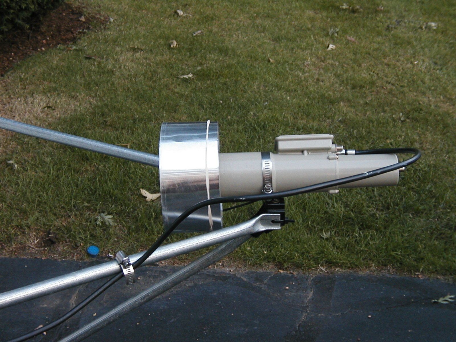

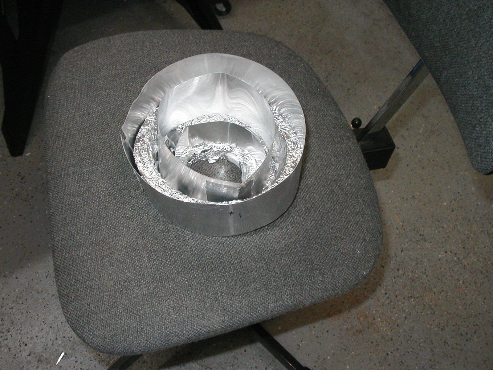

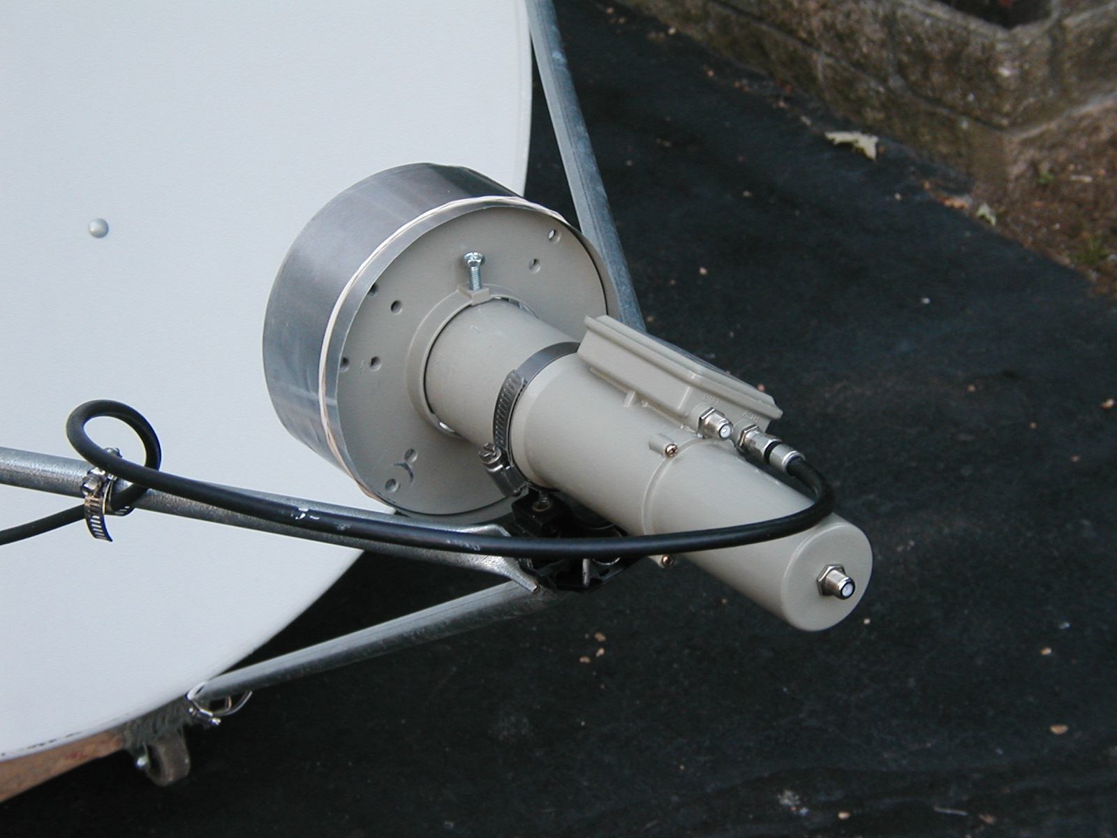

Well, I have been reading up on conical feed horns, smooth and corrugated, and have made a few prototypes. I have posted pictures.
Bottom line-- the smooth horns without scalar rings brought in no signal. I tried three different sizes. All no good.
For kicks, I tried a homemade version of the commercial conical feed horn out of a cereal bowl lined with aluminum foil and scalar rings made from aluminum flashing. Results: No signal. I just threw this together without any measurements or calculations. I must saw that it workd as good as the smooth horns which were carefully calculated.;)
I tried adding scalar rings to the shallow horn (design thanks to Satcomm1). The signal was about the same as the flat scalar ring which came with the c-band lnbf.
I did have some slight success when I simply added rings of aluminum flasing to teh already existing flat scalar rings. Signal Quality went up generally about 3% on my Coolsat 6000 premium compared to the flat scalar ring which came with the scalar ring.
Note: I seemed to have a very difficult time today even finding the birds. Maybe I need to rethink how I mounted the lnbf to the dish arms. Also, I am beginning to get the feeling that the footprint of signal strength does nopt favor the northeast (I'm near Boston), as there doesn't seem to be a lot out there to work with. Also, I purchased a new C-Band Lnbf from ebay (came from Autralia--made in China) for $20, including shipping. It's solely a CBand lnbf and not a dual C/Ku Bnad like the one I am using. It seems DOA. Not a great day.
here are the photos

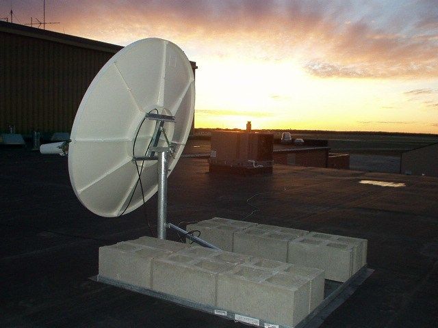

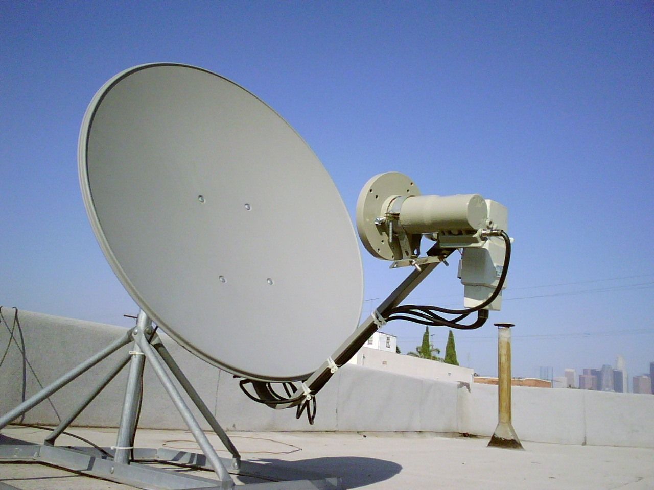

Nice one. If that pic is recent it looks like that dish and mount are almost new.
Picture is just a sample. Same dish but not my roof.
Will post when I get to install the dish.
Will be upgrading current dish with this one.

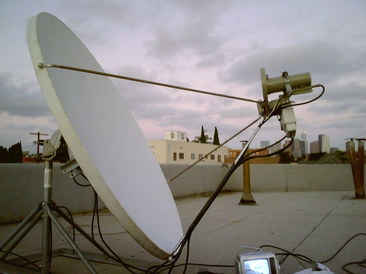

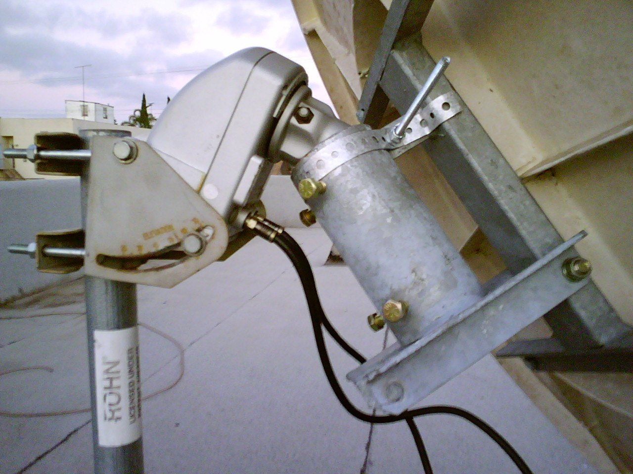

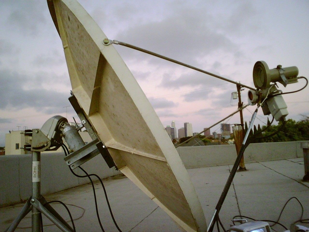

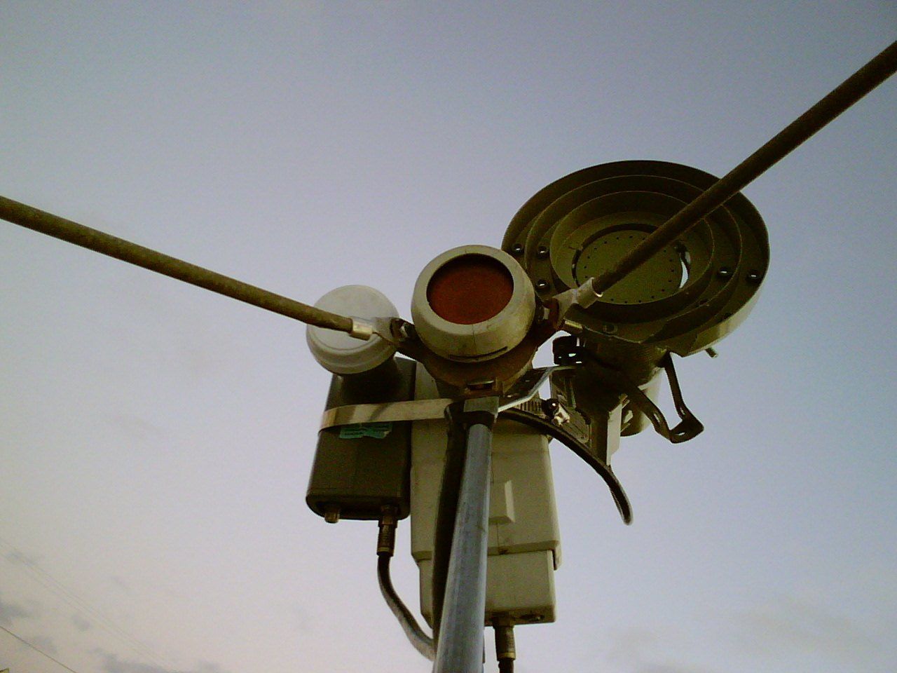

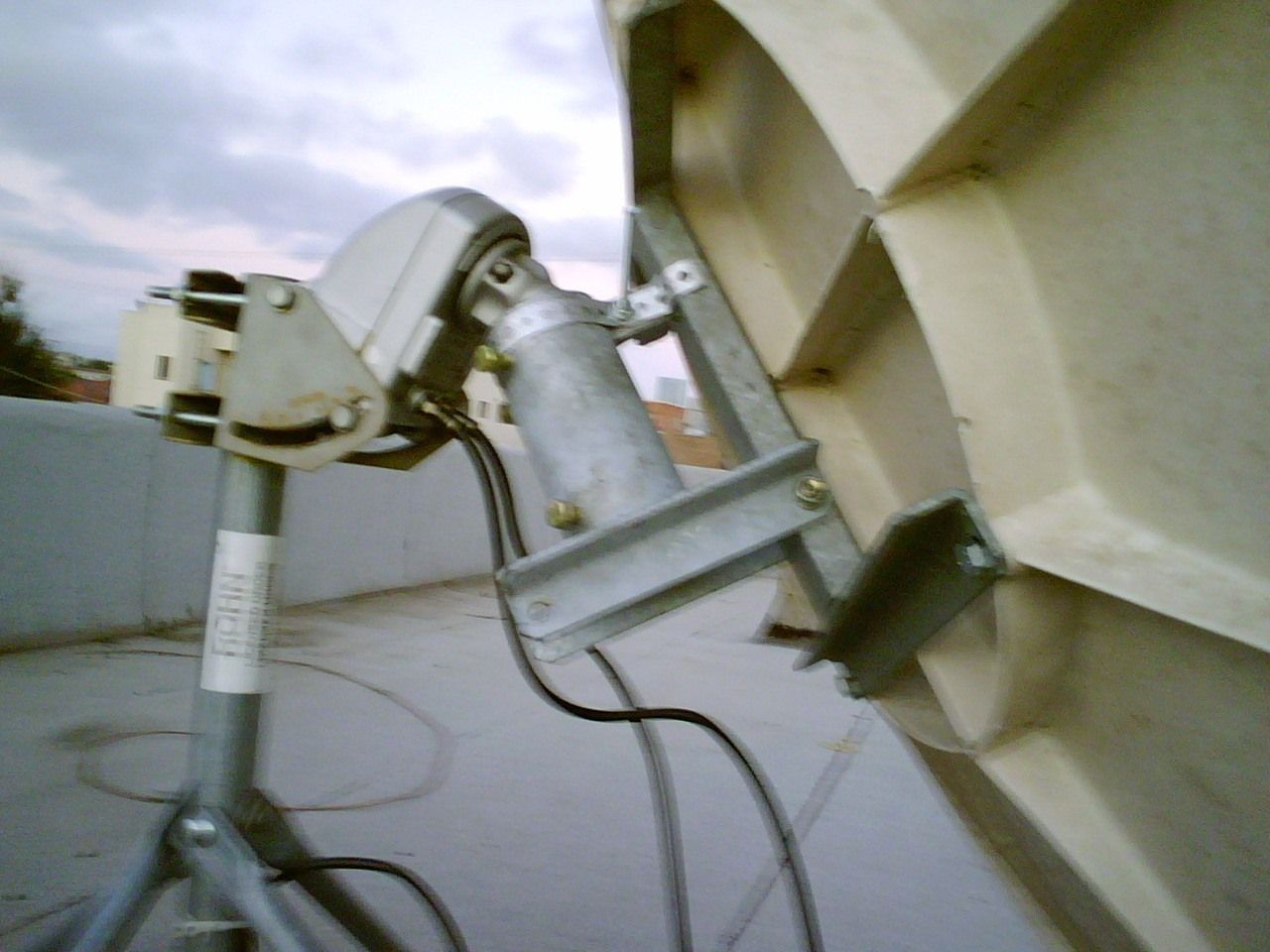

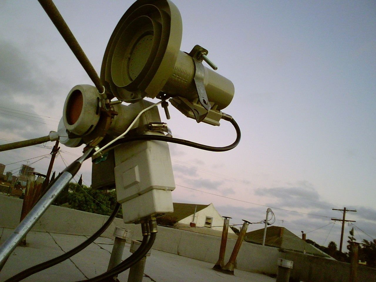

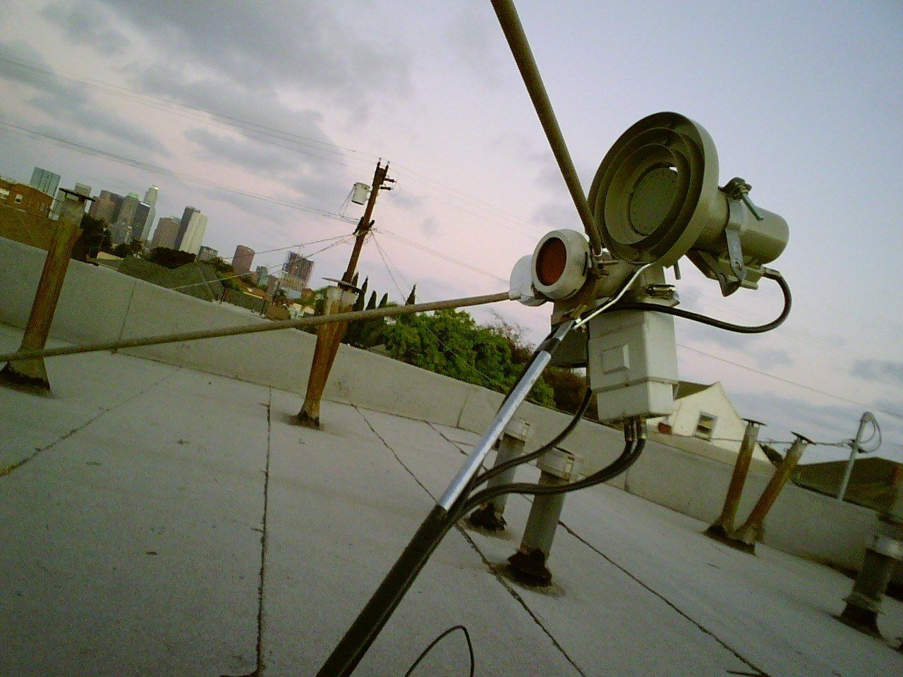

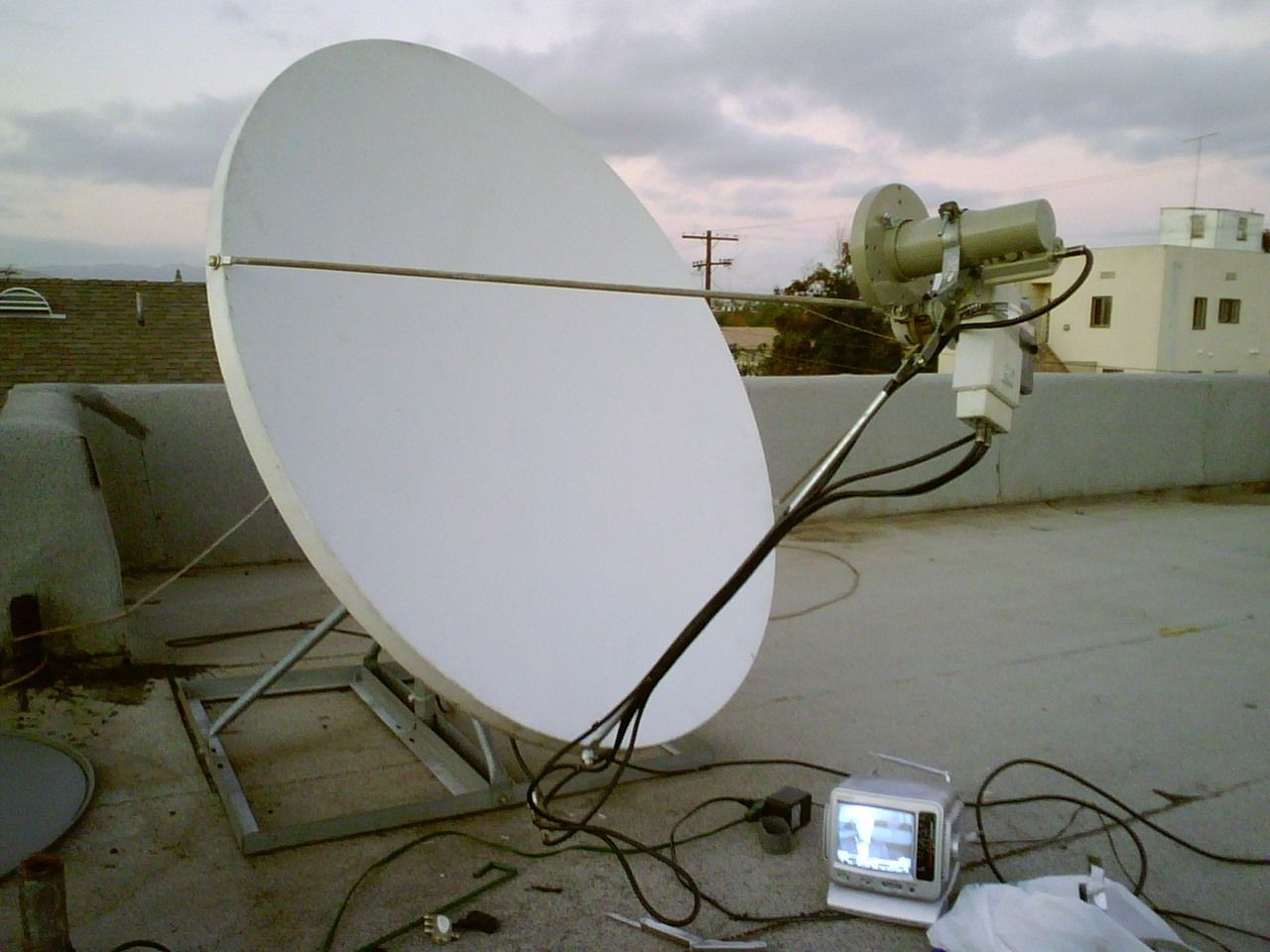

Finally installed the Prodelin 1130 series 1.2 m dish and I am very happy with its performance.:D
Very strong reception of C band & Ku.
Also motorized with my existing SG 2100 H to H motor.
Heres the pics

Yea, but this 1.2m dish takes you to the next level.
With it, you really deserve your own thread. - :up
This is no longer the 1m or 84e which others have tried.
Several guys around here have their own 1.2's, and they perform.
A 1.2 is in a class by itself. ;)
I'd be interested in hearing what you can get on it.
And even more interesting, where in LA did you run across such a nice commercial dish?
I may have to go a-hunting. :cool:
edit: I have seen what looked like a 1m dish on a service station, but 1.2's are rare.
