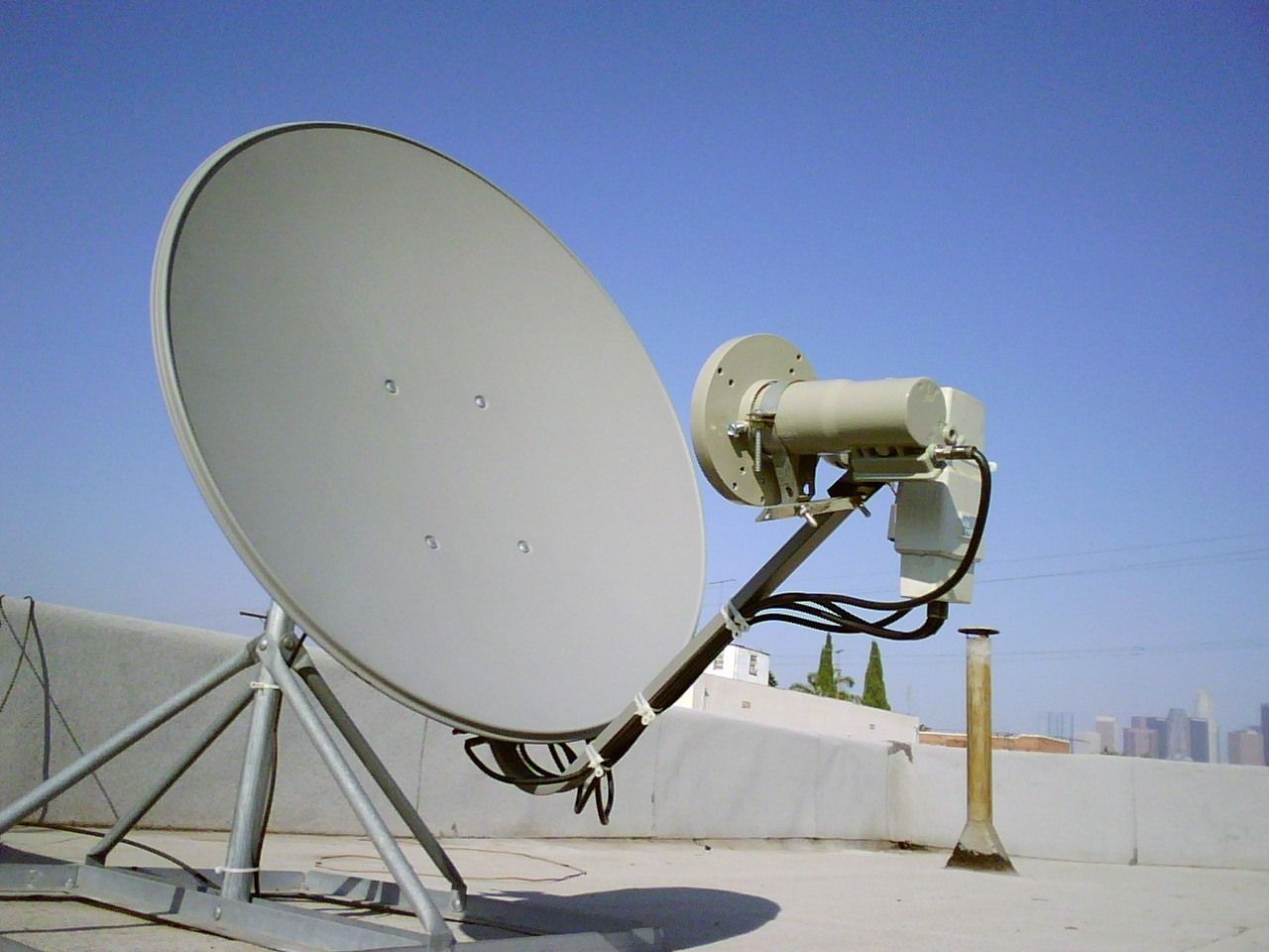

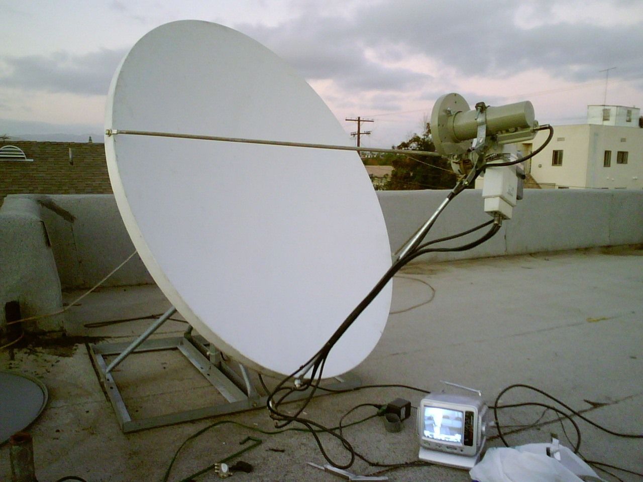

Looks like I am going to reinstall my earlier dish.
The Prodelin fiberglass dish is weaker in the ku department.
Going to make the Prodelin 1130 dish a C band only dish.:)
