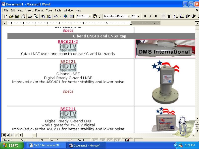

Improved BSC421

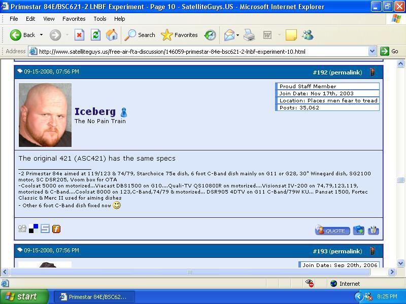

Correction please-

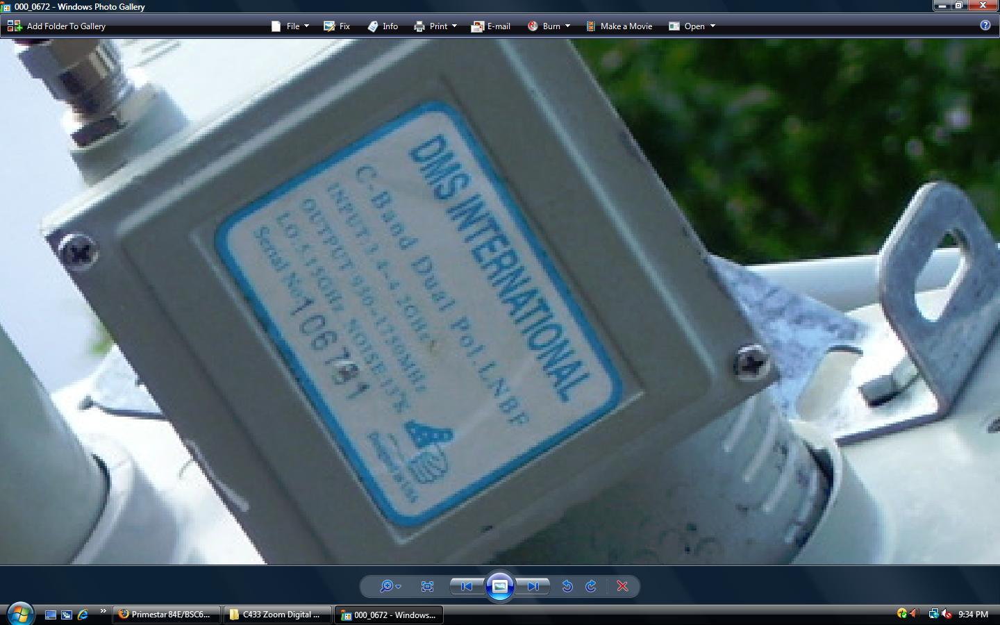

what is there to correct? The ASC421 I have shows 13K on the label.
Just because something says "better" doesn't really mean it is ;)
I've used 35K LNB's (the old ones) that worked better than a 17K
That is your experience.
DREAMFOX1 found an 8% improvement.
Are you saying DMSI is advertising false hoods?
They clearly state that this improved over the older LNBF.
I'll take their word for it.
