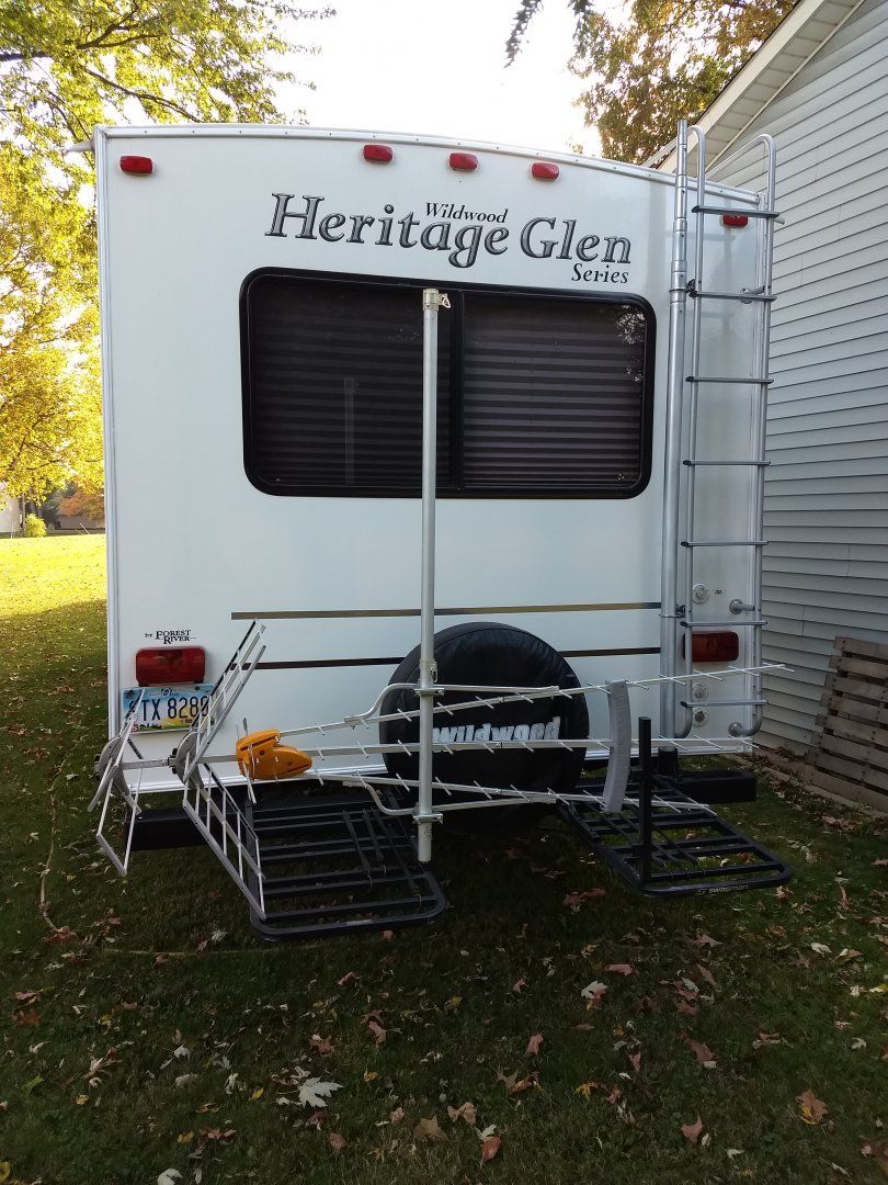

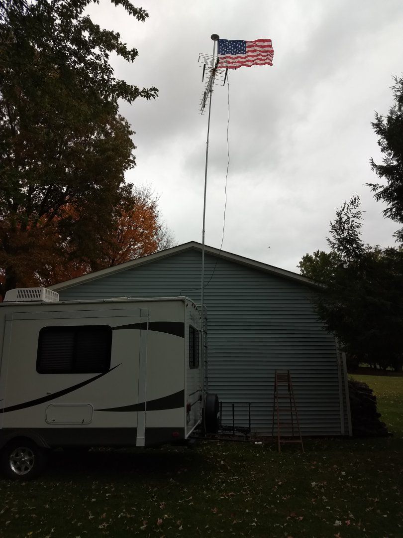

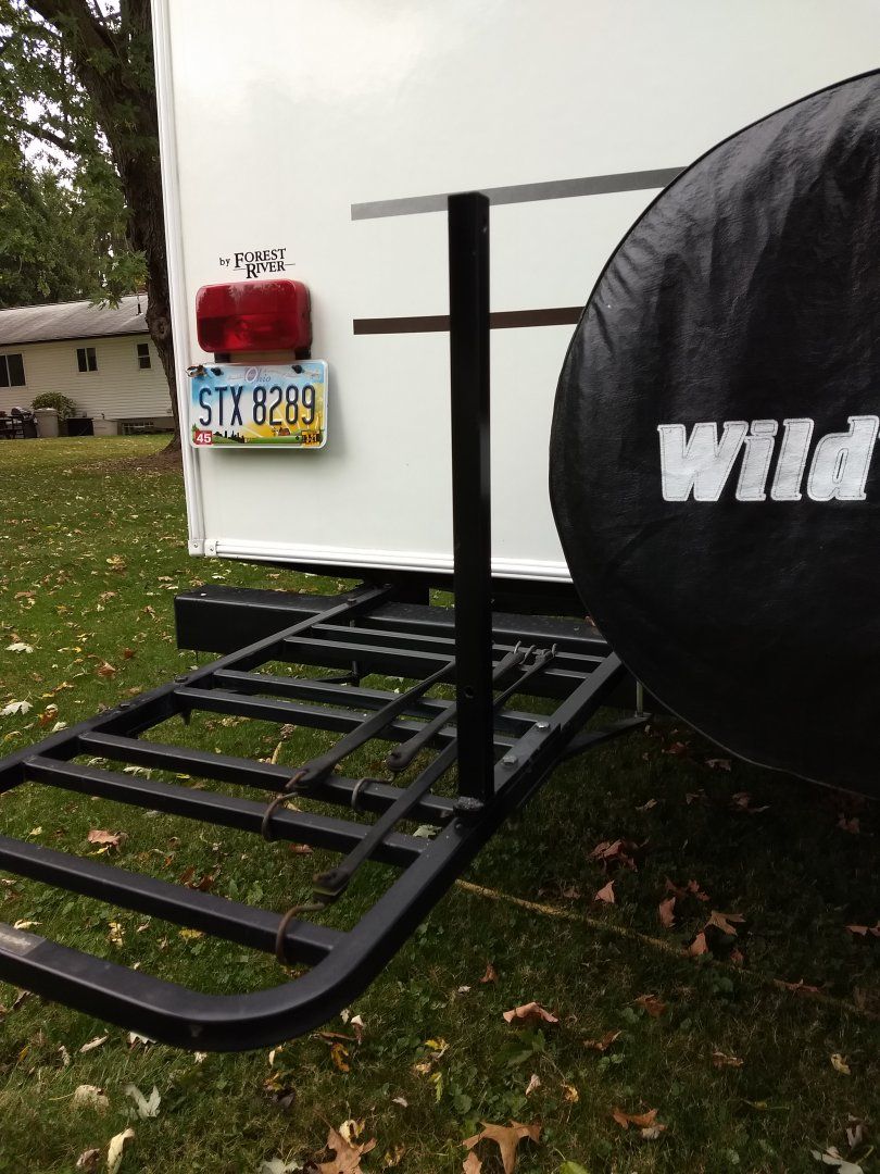

Got everything done today and working great.. Cloudy and around 20mph wind at 2pm..I'm about 25 miles from transmitter in columbus ohio and even managed to pull in a vhf high station at 80 signal..With the mast extended full it's about 36' and has some bend with the wind..lol..pulled a station 45 miles to east in zanesville ohio..There's a bicycle rack mounted on the back that works great for holding the antenna in transit.. heading to camp sunday so I'll see if I can pull in anything...

Be sure to pull that thing down if the wind gets up.
Anything much more than 10 ft unguyed is in danger of collapse in a wind gust.
Lots of wind load from the flag plus antenna.
