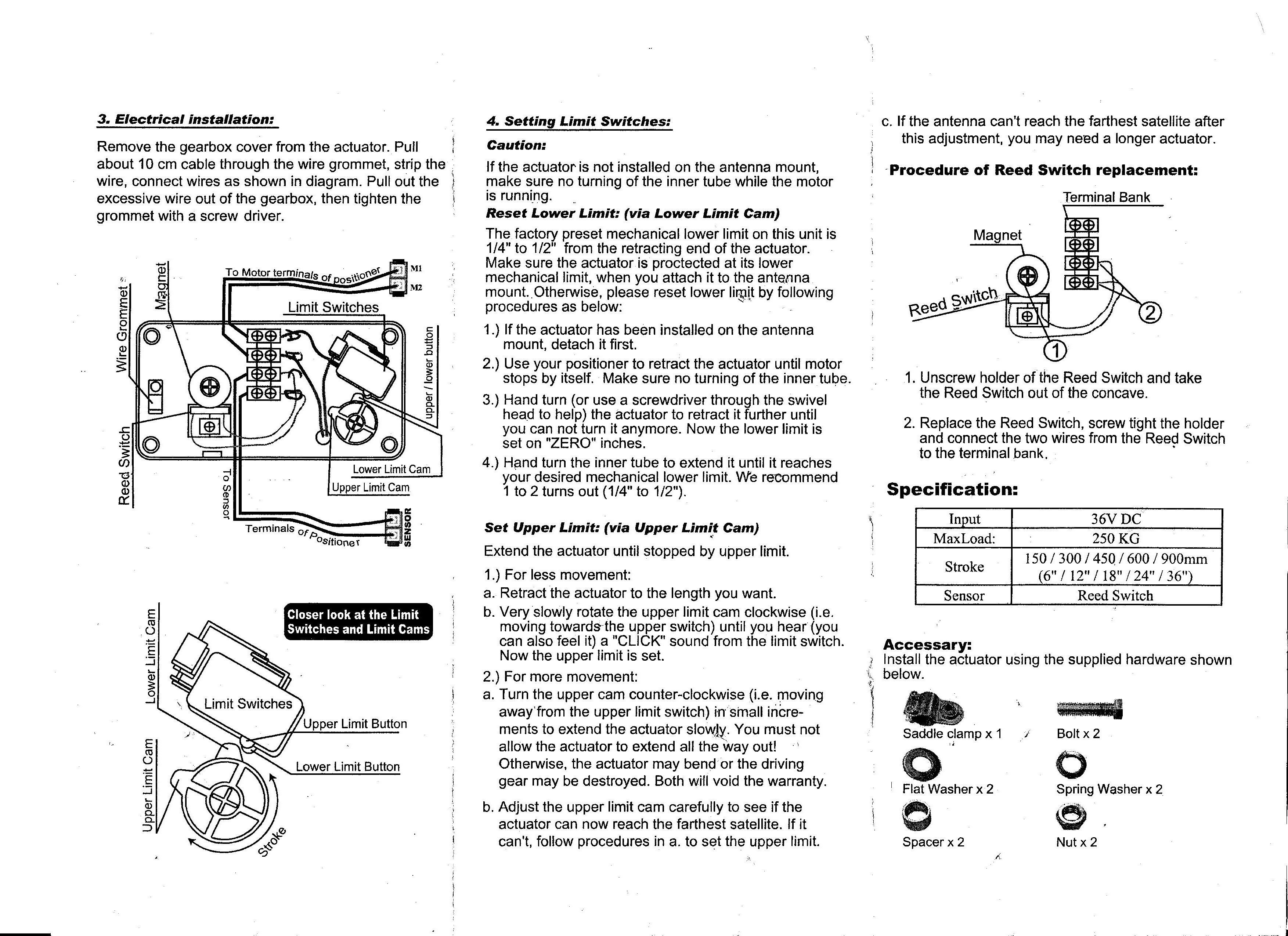

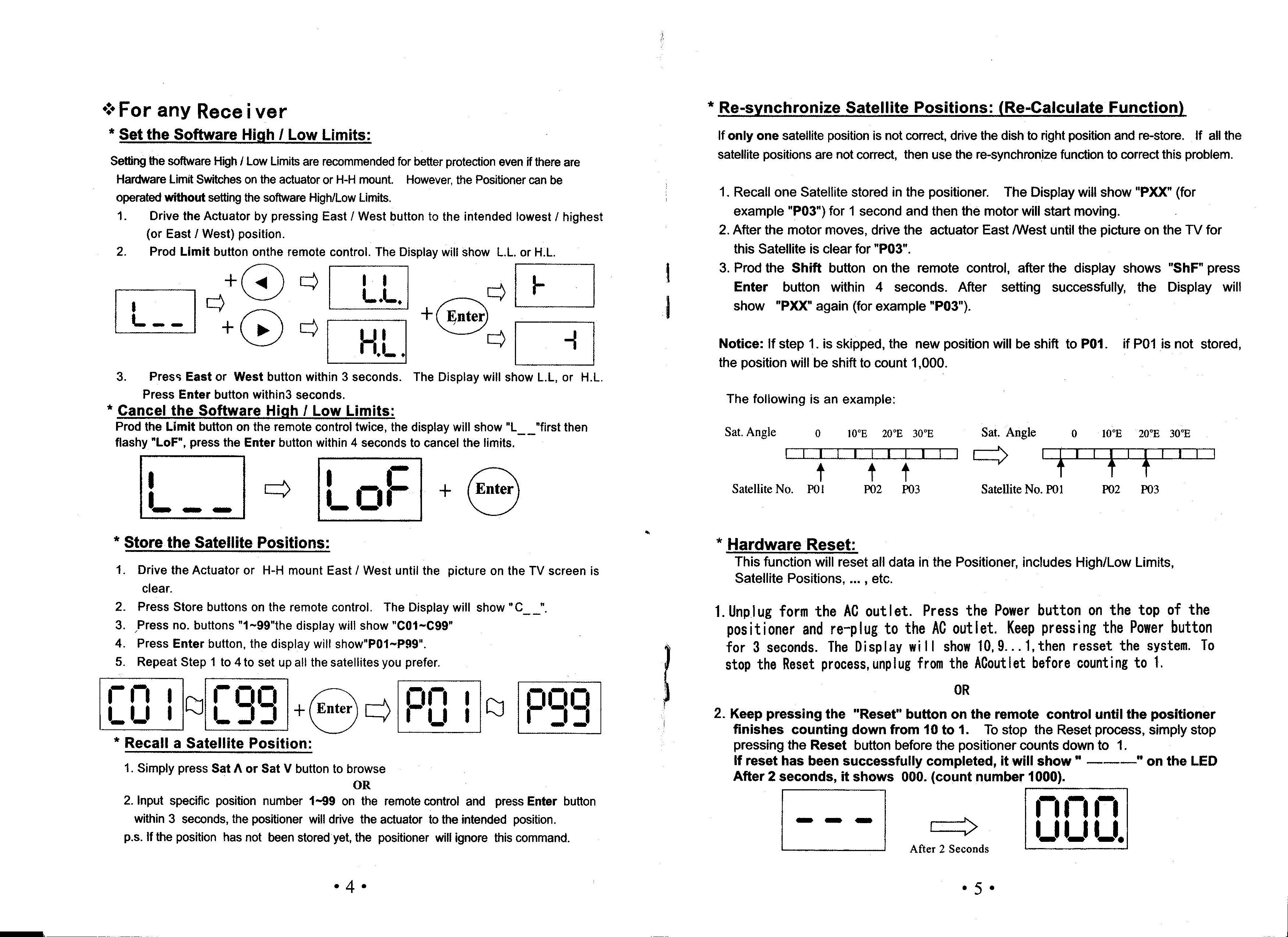

Here is some extra info i hope may work for you.Your problem is coming from one of these items! The V box,receiver or the actuator!Time to narrow it down.If your moving your dish by using the receiver via the v-box!disconnect receiver and just use the v box remote to move the dish!If the problem is still there then i would say that the receiver is not the problem.I have not tried a car battery to troubleshoot but that sounds like a good idea to see what is bad! the actuator or the v-box.Try reseting the limits on the v box first!if that wont work then reset the actuator limits!I have included instructions on how to do this.The reed switch in the actuator may be sticking and causing the problem also.Reed switch's are alot cheaper to replace than getting a new actuator,so you may try replacing the reed switch first if all fails.PS remember to make sure all wire connections are good first.Hope this helps! Stan
