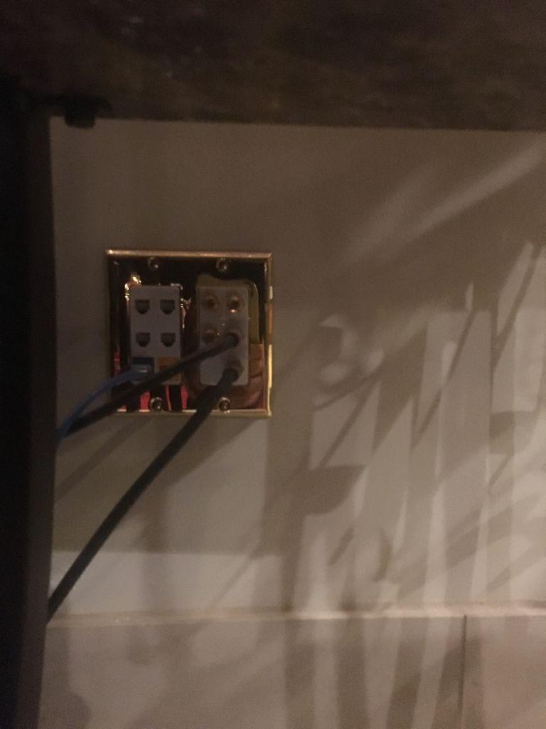

time to dump those non 3 gig barrel connectors
Seriously they did not have 3 Gig barrels in a Levitron insert when I built the house.
I actually bought barrels to switch them all out, but they used a drop of glue to install them, so I was like screw it and just went with the non 3ghz barrels.
I had a hard enough time finding the rest of the parts and the brass wall plates to match the rest of the house
