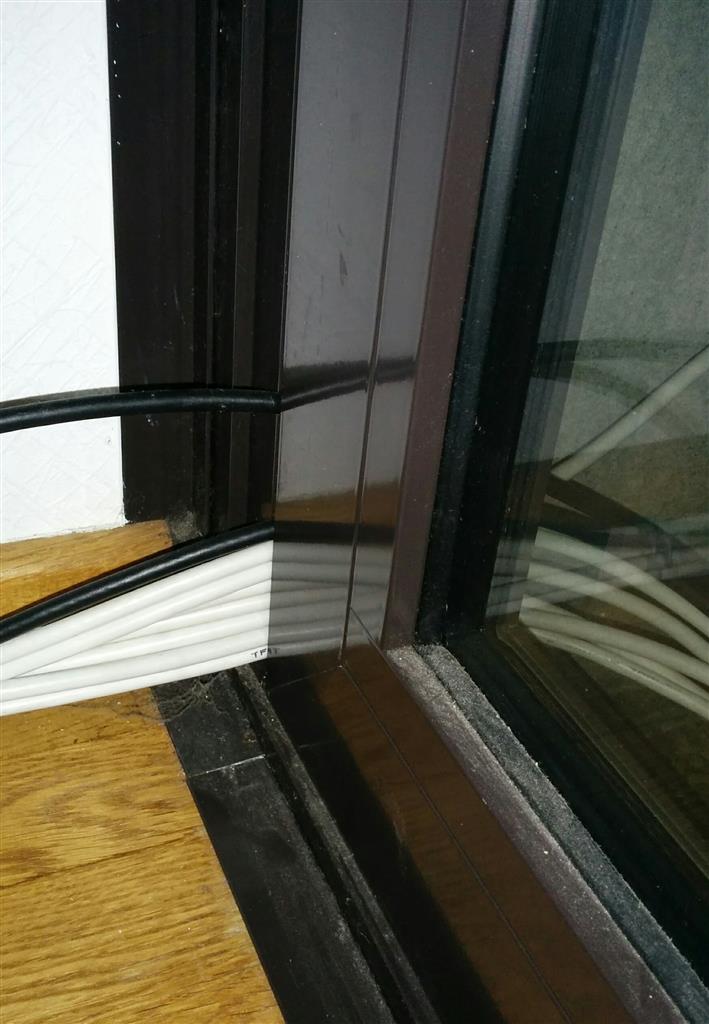

For the new house it is better to have as many cables installed as possible. I just took a picture of cable run to my balcony, because of them I can not fully shut the door. Apartment is not mine, so can not make holes in the wall. :coco IMG_20151228_000022 (Custom).jpg

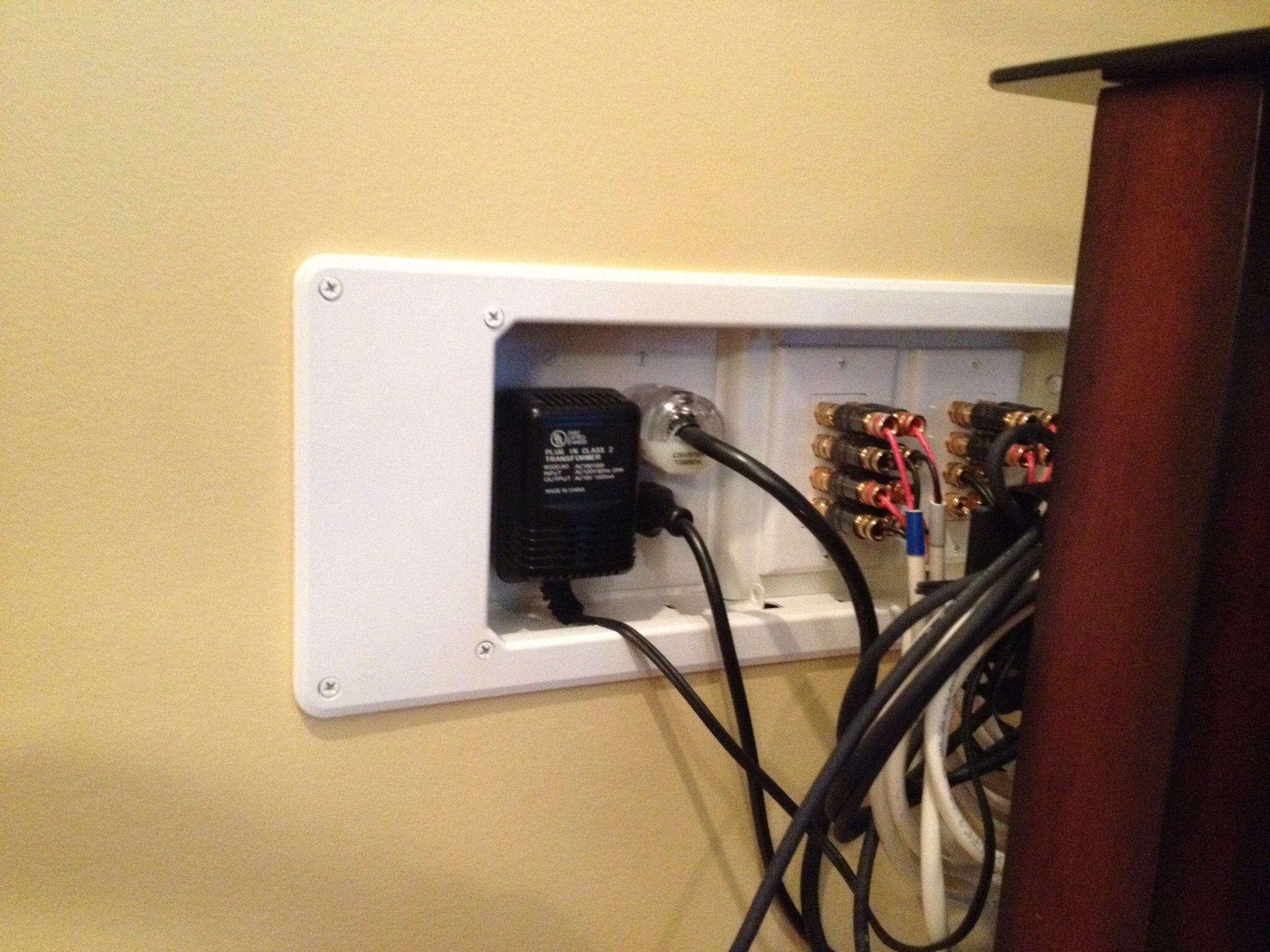

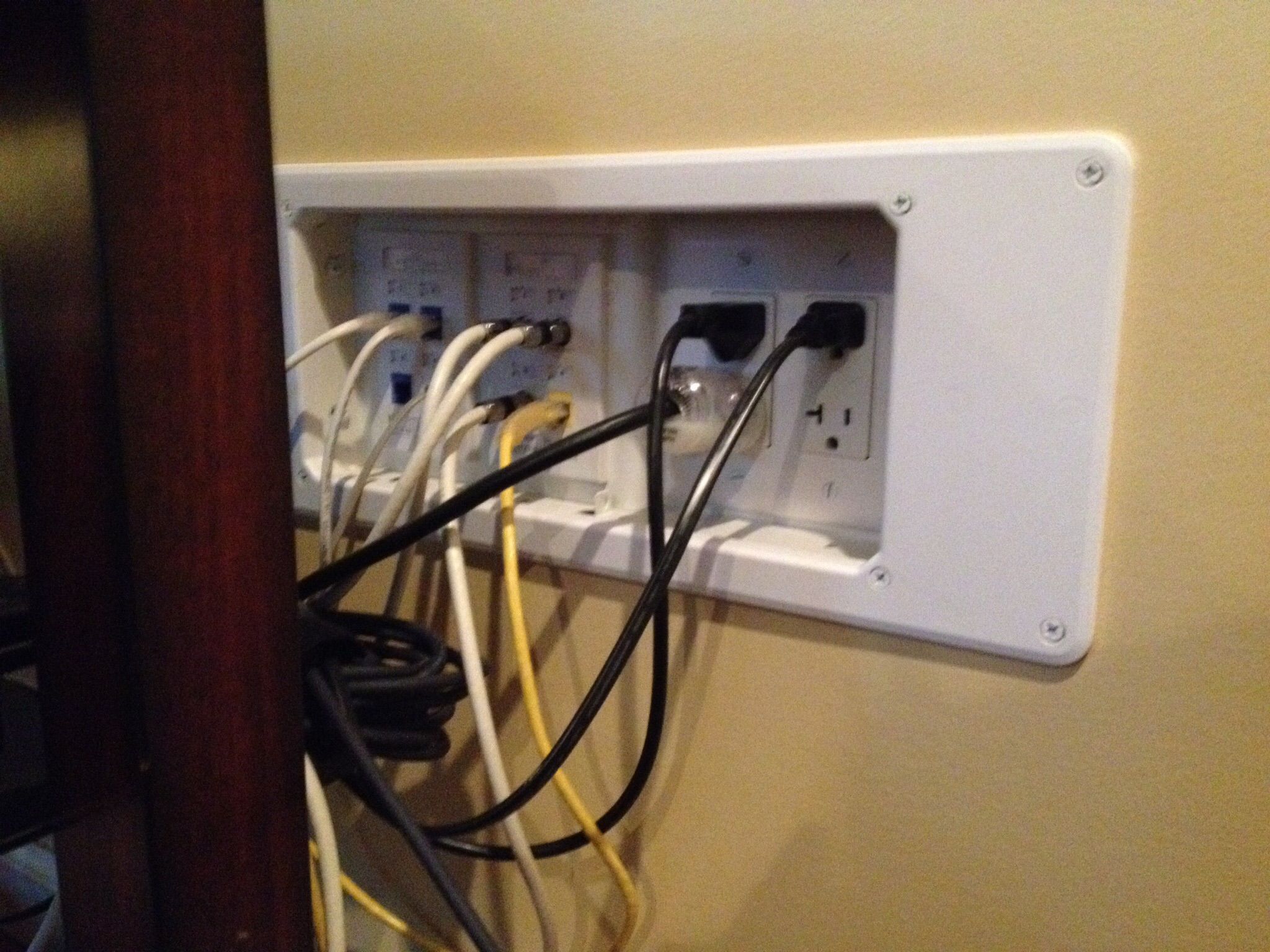

My new room is 2 X 6 construction. 15 X 21. Very good for insulation and a lot of room for my 4 in wall surround speakers and the cabling behind my AV stuff.
The AC wiring is kept far from the cat, phone, speaker and RG-6 cabling. Three 20a circuits. AV stuff on one and the two subwoofers are also on there own circuit along with other room receptacles and lighting.
6 - cat5e
3 - phone
3 - RG-6
16 - speaker bananas
And a lot of AC receptacles.
