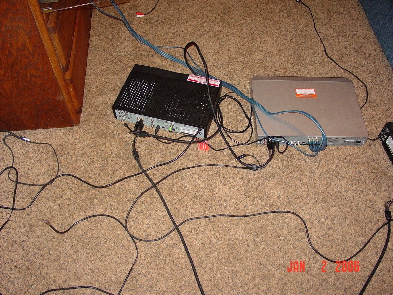

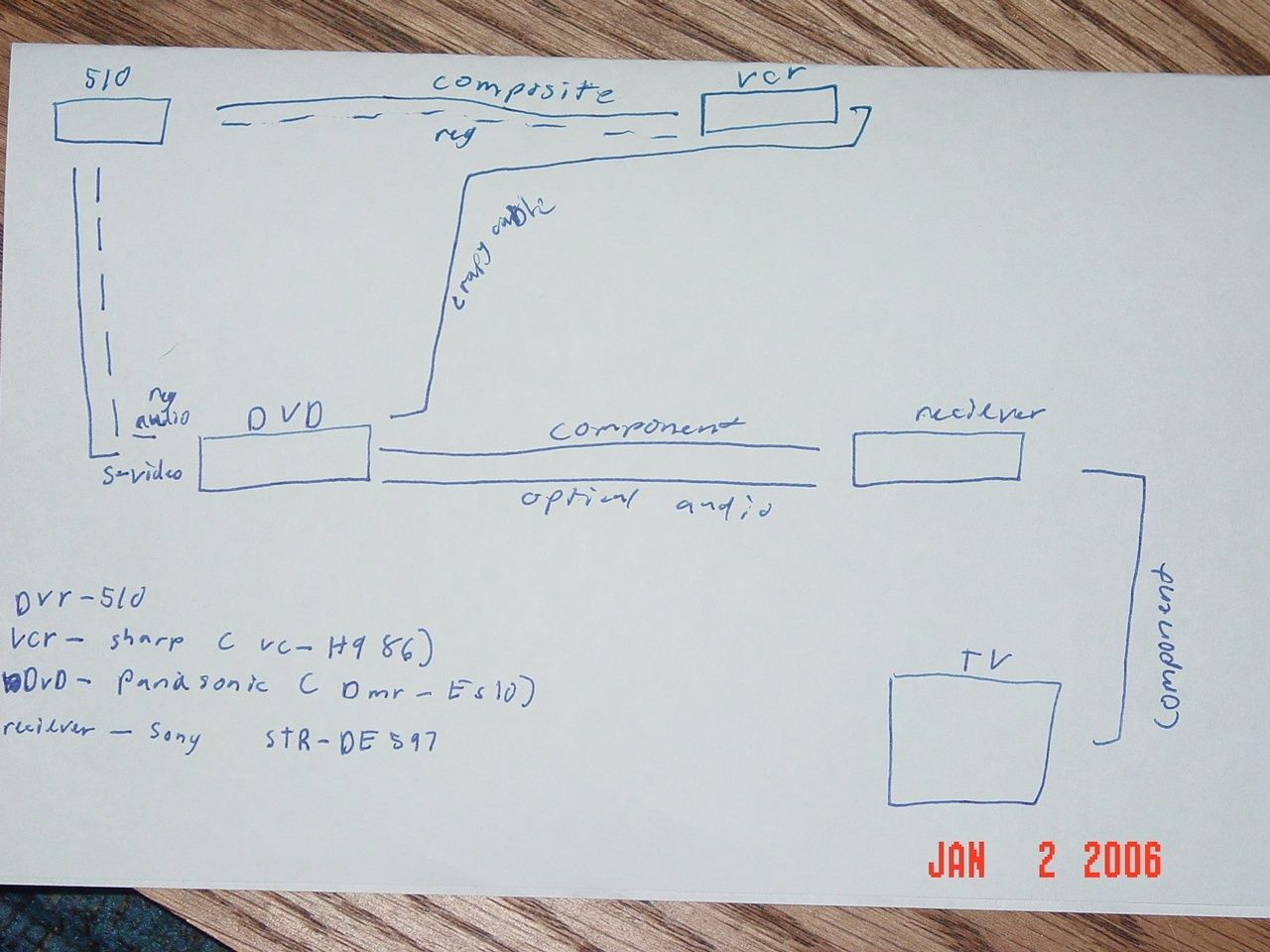

OK as the title says I'm having really bad pixelation problems again. I know its in the way my TV is setup. Heres my setup now... dvr510 to dvd recorder that up converts the video into component (not composite) then into surround sound to TV. Heres my question do u think upgrading to a HD DVR say the 942 would be a good way of getting rid of the pixelation. That way the video is already in component so it doesn't have to up convert. But there are some ketches one I don't have a HDTV yet (yea i know) and also the $250 price tag is a little hard to swallow as well. any ideas on how to fix this?
Stop passing it through so many sources would probably be the best way to fix it. I very much doubt that the DVD recorder is doing any upconverting (or doing a good job at it if you're seeing pixelization) from the DVR. It's likely just passing the signal through and not changing it at all. I'd just run the S-Video from the DVR into the receiver and have the video output from the the receiver's video out going to the DVD recorder. This is of course how I would do it since my receiver (Harman Kardon AVR-230) would allow it since it has a video output for each video input along with a complete set of monitor outputs.
Basic wiring plan (not knowing all components & what they are capable of just guessing here):
DVR to Video Input 1 via S-Video
DVD Recorder to Video Input 2 via component
Video Output 1 to DVD Recorder input via S-Video (I doubt you have component in)
Component Monitor out to TV this is presuming that you have a receiver that will convert from S-video to Component (not all receivers can)
If receiver can't convert S-Video to component then:
Component Monitor out to TV & S-Video monitor out to TV.

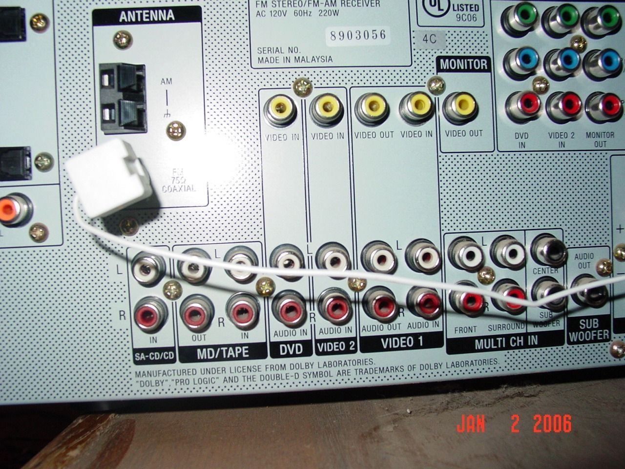

That would be my mine problem my receiver cant.

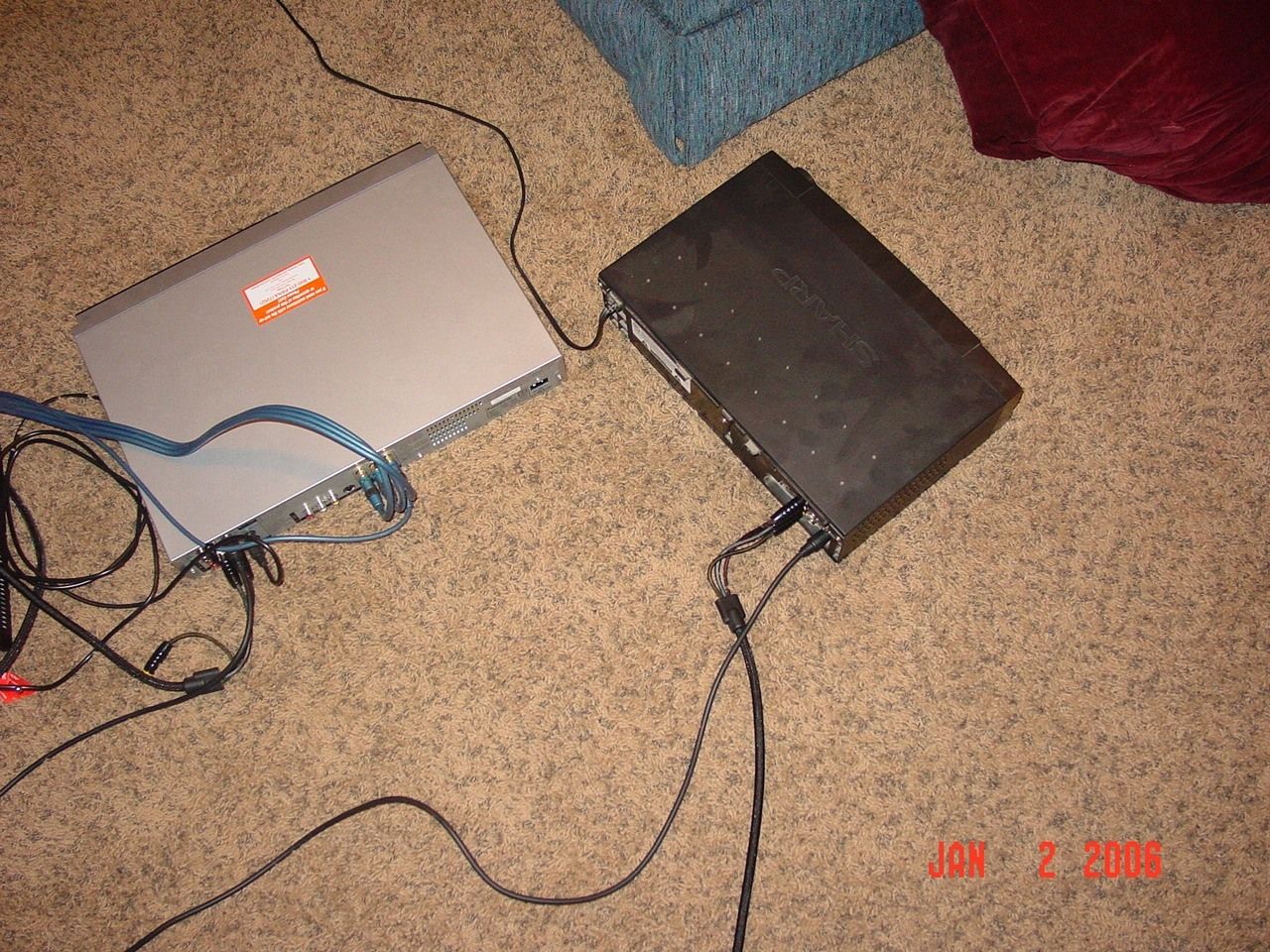

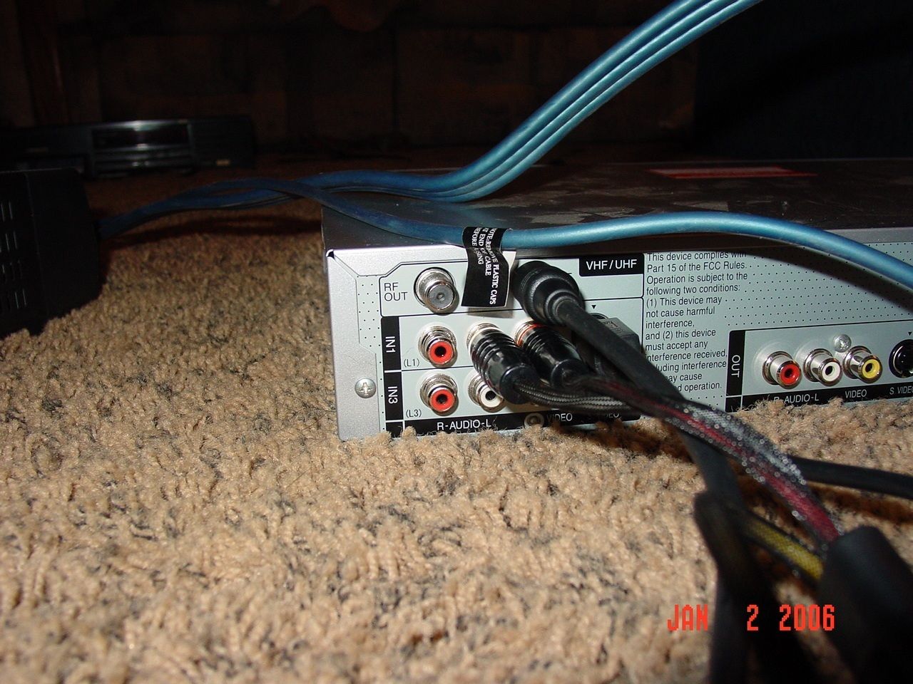

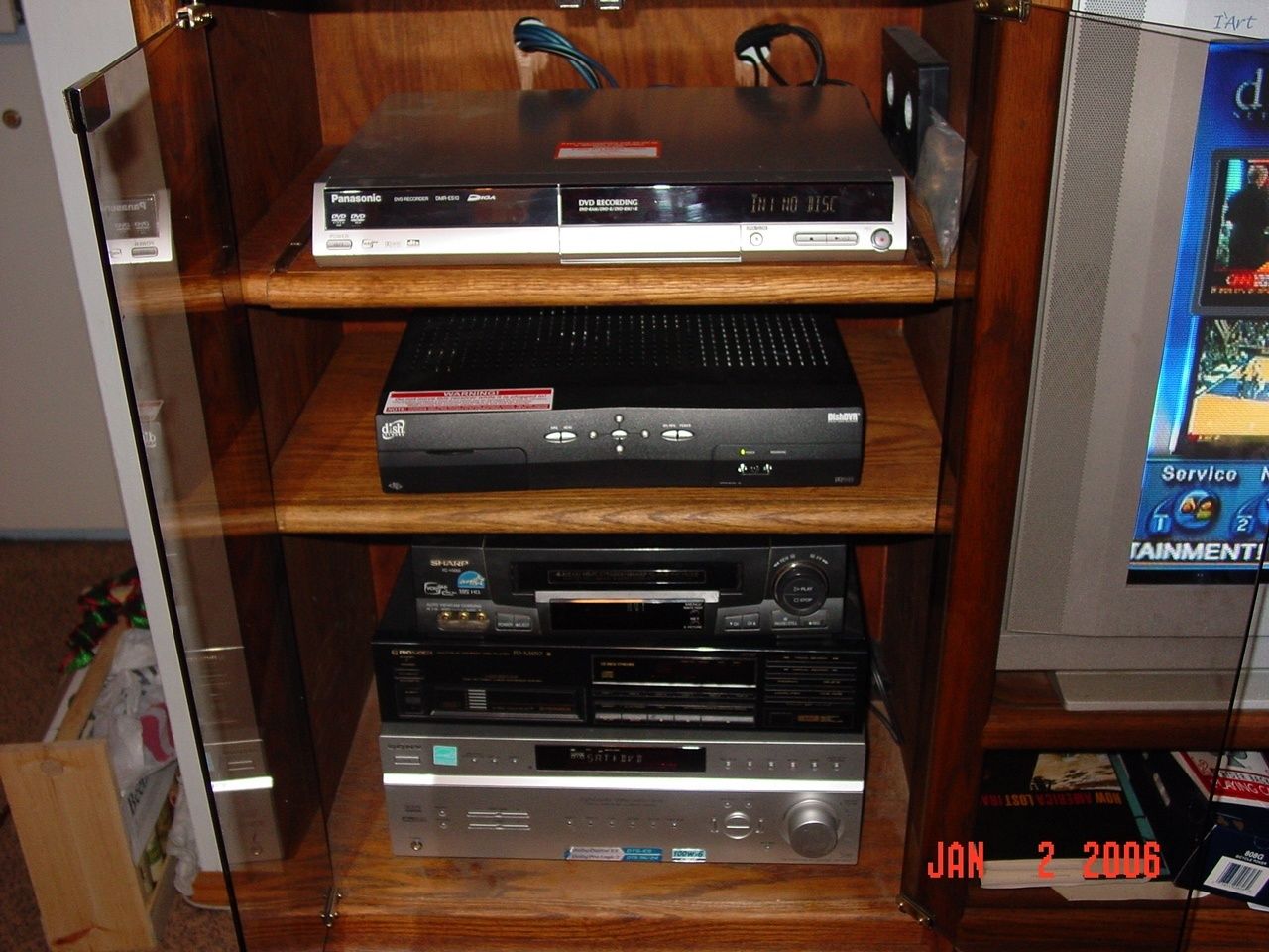

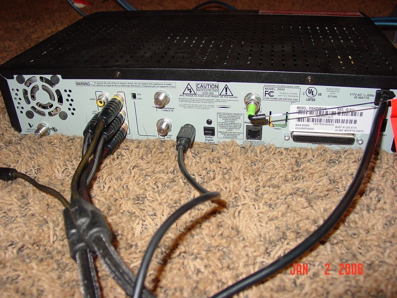

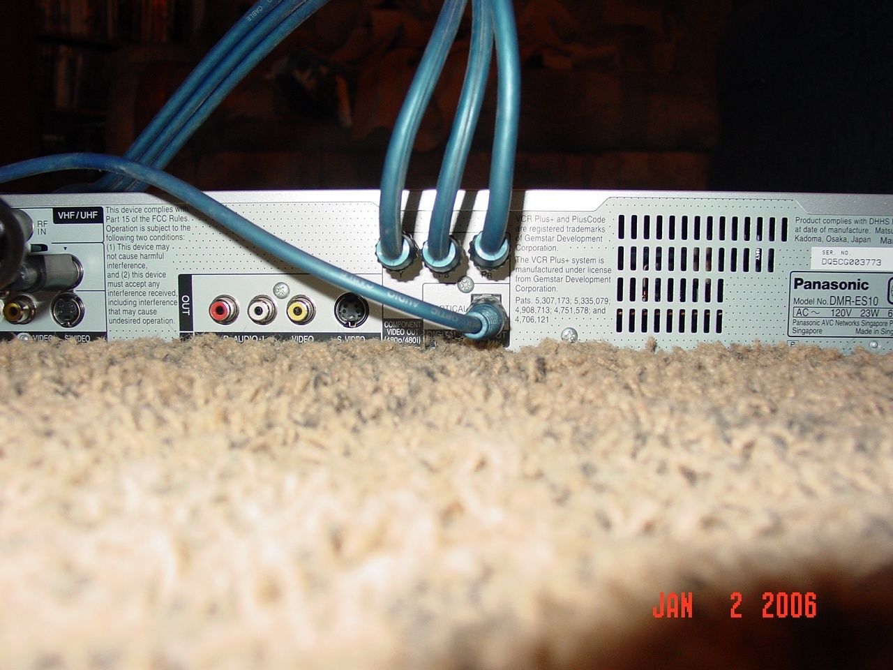

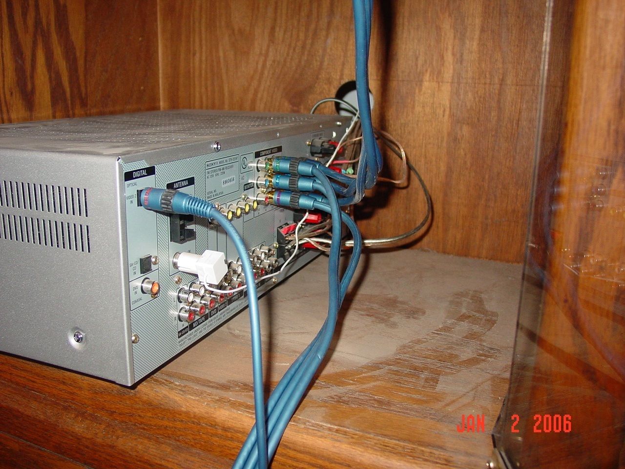

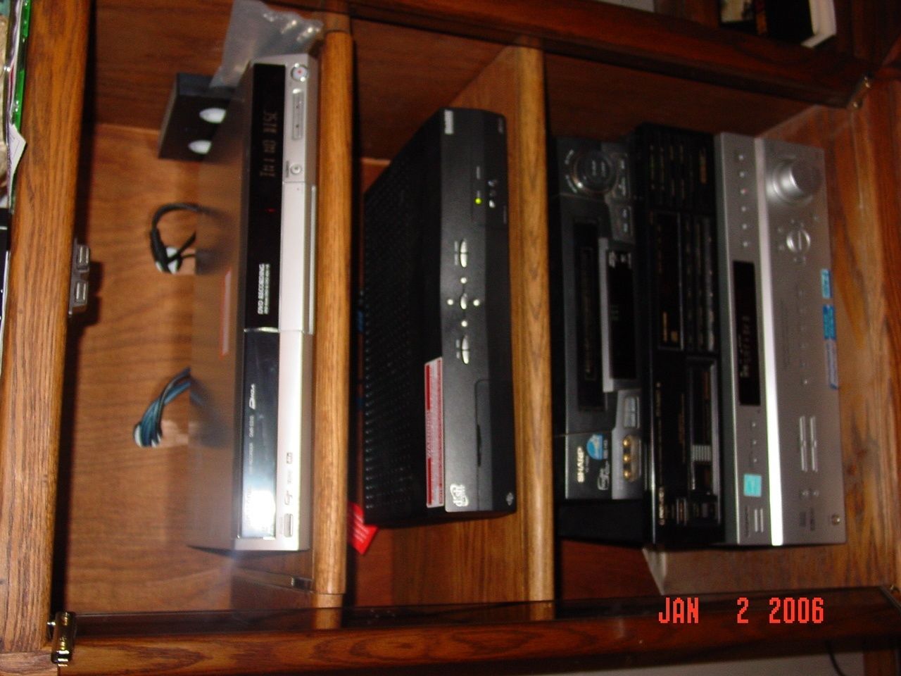

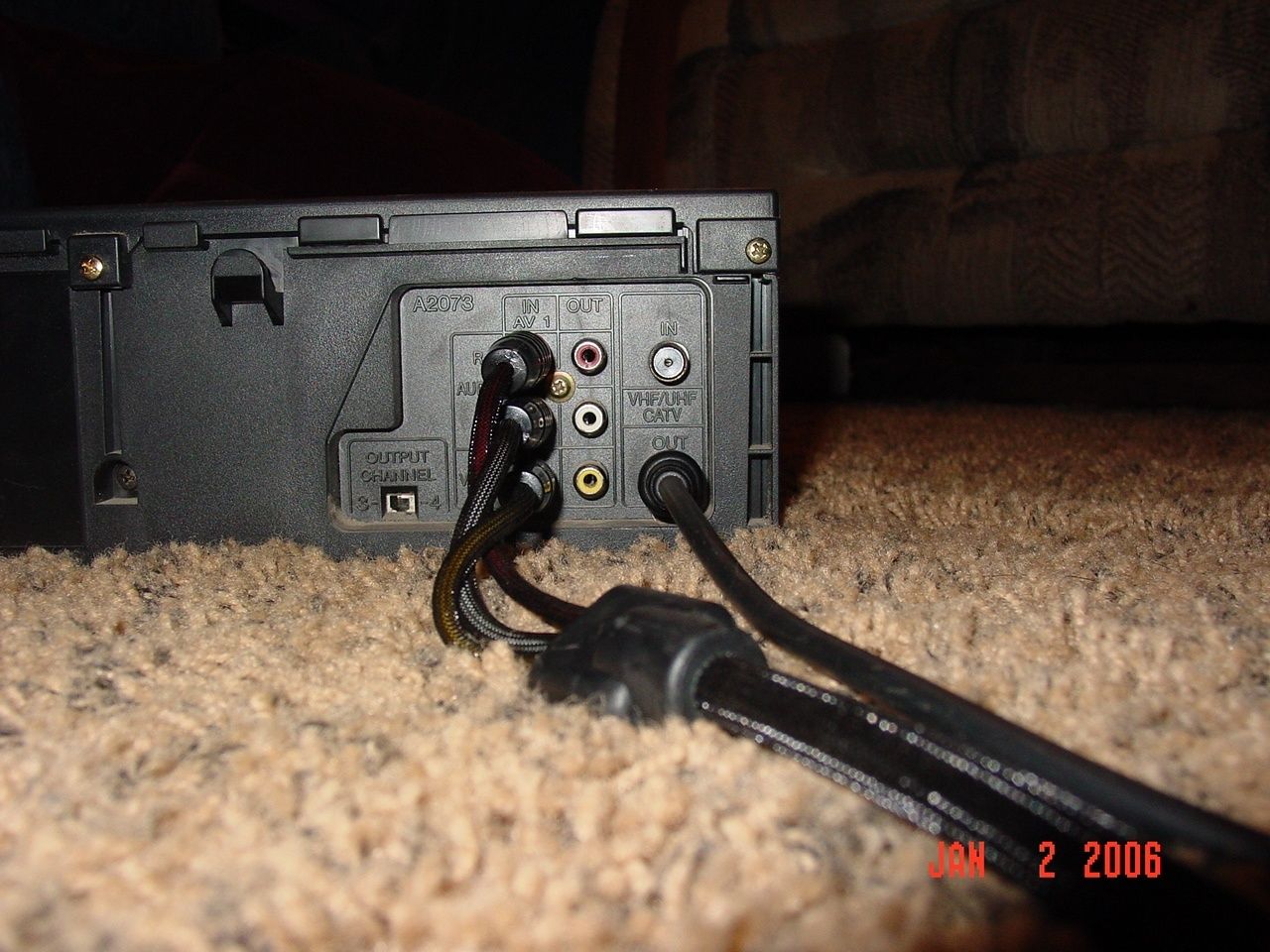

I have taken everything apart and rebuilt it outside the cabinet. Here are all of the pics and model numbers for everything I'm using. WITH THE PIC OF THE DVD JUST PRETEND I DIDN'T MESS-UP THE CABLES.
SAT: DVR-510
VCR: SHARP (VC-HP86) dont use much just there to copy school stuff
DVD: Panisonic (DMR-ES10)
RECIEVER: Sony (STR-DE597)
TV: JVC I'ART
So if you have any new ideas or any info that can help please HELP ME :river

WTH, you have no S-Video inputs but you do have component inputs? That's pretty messed up. Best I can think of doing is this then:
Run digital out from DVR to receiver
Run S-Video from DVR to DVD Recorder
Run S-Video from DVD recorder to monitor
Run digital out from DVD recorder to receiver
Run component out from DVD recorder to receiver
Use S-Video for watching programming on DVR and component for DVD recorder playback
Or you could go with option 2:
Run S-Video from DVR to monitor
Run composite out from DVR to receiver
Run Video Out 1 from receiver to DVD Recorder
Run Component out from DVD recorder to receiver
Run Digital out from DVD recorder to receiver
Run Component & Composite monitor out from receiver to monitor
Option 1 will have a lot of source switching involved but option 2 won't the only thing is you may lose a bit of recording quality although I doubt a lot but I could be incorrect. Frankly I would dump the receiver that you have as it seems pretty lacking to me. Man I'm glad I dumped my Sony, looking up the specs for yours just reminded me how lacking their receivers are unless you go with their overpriced ES lineup. Still have to sell the darn thing though, anybody want an STR-G3 with the infamous egg remote?

I don't understand why you are running the component cables into the receiver's component 2-way switch when you aren't even using it. Run the component cables straight out of the DVD-R to the TV.
There is no point in coverting dish sd to component, the video itself is interlaced from the source. Are you happy with the quality when you connect the 510 directly to the tv?
Does your tv support progressive scan? Maybe you are converting to progressive only to have the tv convert it back to interlaced. (I've never had an sd tv with compenent so I'm not sure how they work)
