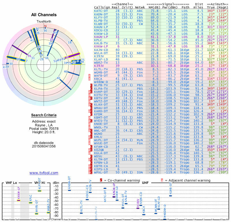

I would like to know where I can buy an antenna to where I can get low power stations 75 miles away and UHF frequency channels and also would include the channels on the vhf from 105 miles out. Also about ones you can catch 150 to 200 miles away
Post up your TV Fool report like Fat Air suggested and what channels from the report that you want to get and then everyone can answer much better as to what antenna to use, or if it's even feasible. 75 miles for LP stations, 150 for VHF and 150 to 200 miles for others, those are some long, long distances for antennas. A lot will depend on the terrain in your area.
When you do your TV Fool report, use your EXACT address and antenna height, not just your zip, with distances that far it can make a huge difference!
Good Luck! Check out tvfool.com to see what's what in your area. Maybe post your report here for comment.
KATC, KLFY, KXKW, KLWB, TV6, KLPB, KAGN are in the green. KPLC and KALB are between the green and yellow. WVLA, KAJN, K39JV, KLAF are in the yellow and can get them except the 46 as of Tuesday. The ones in the red are pretty much the baton rouge conglomerate outside the Nexstar Statuonsions except for 1. WAFB, WBRZ, WGMB are in the red amd can get them good except for WAFB. What i may need is an new stronger reach antenna and those gold 5 foot rca antenna masts raise it to 25 I'll be good.

What are you using for a antenna now, any pre-amp? Looks like the further out channels you're interested in getting better are between 83 and 107 degrees, maybe a rotor to point more precisely at each station would help, if you don't already have one?
None of these are 75 or more miles away? If you want to get any of the channels in grey, those that are labeled Tropo would be very hard, if at all possible, to receive, I'd think it unlikely that you'd get those. You could try running the report at different antenna heights and see if it improves, if any of those channels change from Tropo at a higher hieght, then maybe you might get them at that new height. All the others besides the Tropo ones in the report you'd have a good chance of getting but you would probably need a rotor cause they're not all in the same direction.
I have an rca from walmart paid 65 for. It said on the box good for 40 miles but i can get wbrz and wvla and kalb good. My former residence which was right in Lafayette parish I could get 27 channels always. No i have no rotor or preamp. I have it pointed between 83° and 107° and I did see one with the 4 bowties 4 circular devices and another one which is a little longer than mine on the internet.

Yes 4 out those 5 or 6 i can definitely use. I bet with one of those I could get a new orleans one all the time.
