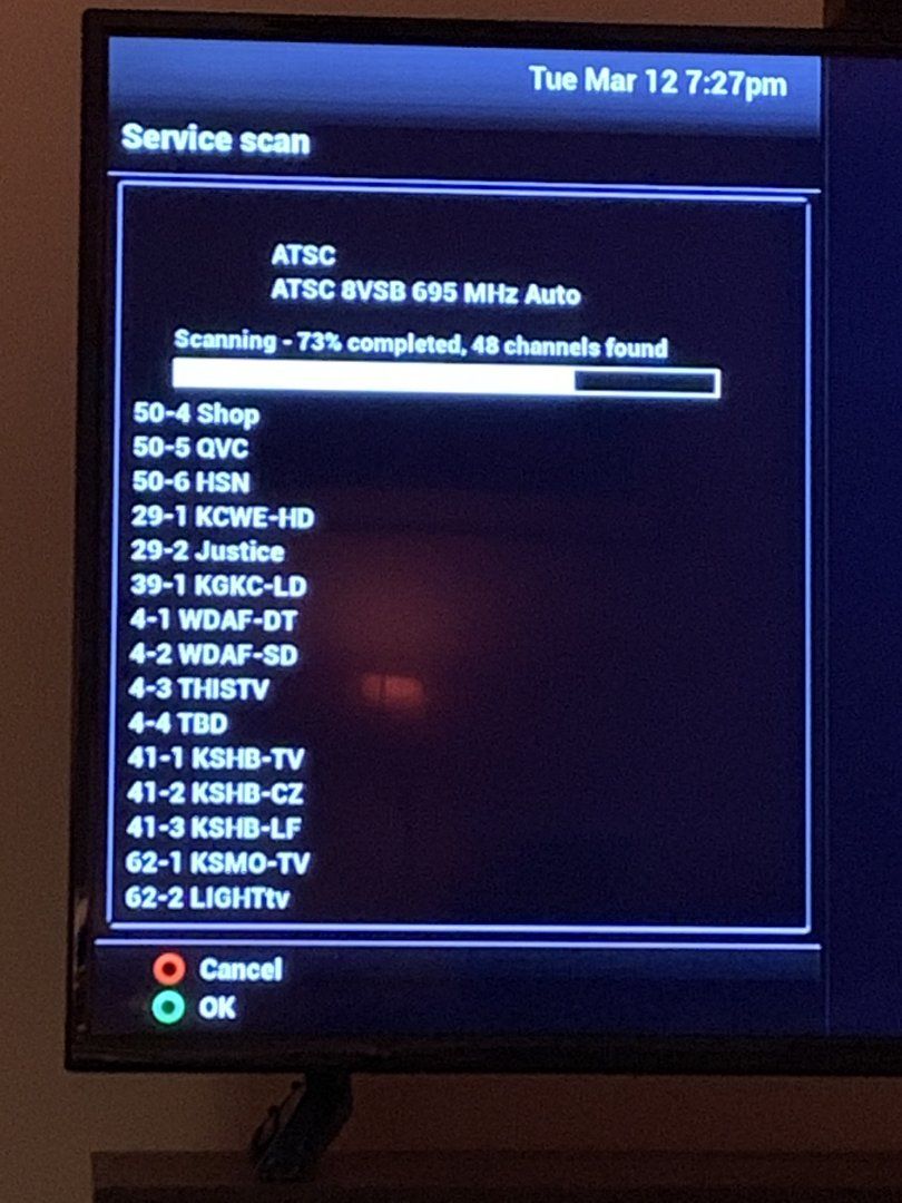

Received the Hauppauge 950q OTA dongle today. Installed drivers as indicated. Did auto scan. Tuner lights are on, but no channels are found.
Currently running the OpenVIX image.
Nevermind, switched to OpenPLi and it works great. Must be a VIX image issue :)

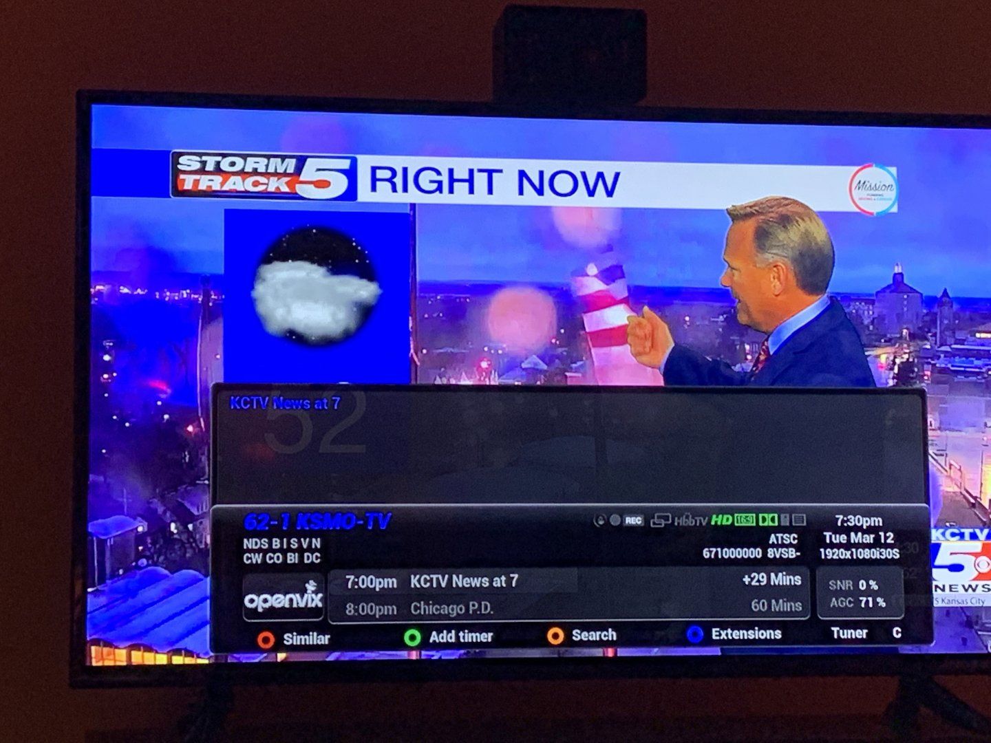

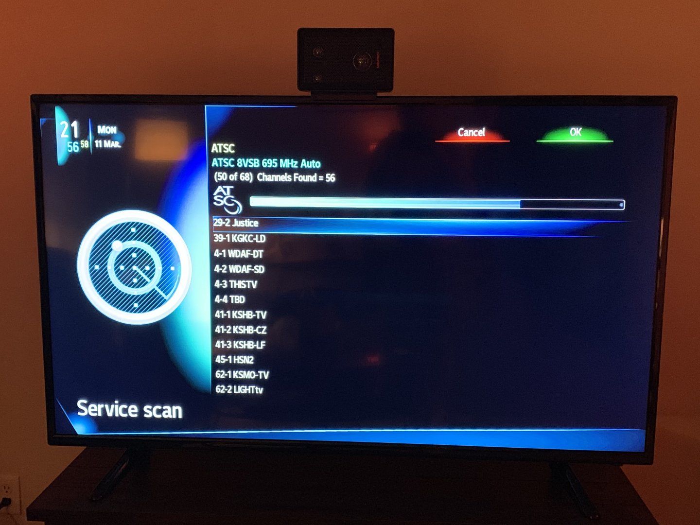

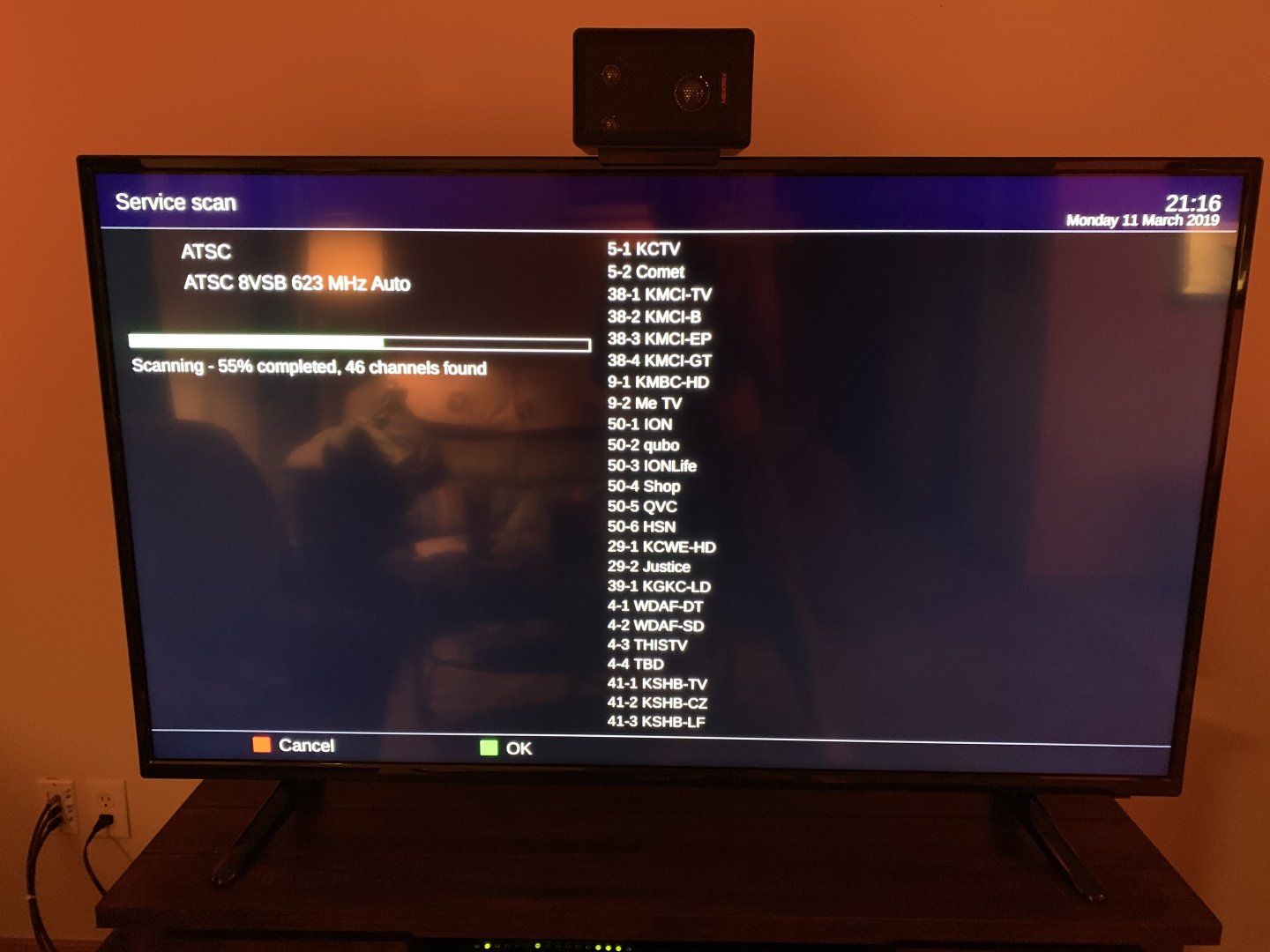

NA image found all available OTA channels in my area (56 total)

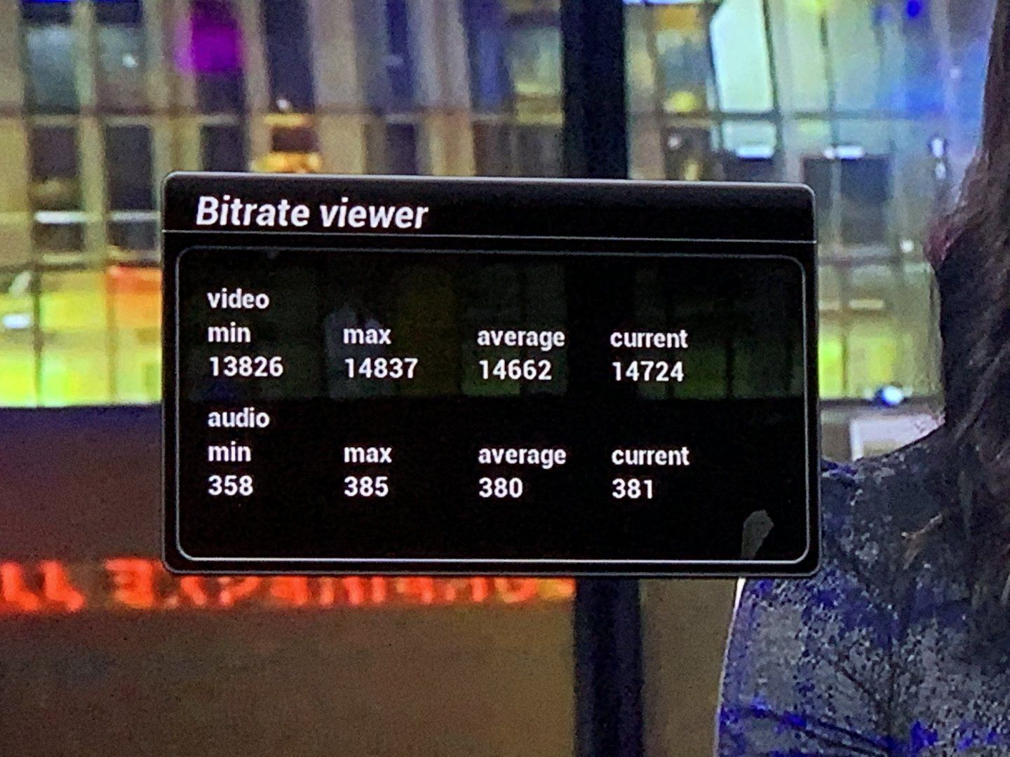

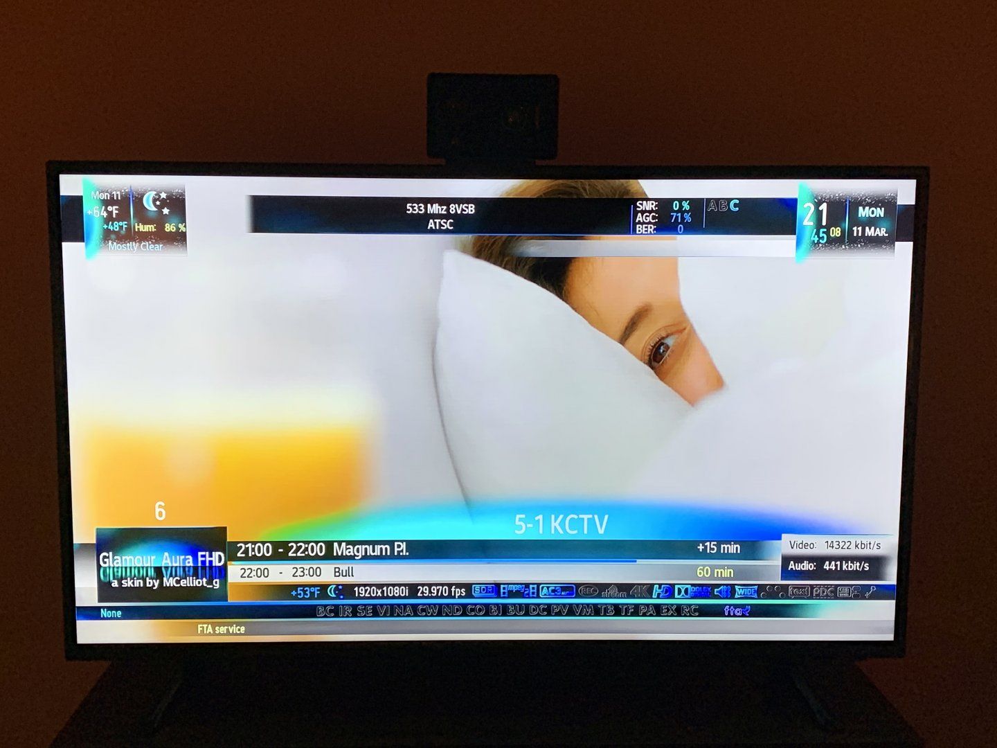

And yes, KCTV and KCMO are obsessive about their bitrates, and they limit their subchannels. Very nice PQ :)

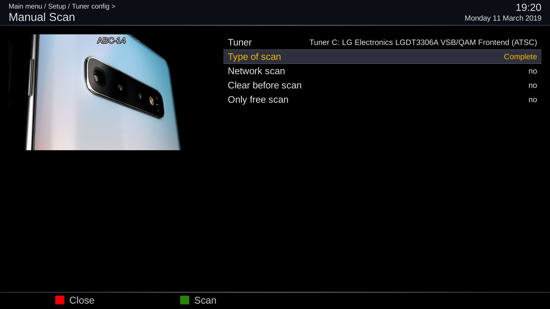

I do Manual scan on my boxes.

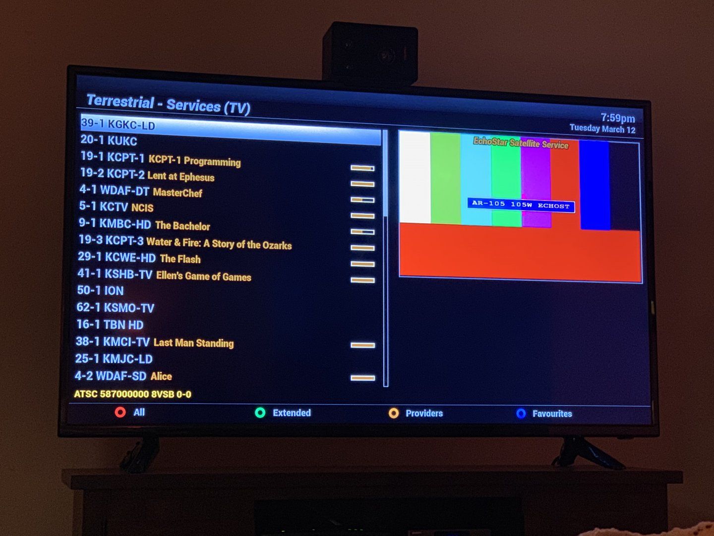

Using openvix. Menu/setup/tuner config/Miscellaneous
Turn off "no" all 3 ignore DVB-S,DVB-C and DVB-T namespace subnetwork.Then green button to save and exit out back to tv.
Open channel selection list and press green button "Satellites" Delete or remove the Terrestrial Services with menu button.
Rescan the ATSC channels again with Manual scan,scan type complete.
After scan go to Terrestrial-Services they will still show no rhyme or reason. Now reboot the mio4k and go back to Terrestial services and if they are in order go back and Turn on"yes" all 3 ignore dvb-s,c and t.
They should stay in order after that.
