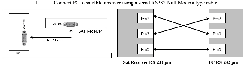

Where can I find instructions on how to do that. I have a cable somewhere around here from my Fortec Star is that the sort of cable I need?
You'll need a null modem cable and the AliEditor for the Openbox S9. I use this cable on the S10 and my DSR-R100B.
