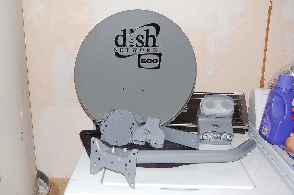

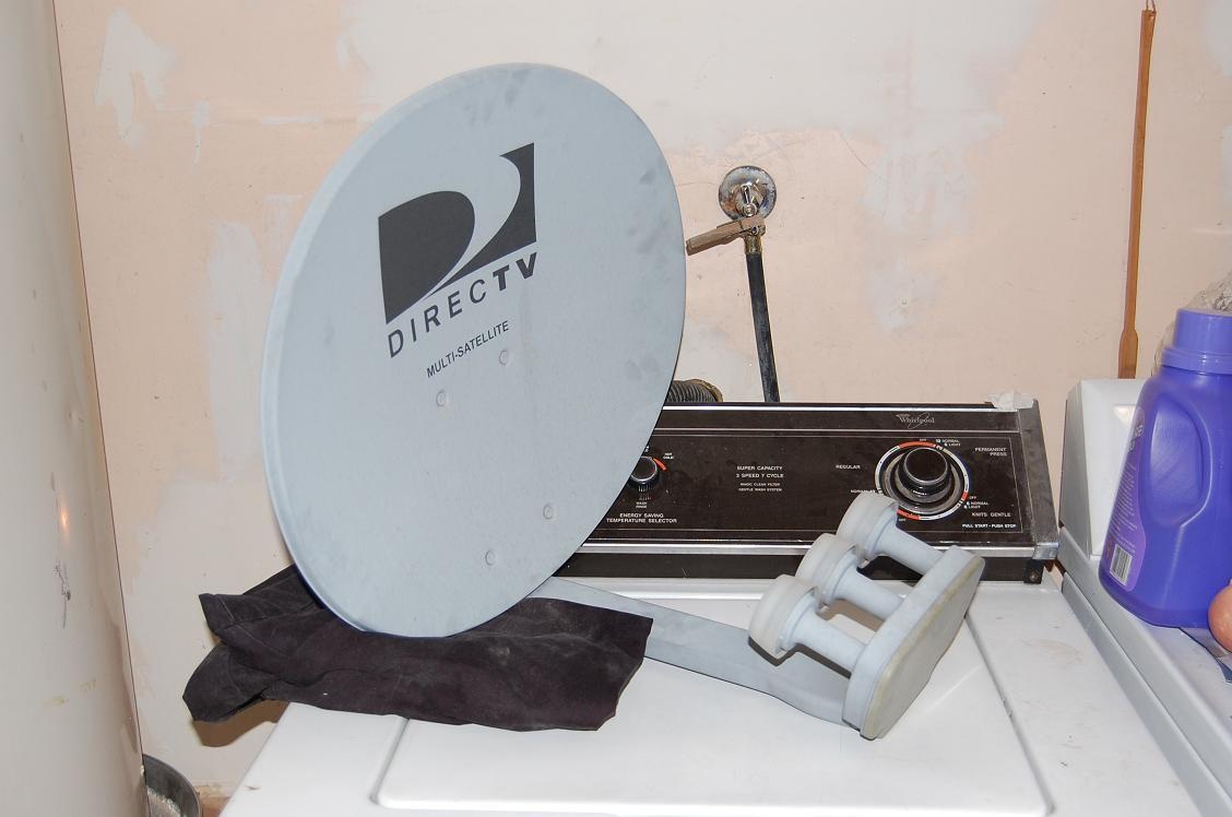

Another question. Instead of aiming my GeoSat Pro at 119.0, I would like to skip right over to 123.0, for the many channels there. So my question is, can I use that Dish 500 that I have sitting in the garage, if I swap out the LNB for a linear one? And if that is possible, could I park the dish 500 on 119.0 to get that NASA channel that was mentioned above?

Show us several photos of your little dishes.
I think I suggested this several weeks ago . . . :rolleyes:
We can select the easiest one to use for NASA @ 119°.
No change to LNB required.
It's equipped with a circular LNB, just like you need.
Yes, you did request a photo of the small stuff back then, but I was swamped with replies and advice. Now that we have a channel or two, I have some breathing room. The family members were getting antsy, as you can imagine.
Okay, I'm taking the camera out to the garage right now.
Here they are. The DirectTV dish was on the house when we bought it in 2004, and just sat up there unused until I removed it recently.
The Dish 500 I bought slightly used from a local dealer.
I believe the Dish 500 is a Dish Pro Plus.
Should be a sticker on the LNB to identify it.
I see three screw-on connectors in your picture, so that's how I know.
It tends to pull a bit more power than the regular ones, so it wouldn't be my first choice.
Oddly enough, the DirecTV Phase III dish will work as-is pretty well.
Hookup is described by Iceberg in another thread.
I will hot-link it here in a few minutes (by editing this post). edit: done

I thought that I needed to stay with a linear LNB to get FTA. Now you say I can use the DirectTV dish as is? And it has a circular LNB? Do I sound confused? That link went on for several pages, and I could not understand a lot of it.
Is NASA a FTA channel and yet sends out their signal in circular polarization?
One of those three lnbf's on that dish, is a Linear lnbf. The trick is all in the pointing of it?
I don't know which one is the Linear one, but I'm sure it's mentioned in the link Anole provided for you?
