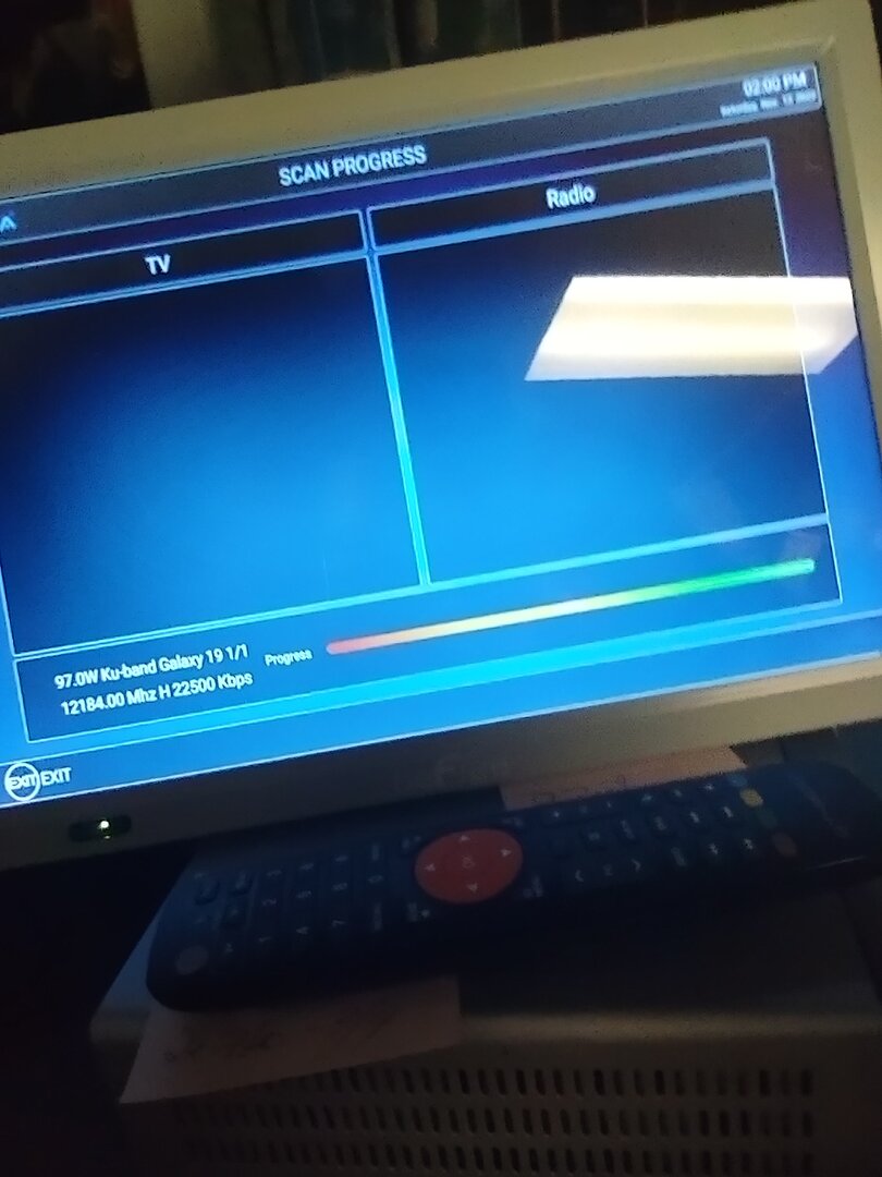

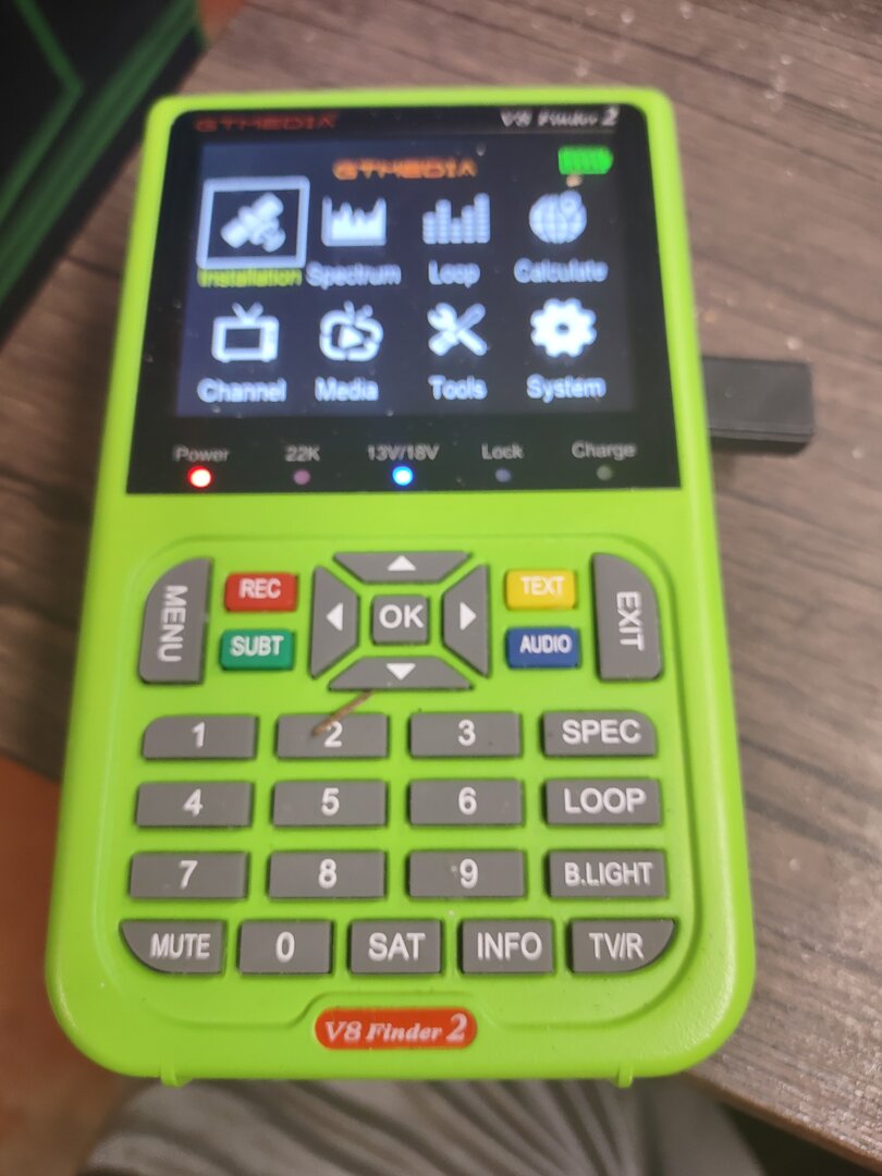

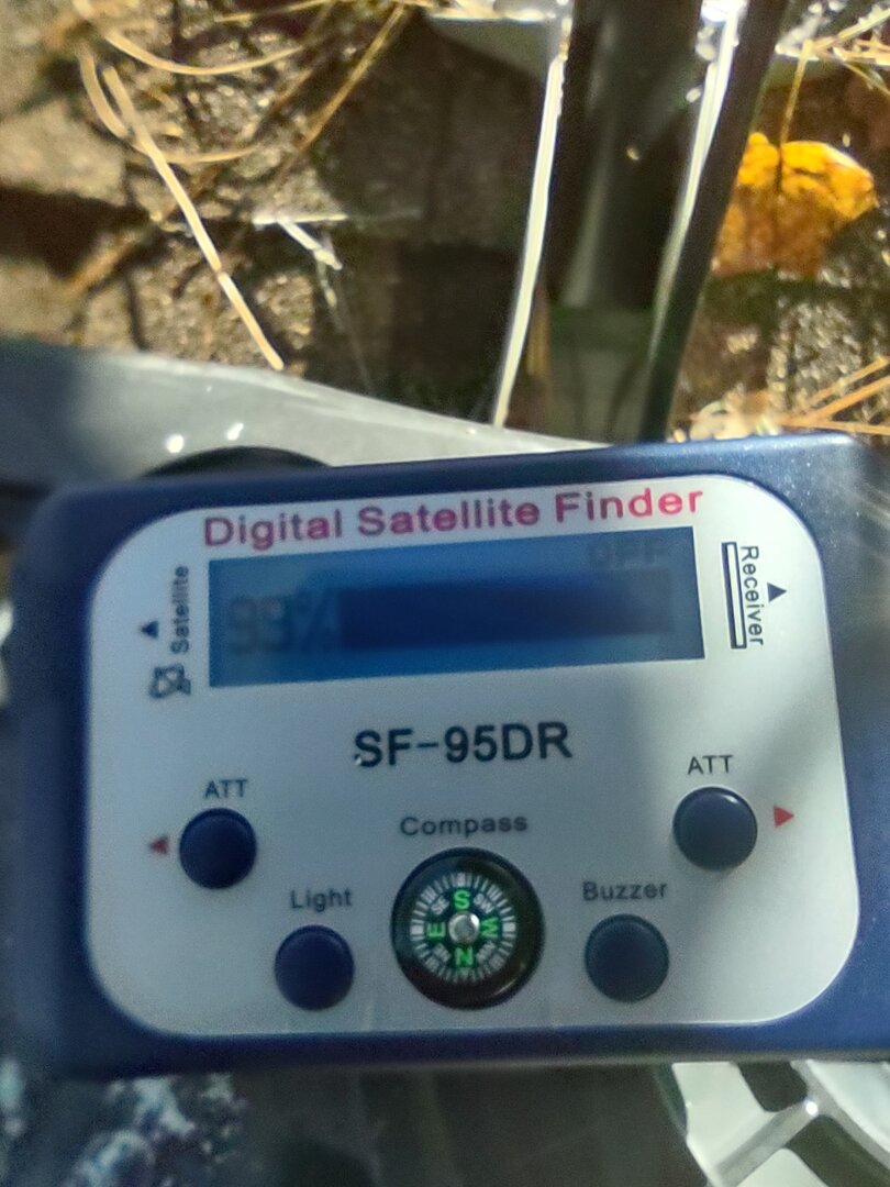

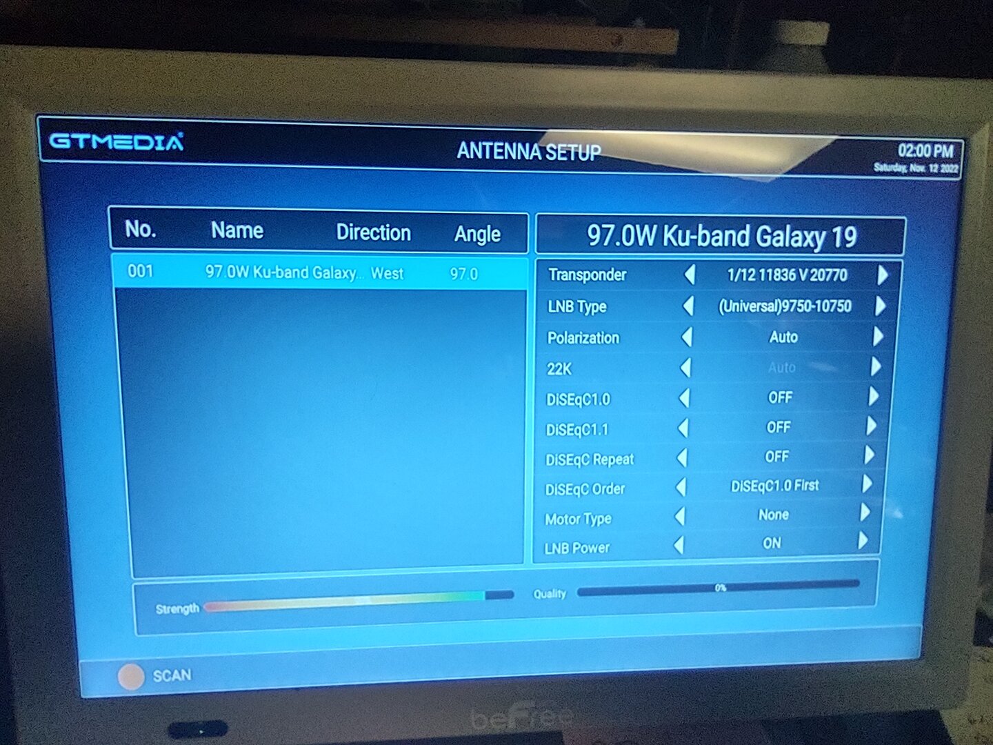

Hi Guy's.... Sorry for my delay but last week I fell off the ladder was out of commission for a few days. I went up today and tried to connect with 97w and its seems by the hand meter I have 99% connected and I have good strength on the receiver but 0 quality. I also took a pic of the gtmedia v8 finder 2 that I can't figure out to use and gave up on. If by looking at my pics is all I have to do is gently move it to gain quality? or are my setting wrong or even both. Thanks again so much for any help.

That transponder you are using in pic. one 11836 is no longer active so you will need to change that setting to an active transponder.
