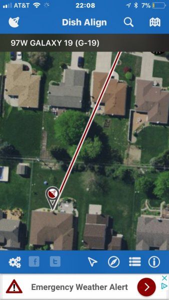

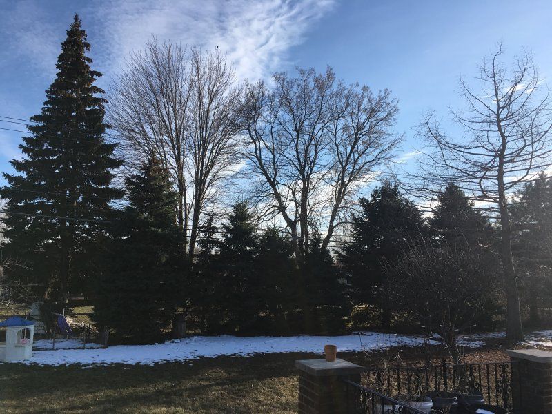

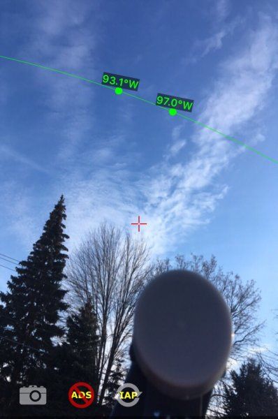

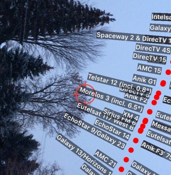

Well, I had 33% quality on G19 from this location Friday. All day today and yesterday I couldn't get any Q readings on G19. 73% Q on CCTV. I'll take more pictures tomorrow. Could a tree really block a sat two degrees away?

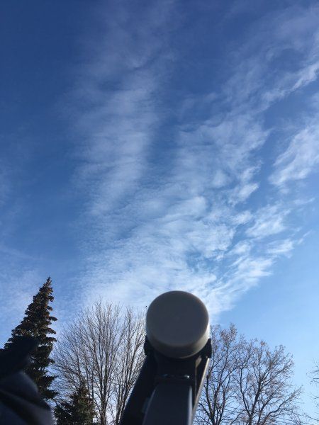

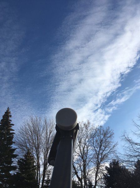

Can you move the dish to a location completely clear for the southern sky? That's what I did earlier today to find the satellite I was looking for.
Are you saying the circle you put in that tree is blocking 97W?

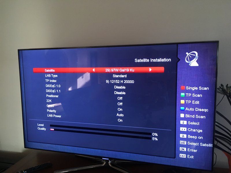

Do you have a meter? If so, check your coax for continuity, a short or loose F connector or just try a new piece of coax if you can't test it. I recently lost signal on a long stretch of coax (about 120 ft). Found out the cable sheath had cracked and moisture was getting inside. Cut out the bad section and put a temporary patch in until Spring and I was back in business. Also double-check settings in your receiver (lnb power on, lo frequency correct, etc) and lnb skew. Probably something very simple.No, I don't know what it is. I'll take more pics tomorrow but I find it peculiar that I had 30%Q in the exact same place but now I can't get anything.
Do you have a meter? If so, check your coax for continuity, a short or loose F connector or just try a new piece of coax if you can't test it. I recently lost signal on a long stretch of coax (about 120 ft). Found out the cable sheath had cracked and moisture was getting inside. Cut out the bad section and put a temporary patch in until Spring and I was back in business. Also double-check settings in your receiver (lnb power on, lo frequency correct, etc). Probably something very simple.![]()
Glad you are getting 95W.Everything's working because I'm watching galaxy 3c with 73%Q
Glad you are getting 95W.Just suggested checking settings because most receivers require each satellite to be set up individually (ie: lnb power can be turned off for one satellite while left on for another, each satellite can be assigned a different lo frequency, etc). Often when going through the menus a setting gets changed accidentally for one sat while the other sats remain correct and function properly.
I know, just saying I'm glad you're getting 95W because that means your lnbf, receiver and coax are functioning properly. Given that, if you have rechecked your receiver settings for 97W and re-skewed for 97W then, since you were able to get it before, you should be able to aim for it and get it now. Got me stumped as to why it's not coming in for you.I don't want 95w I want 97w but I can't get it
but 95W is still better than 93W...I don't want 95w I want 97w but I can't get it
try moving the dish from 95w to where 97should be (move west it just enough to lose 95W, don't touch the elevation or just a fraction of a degree down). Do not change any setting on the receiver (don't change it to 97W, stay on 95W, and do a blind scan right there, with the receiver set to 95W but the dish aiming for 97W. Is it getting anything? is the blind scan detecting any frequencies, even if it's failing to lock on them? If yes, can you write them down and list them here? (or post pictures of the frequencies detected during the blindscan?
95W is usually strong enough and close enough that with a small dish (less than 1 meter), you 'll often start getting 97W before you completely lose 95W and vice versa.
Now, with a 90cm dish (if I remember correctly what you said you were using), if you have any branches in the way, that could be enough to cause problems. For example, from my deck, I can get 123W fine, and it's nearly impossible to get 125W because of the top of my neighbor's trees get in the way.
