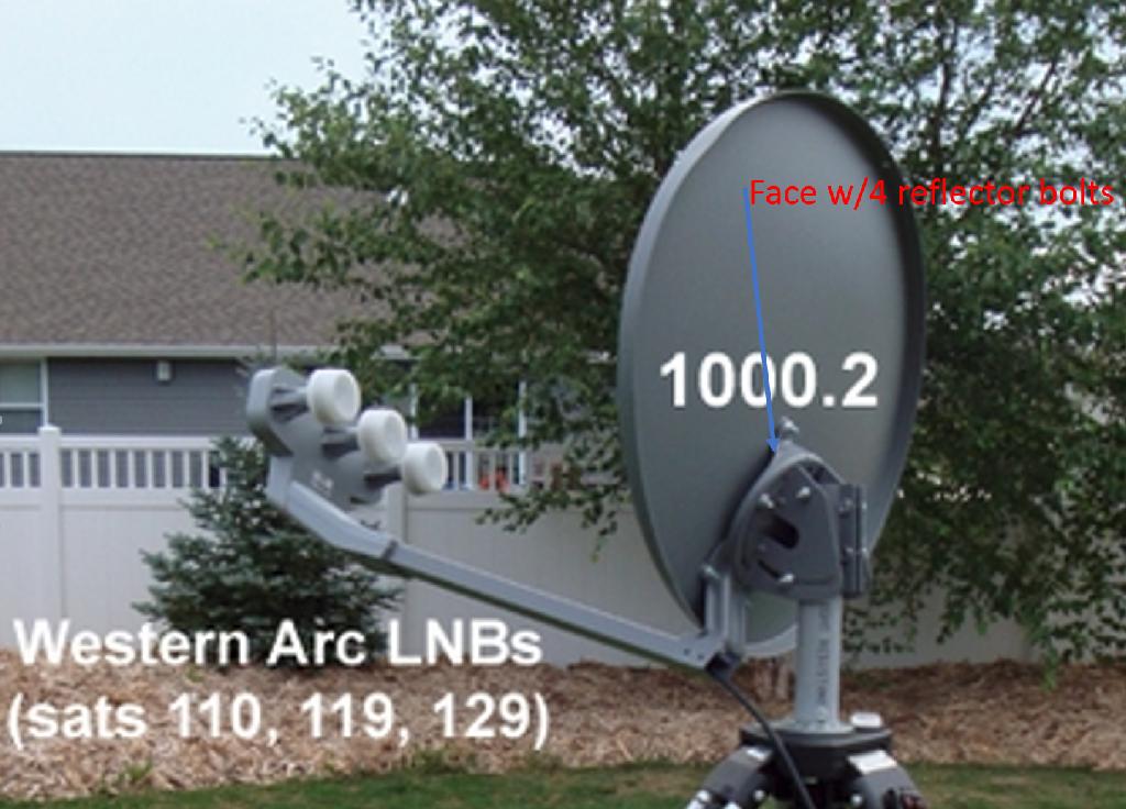

Back to what part of the dish to use to align with azimuth. So use the 4 bolt mounting plate that holds the reflector as a pointing guide? See pix of my typical setup.
I've found the dishpointer.com settings to be the most accurate in my experience. Make sure you're using the multi-LNB section of the satellite selection chart. The azimuth is aligned using the side plates of the mount where the elevation adjustment is located.

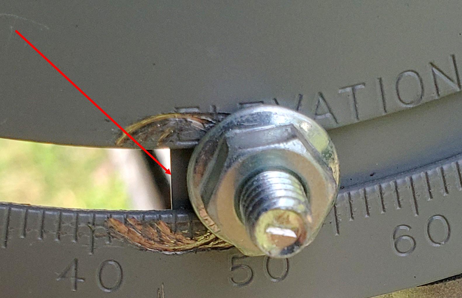

I'm just an old A/C repair guy but inexperienced on this dish stuff. Keeping me baffled. I just ran across a video that made it clear that I was setting the elevation incorrectly. I was using the center of the bolt as the index mark!! Not the straight metal line in my pix. I was certain that the 1000.2 would have an index mark for the elevation as clear as for the skew. It does but I just did not know it. Sad, truly sad. It's really bad when the learning curve is made worse by the fact that all the info on this subject is scattered all about and not in one place. No wonder I could never get any signal. And yes, the Dishpointer app I've got on my phone seems to give me good numbers.
