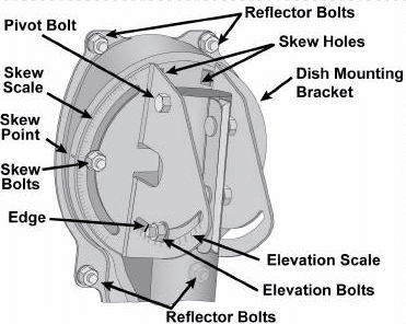

If you think you can set up the dish to the specs, then go inside and start watching TV, it doesn't work that way. There is very little room for error, and you'll need to tweak it just to get any kind of signal.
What I've done for years is this. Set the skew and tighten the bolts. Set the elevation and snug the bolts. Start either east or west of your target azimuth and slowly swing dish through the target zone. When you hit a signal, check to see if that is the correct satellite (119). Get the signal as best you can on azimuth. Then, tweak the elevation very carefully to achieve best signal. This should render you a usable signal on all three satellites. In 11 years of full time rv'ing and setting up the dish multiple times per year, I've never had to tweak the skew.
You will need some type of meter, it doesn't have to be an expensive one. I used the meter on the receiver for years, listening through an open window. Then, I bought one of those $10 things to use outside and would go inside and look at the receiver to verify. In any case, you can't just set it up with a compass and expect it to be right. JMO
"never had to tweak the skew". "skew can be left alone once set". Very confusing. Every zip code I stick into Request Rejected comes up with all three different angles. I'm thinking that these points are meant for a/my single location - therefore once 124 is set for my backyard, it will not change. Correct? So, I'm hearing lock the skew, then get close with the compass and then smoothly jiggle through the azimuth after getting fairly close on the elevation. Problem for me is that I cannot seem to get to a page in the setup of the Wally that will give me any indication that I'm even close to a signal. And will not allow me to input a sat# or transponder. Question.... Can I use a known working but decommissioned ViP612 at the receiving end of the 1000.2? As a test instrument? Sorry to be such a novice but I do enjoy learning. And if I hire some bloke from Dish to come do it, I'll still be ignorant.
Once the skew is set for your current location, it usually doesn't need to be touched again. If you're using the numbers from DishPointer.com, make sure you're using the settings from the "Multi-LNB" section near the bottom of the sat list. I don't know if the Wally menus match the Hopper menus, but if they do, the "Dish" page of the "Diagnostics" section should show you the signal strength for the satellite and transponder your dish is seeing. And yes, your deactivates 612 will work as a setup tool.
