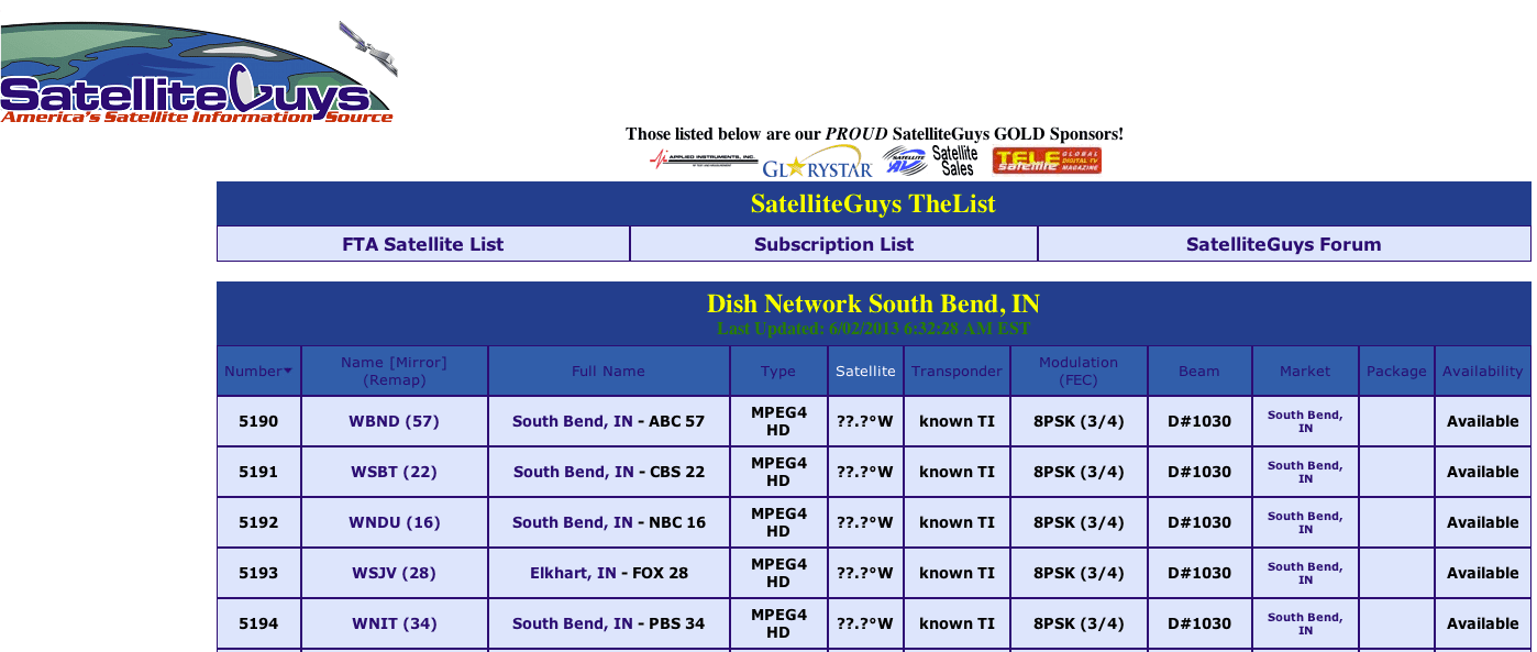

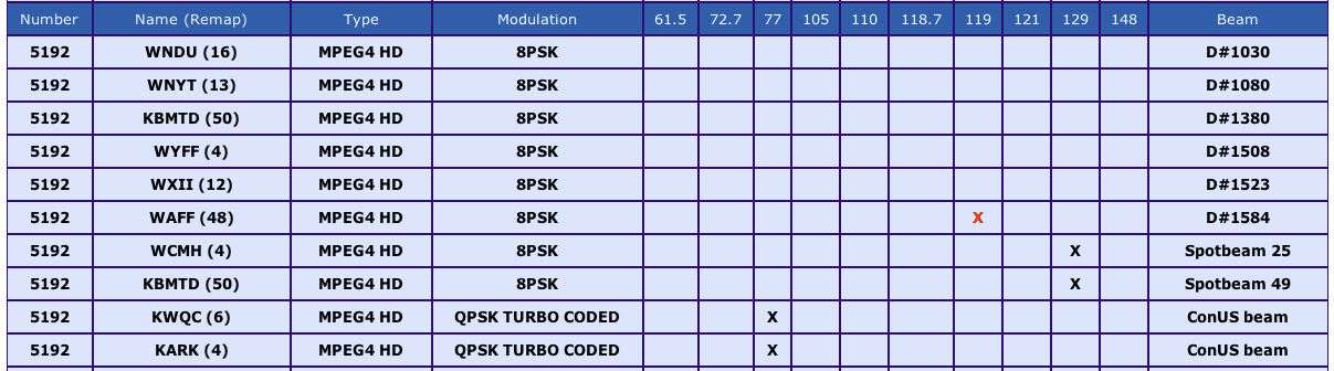

For 61.5 it's 10, 14, 29, 31 (29 & 31 are out of service.) For 72.7 it's 15, 17, 19, 21. Minimum for those transponders should be 47.
As you can see by my numbers, I'm at least 20 "Quals" beneath that.
I'm curious about the block of zeros for 61.5?W Xpndr 18-32. If they aren't used, should they be skipped? Or, are they Spotbeams that aren't pointed my way?
