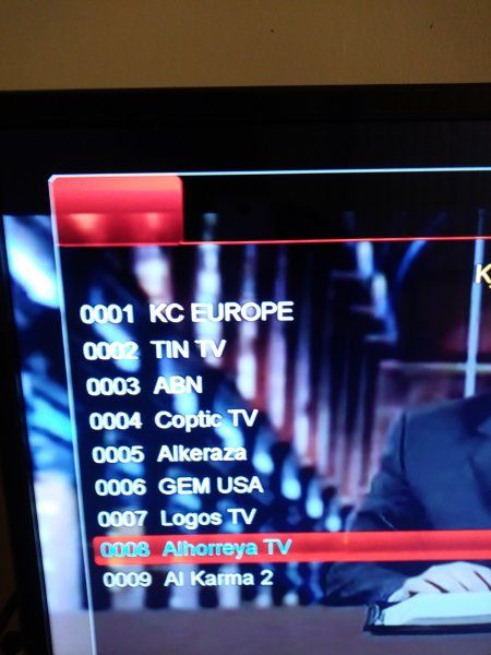

Ok I readjusted and did another blind scan here's a channel list don't know what sat im on now I searched galaxy 95 W and put in 12152 20000

Your getting there..........97W.
Oic so I'm getting close ok thx. Well in the morning I think I'll search for the AMC Satellite so KE4EST is the sat meter readings right I'm kinda confused since another post is telling me that the meter is not accurate

O ok thx for letting me know I'm new to the fta sat world lol well I readjusted the sat now I got a bunch of foreign language channels its cool tho its pretty fun searching for the sats I'm working on getting a C-band dish now
