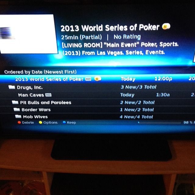

But I never set to record them in the first place, that's what's driving me crazy. And they are not in the series manager or anything so I cant 'unrecord' them.

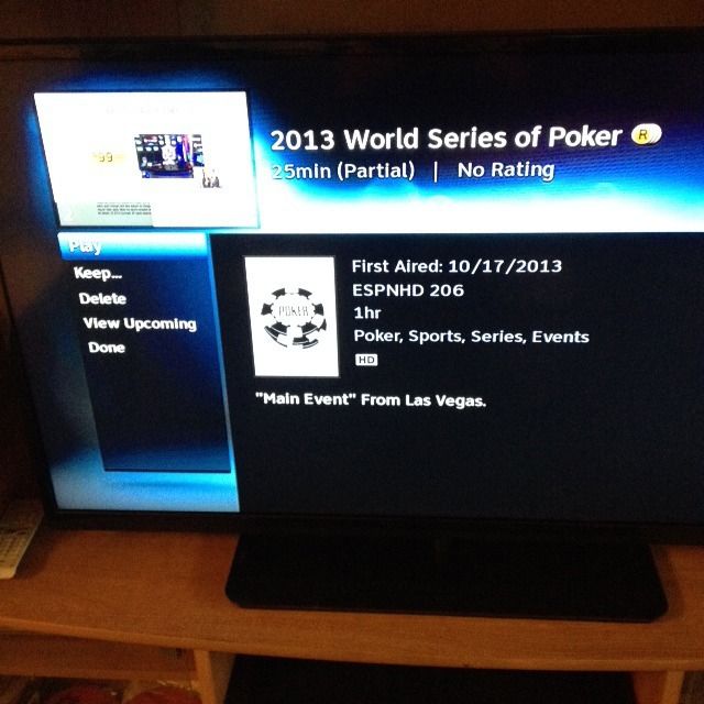

For instance, all this stuff I havent set to record except Mob Wives. Even this poker series stuff when I click on it, there is no option to unrecord the series. dtv.jpgdtv2.jpg

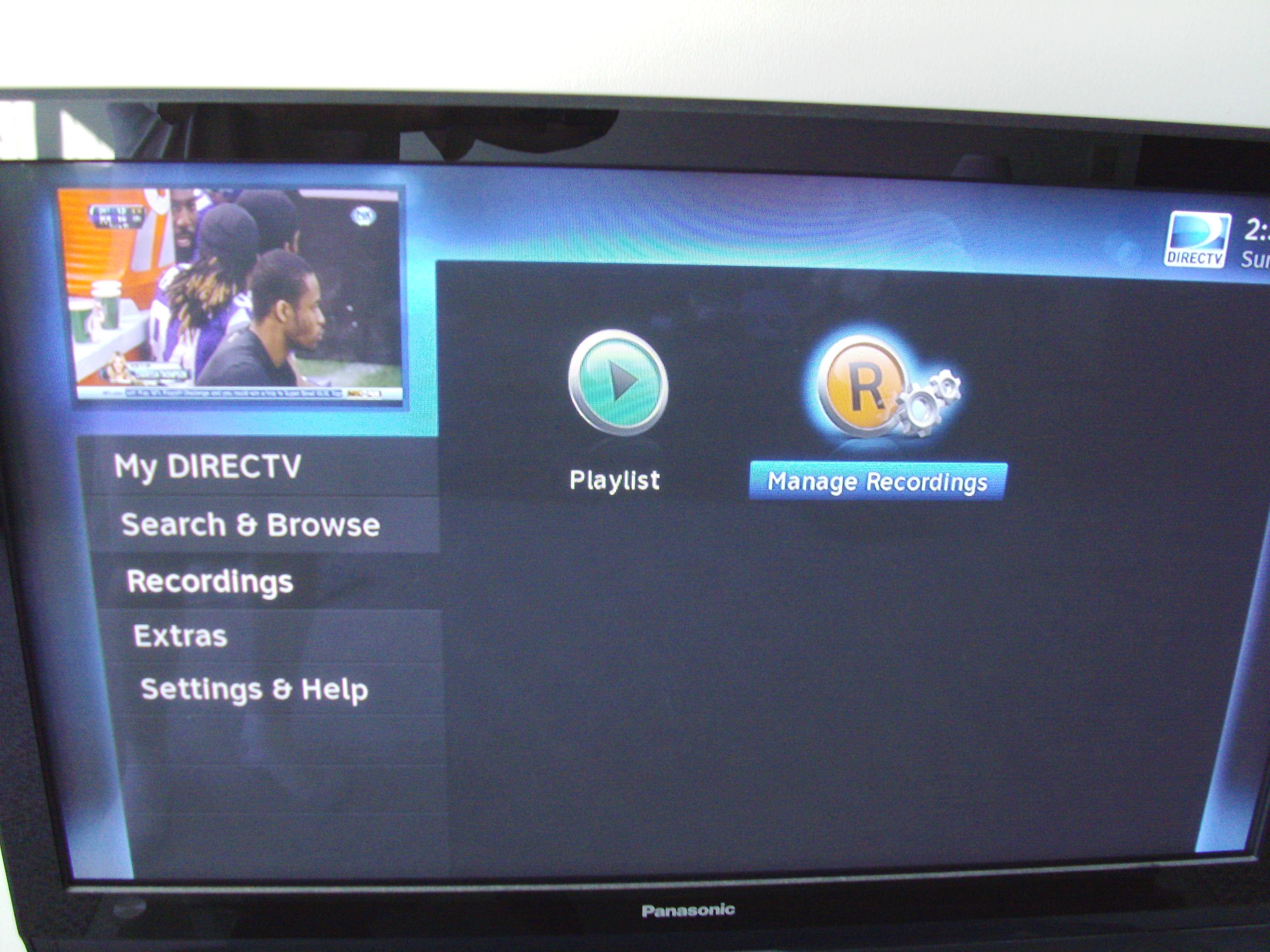

ok...to remove series that are set up to record
MENU
down to RECORDINGS
over to MANAGE RECORDINGS (see 1st pic)

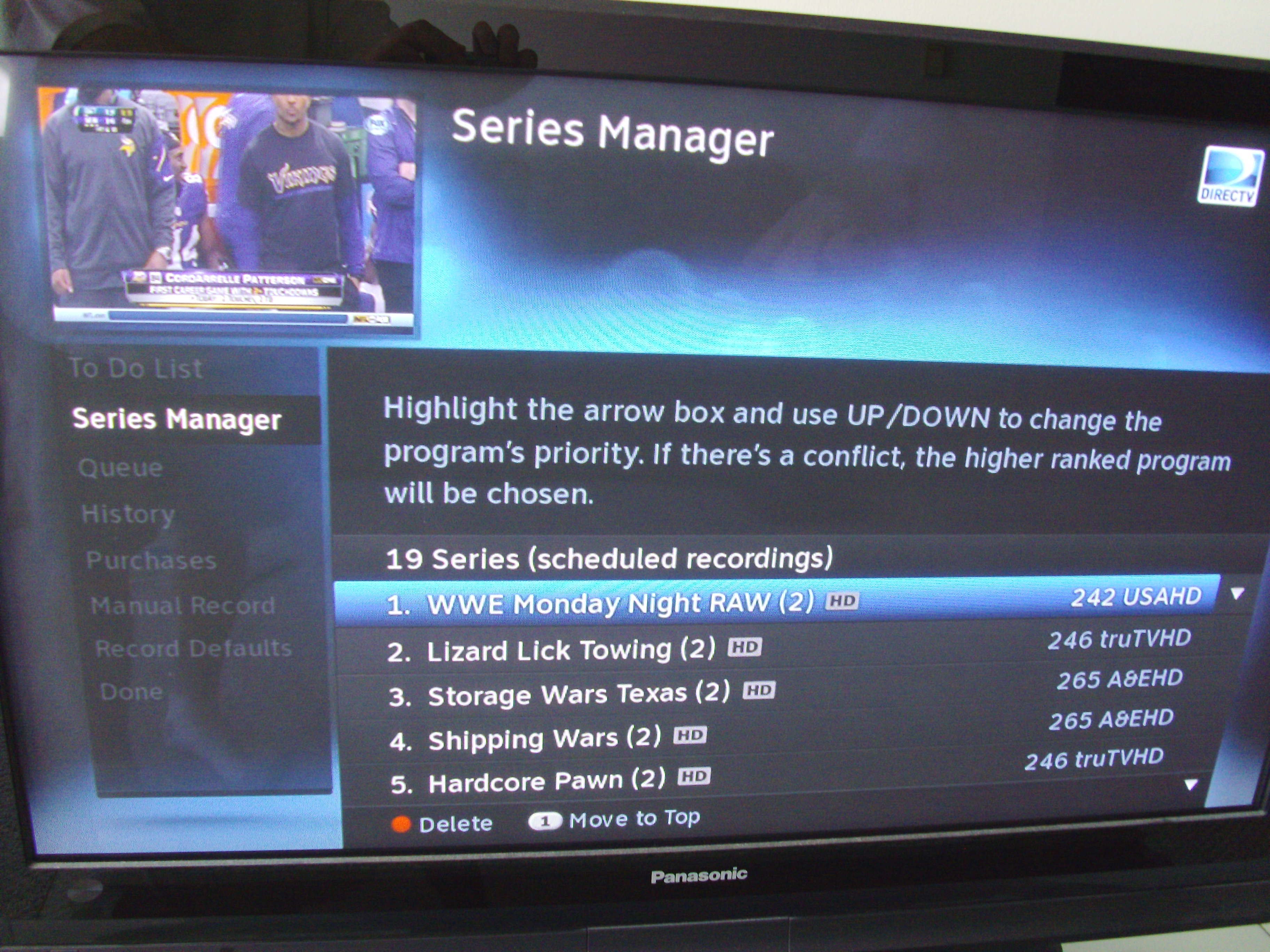

down to SERIES MANAGER
then scroll to the series to delete and press the RED button (as it shows in the bottom of pic 2)
to remove a recording that has already been done bring up the list like you did on your pic posted above and press the red button to delete. If there is a folder just scroll to the folder name and press red button. It will ask you if you want to remove all programs from that folder.
For anything currently recording it will ask you if you want to stop the recording first

The shows are not in the series manager, that's what I'm trying to say. There is no way to stop recording them.
weird.......then go into your recordings (1st pic you posted) and find the item recording and hit the red button. That will stop the recording

Wow!! So I just called my neighbor who I know watches poker and sure enough it's all their shows that are recording on mine and we were deleting each other's shows! They have a genie box. So we are both calling tomorrow and having them fix this!!!
