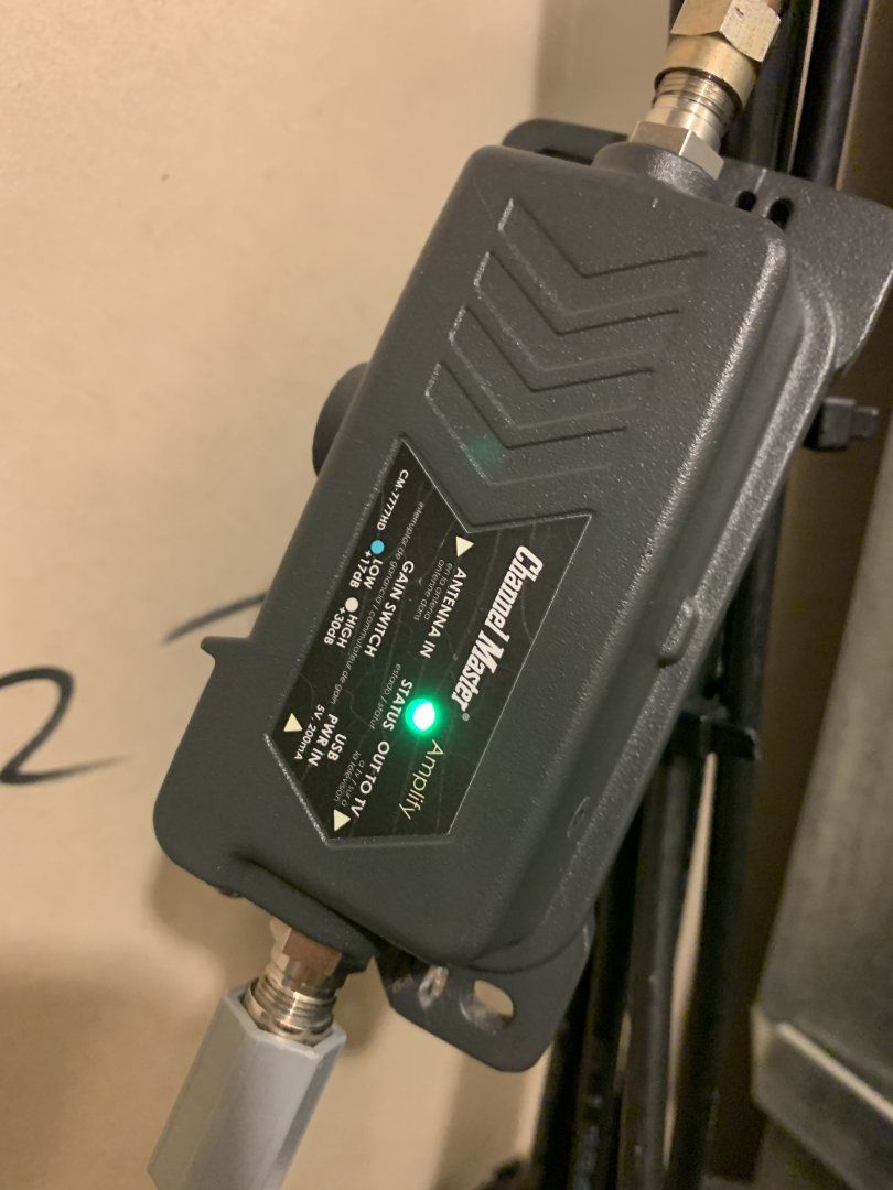

I just remembered that the Dinova Boss Mix has the ability to work passively without amplification. I noticed this when I saw that most of my channels were still there, just at a reduced signal level. This has me thinking I could connect a third party preamp to the Dinova. I plan to test this out later today.
Well it worked. Installed the CM-7777HD preamp where the Dinova's signal enters the utility room. The signal was initially too hot on the 30dB setting so I reduced it down to the 17dB setting and now all is well. I can now confim that the Dinova Boss Mix can be paired with a third party preamp.
