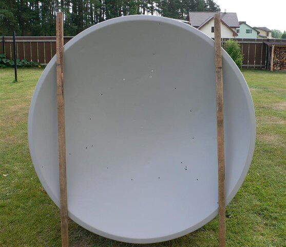

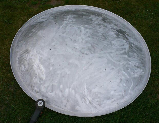

My another 1,8m dish is also PFA, but aluminum this time I20130501_181311 (Medium).jpg . Got it really cheap but, as usually all metal parts were rusty and needed some radical methods to be applyed, for example- using angle-grinder to cut-off old bolts P1270296 (Large).JPG . There was bad painting on the face of the dish, so I decided to remove all paint and repaint everything P1270334 (Large).JPG P1270335 (Large).JPG P1270305 (Large).JPG . It took some time :coco Then I brought dish to paint-shop and they powder-coated and dried in big oven P1270743 (Large).JPG . For feedarms I decided to use 3 INOX pipes and lead through them coaxial P1270783 (Large).JPG P1270805 (Large).JPG P1270867 (Large).JPG . Polar-mount seems fine, but also needs to be painted P1270309 (Large) (Large).JPG
