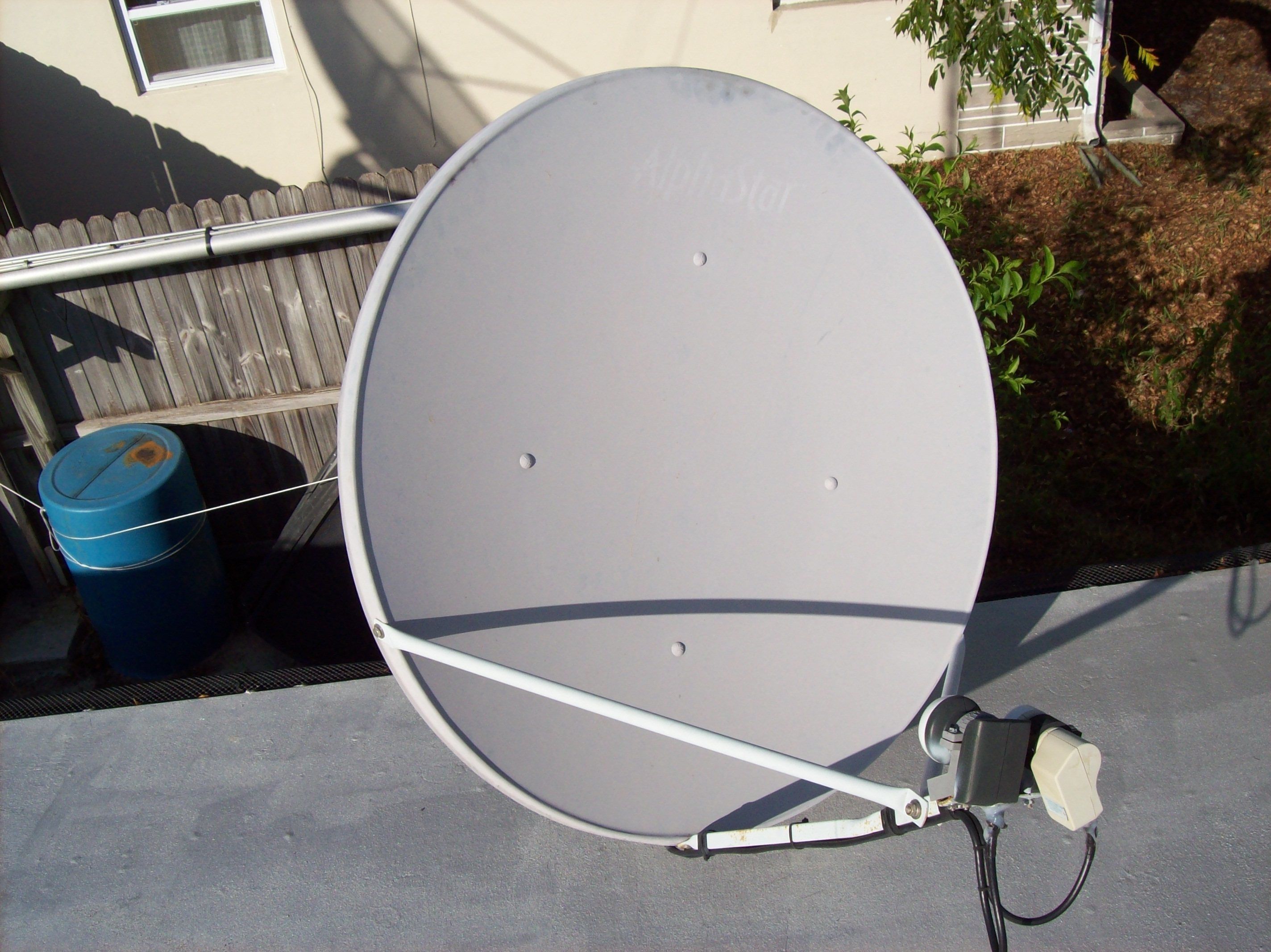

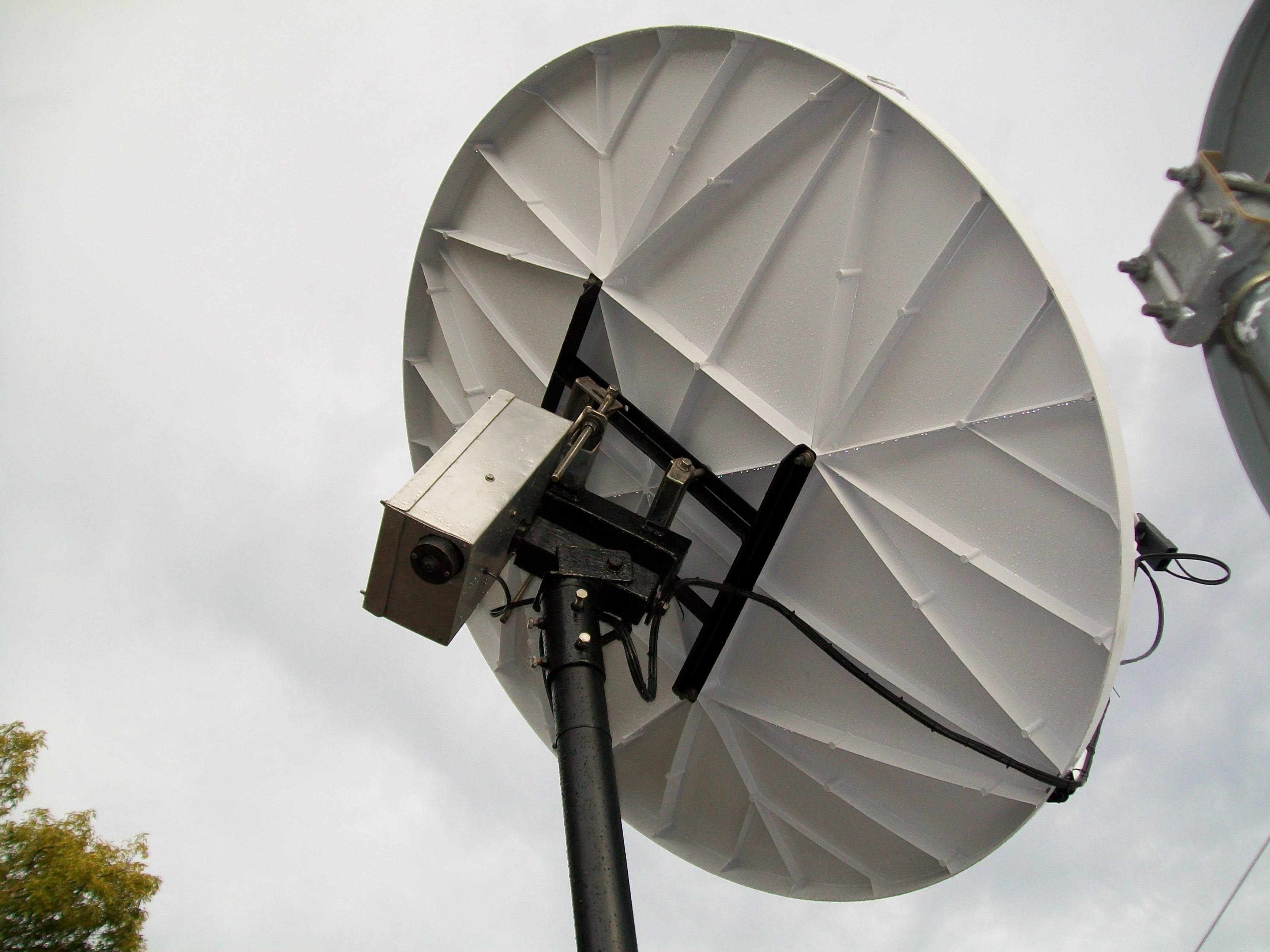

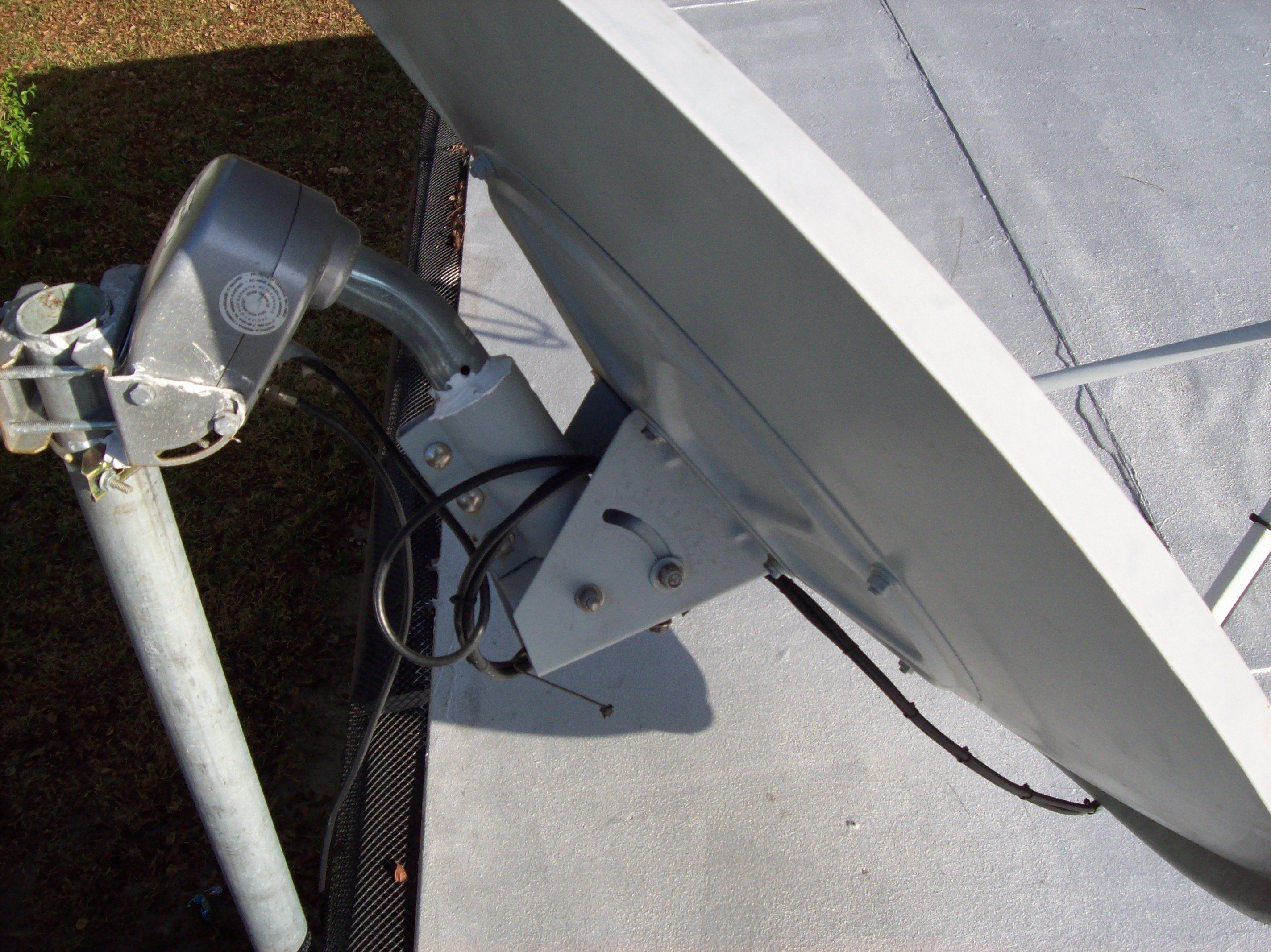

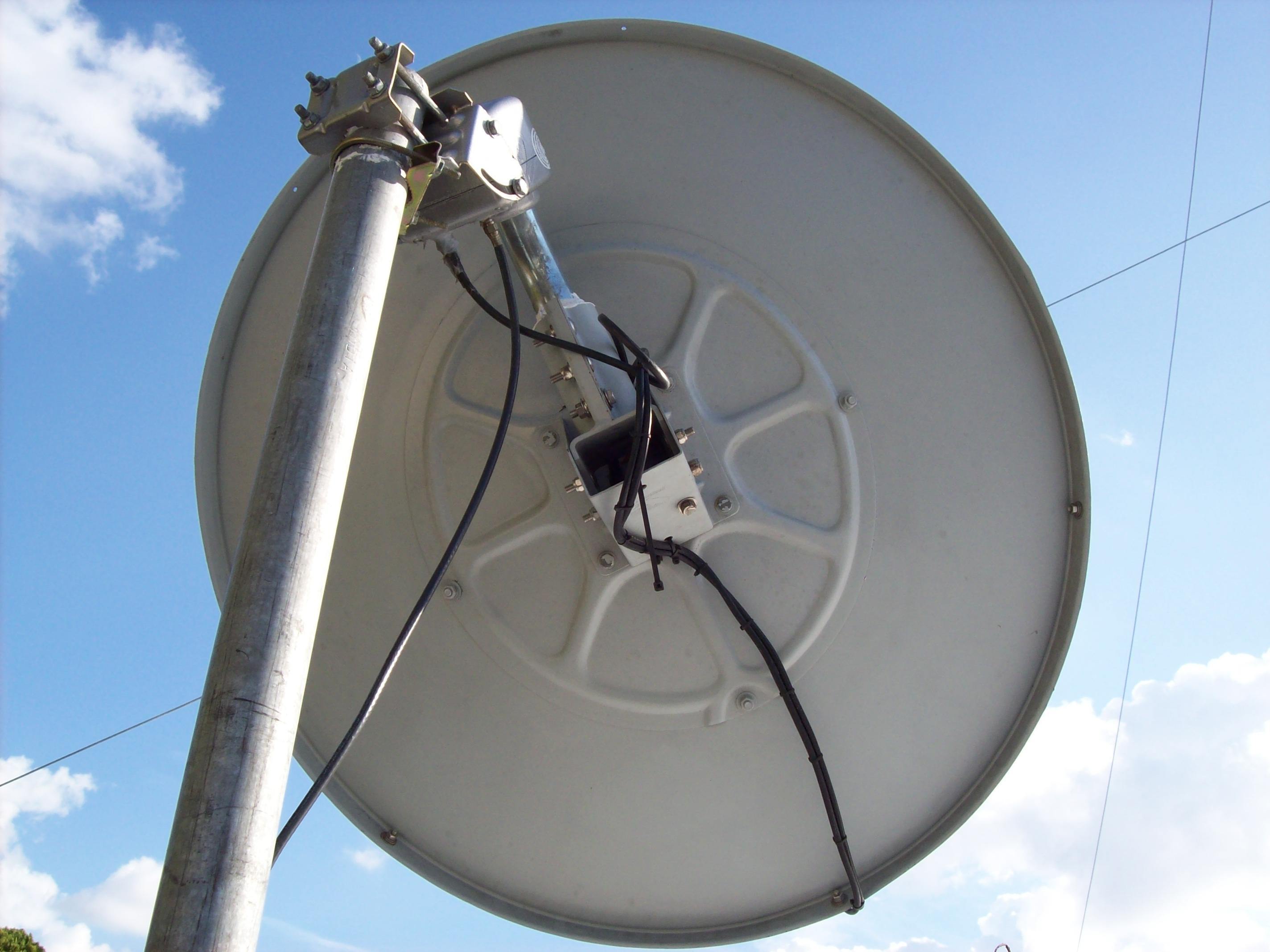

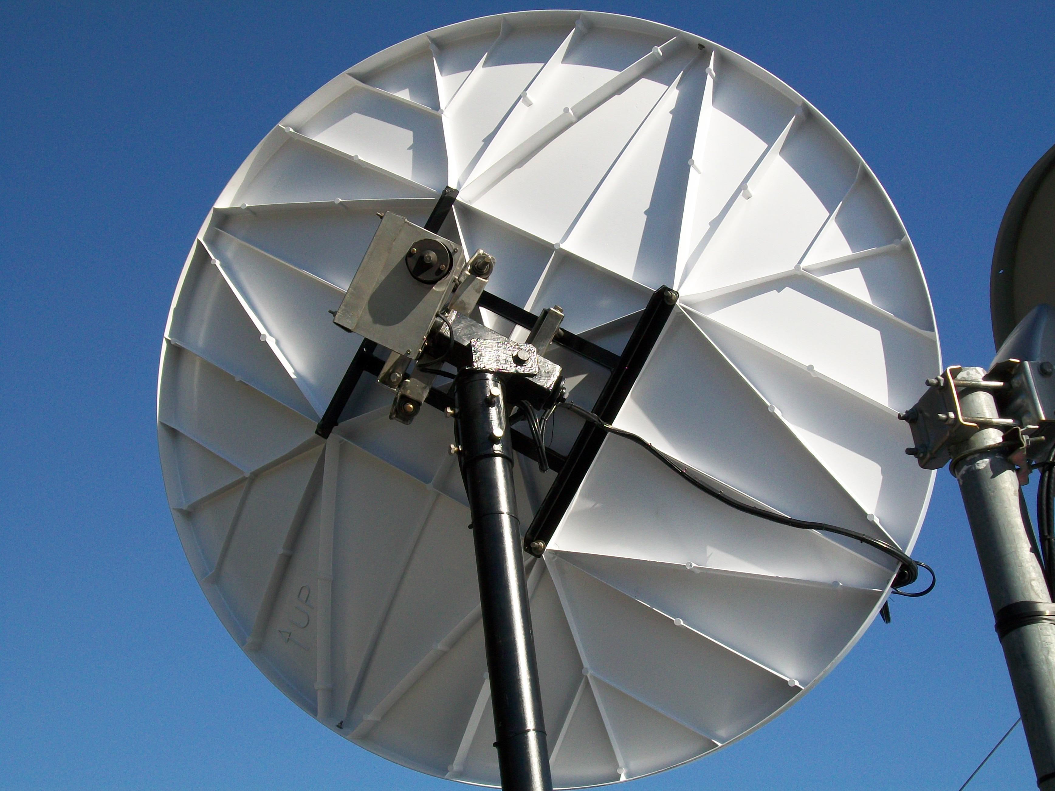

I have 2 move-able ku dishes, a 90cm and a 1.8-meter Channel Master. now on the 90cm it is a old Eagle dish it is a very heavy but solid built, the motor that is on it is a Pansat-900 it has been running it since late 2004, before then had a SG-2100 on it and it did not last a year before the gears got strip out. I am down in Fl. on the coast and in 2004 we had 3 hurricans here with some pretty stout winds, and the SG could not take it, but the Pansat has lasted with much better performance threw out the years also has made it threw several tropical storms here too, more than what the SG went threw.
2nd thought for you, if you replace you're 10-footer you may want to repair the Ajak and fab it on a bigger Ku dish like I did my 1.8 here. their has never been a feed that the 1.8 could not lock, and before the 1.8 went up I had a 1.2 on the same mount, and when I set it up I was shocked just how much more signal that the 1.8m produced over the 1.2m.
I uploaded a few pictures 1, 2, and 3 are of the Eagle 90cm, had to make a bushing for it to fit on the motor, this dish take a 2 3/8" O.D. pipe. picture 4 and 5 are of the 1.8-meter on a HTS horizon mount, now the reason why I chose this mount is it has a full round gear not like most horizon mounts that only have a 1/2-moon spur gear like you're Ajak motor, so it will let you get a dish real low on the horizon.
