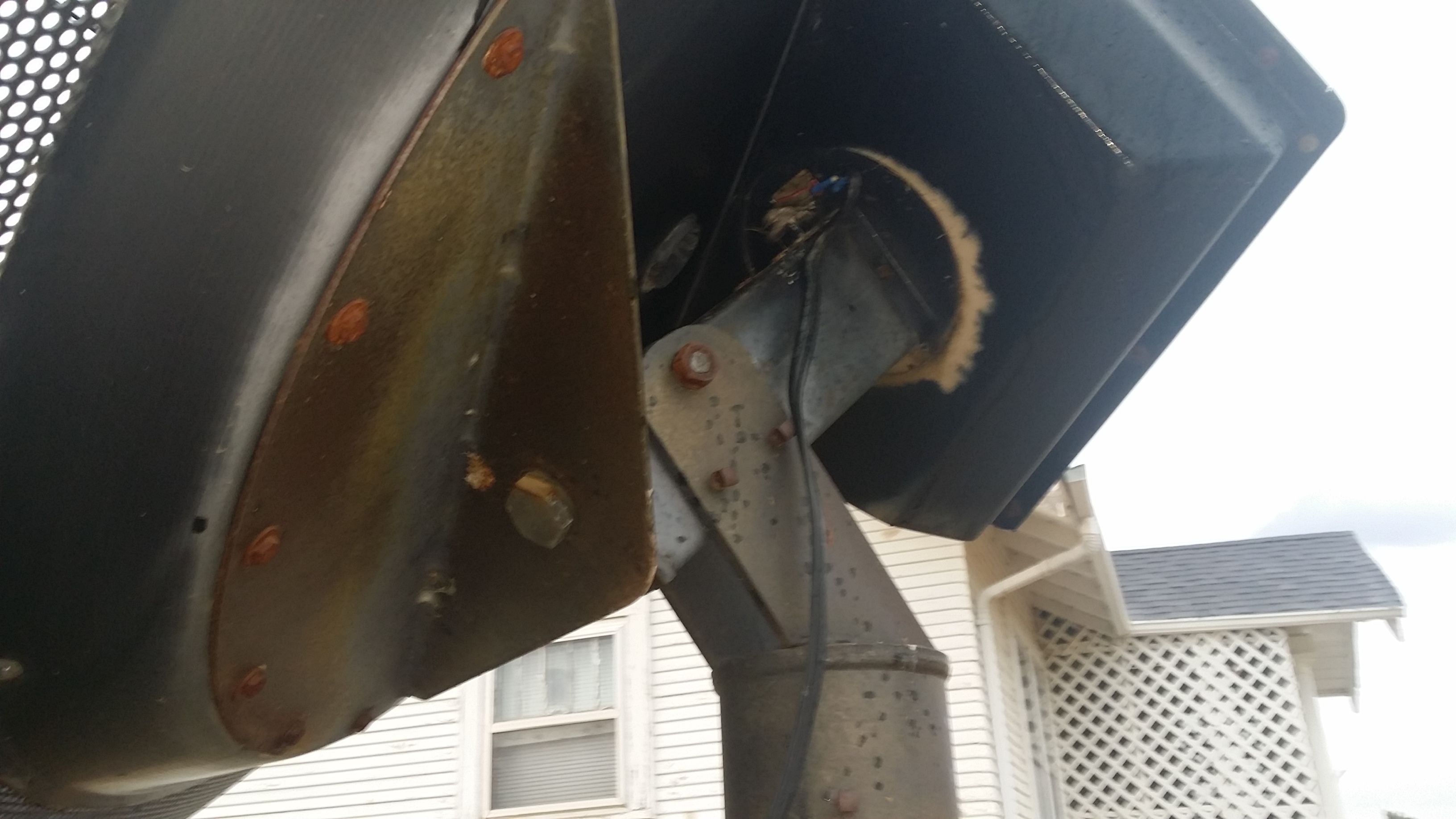

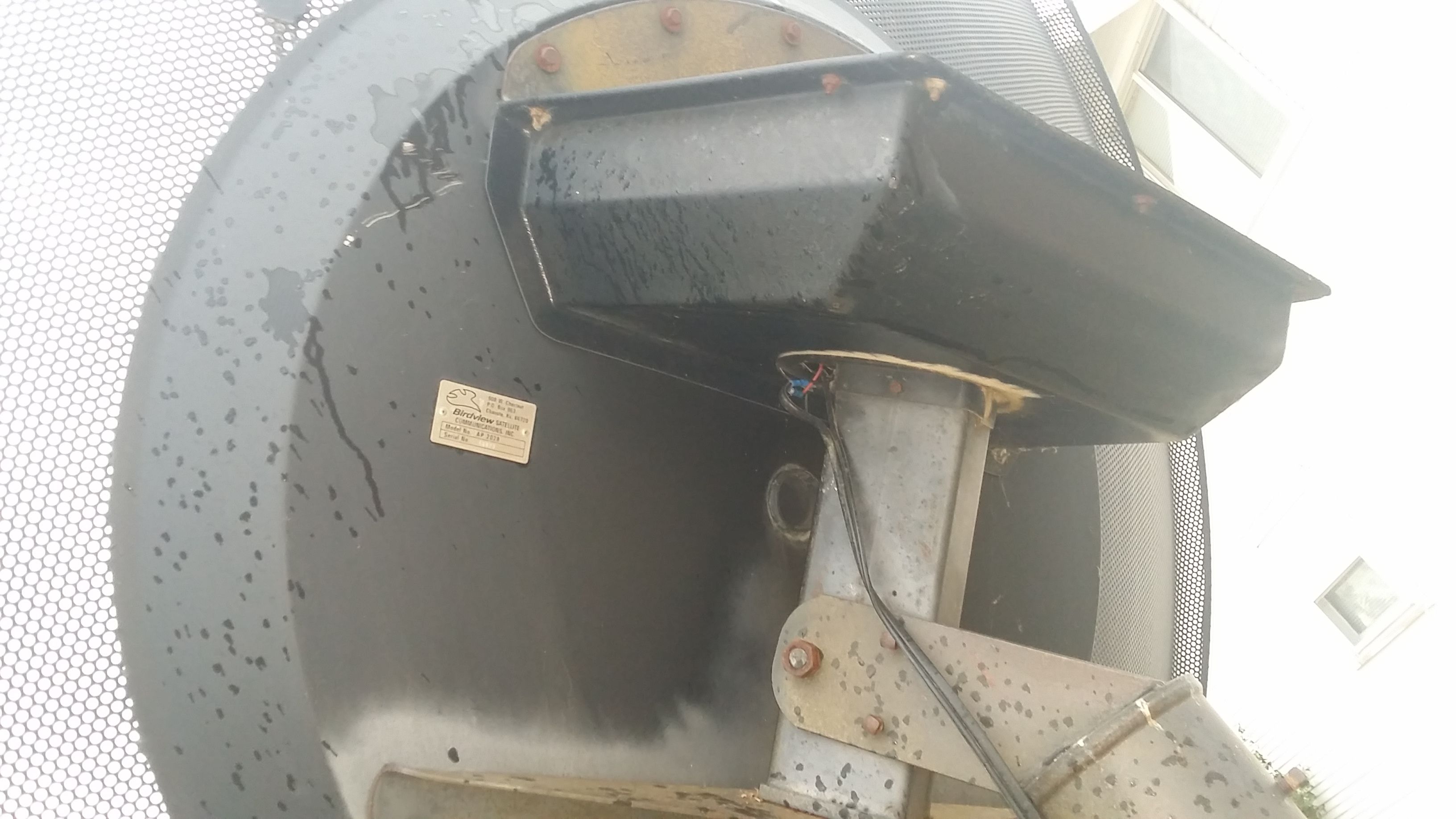

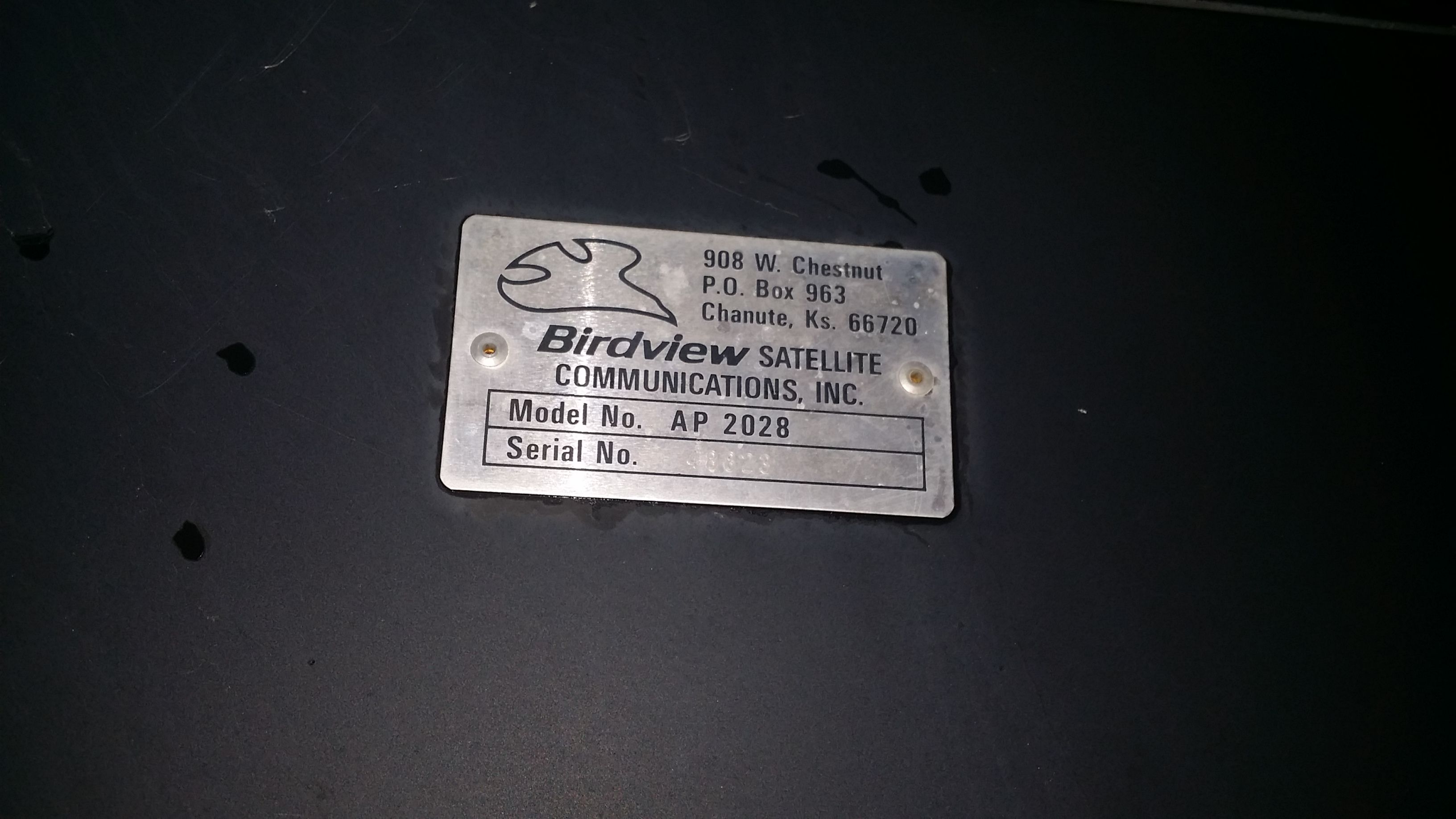

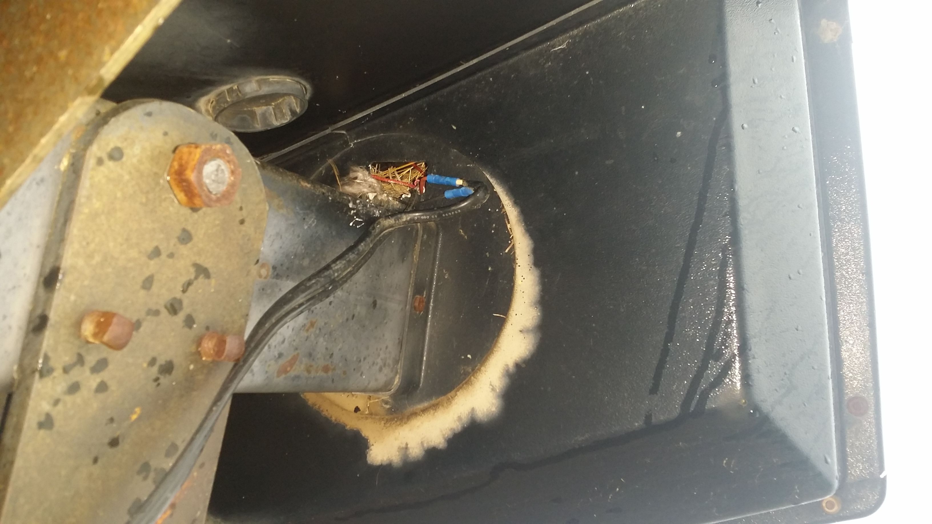

Well found this lovely dish.
In amazing shape. I only looked for a few min today and did not test the motor. Over all shape has to be 9/10.
Now the debate comes should I pick her up or look for something a little bigger. I could still get the 12 foot paraclipse but she needs some heavy work.
I did not have a tape on me but I think she is a 8.5 foot and has a HH motor.
Do you think she would run better then my setup now?

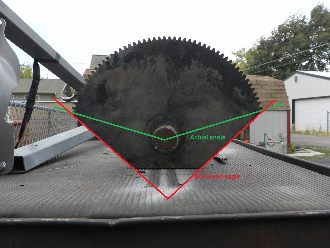

Well you are right. I never have used a BV but I tore a mount down last year to use on another dish and found the motor was bad. The main gear is cut in a way that makes it look it's only 90° of a full circle. But when you actually look at the geometry, it's like you said.
Reactions: Titanium and N6BY

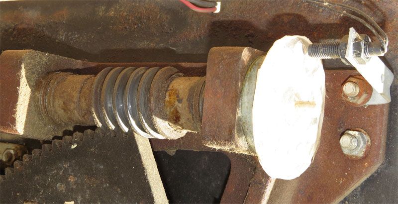

The actual angle looks somewhere around 140, but I definitely see why you thought it was 90. You get an extra few degrees if some of the worm gear teeth are past the edge. To get 54W (67 degrees off center), mine has a few teeth past the edge. Its OK as long as at least one tooth is engaged.
Here is a photo of mine at 54W. Still have 3 out of 5 teeth engaged.

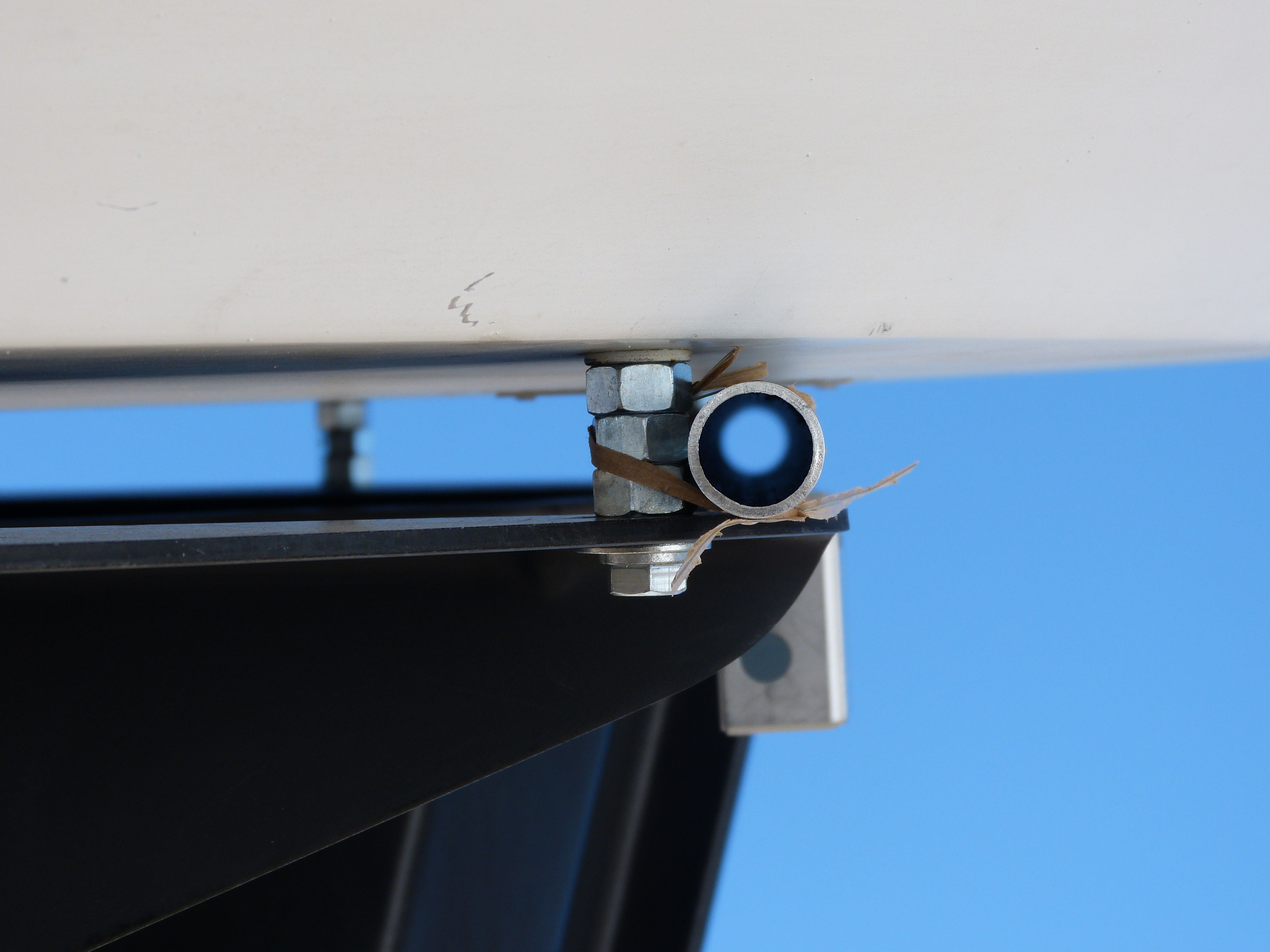

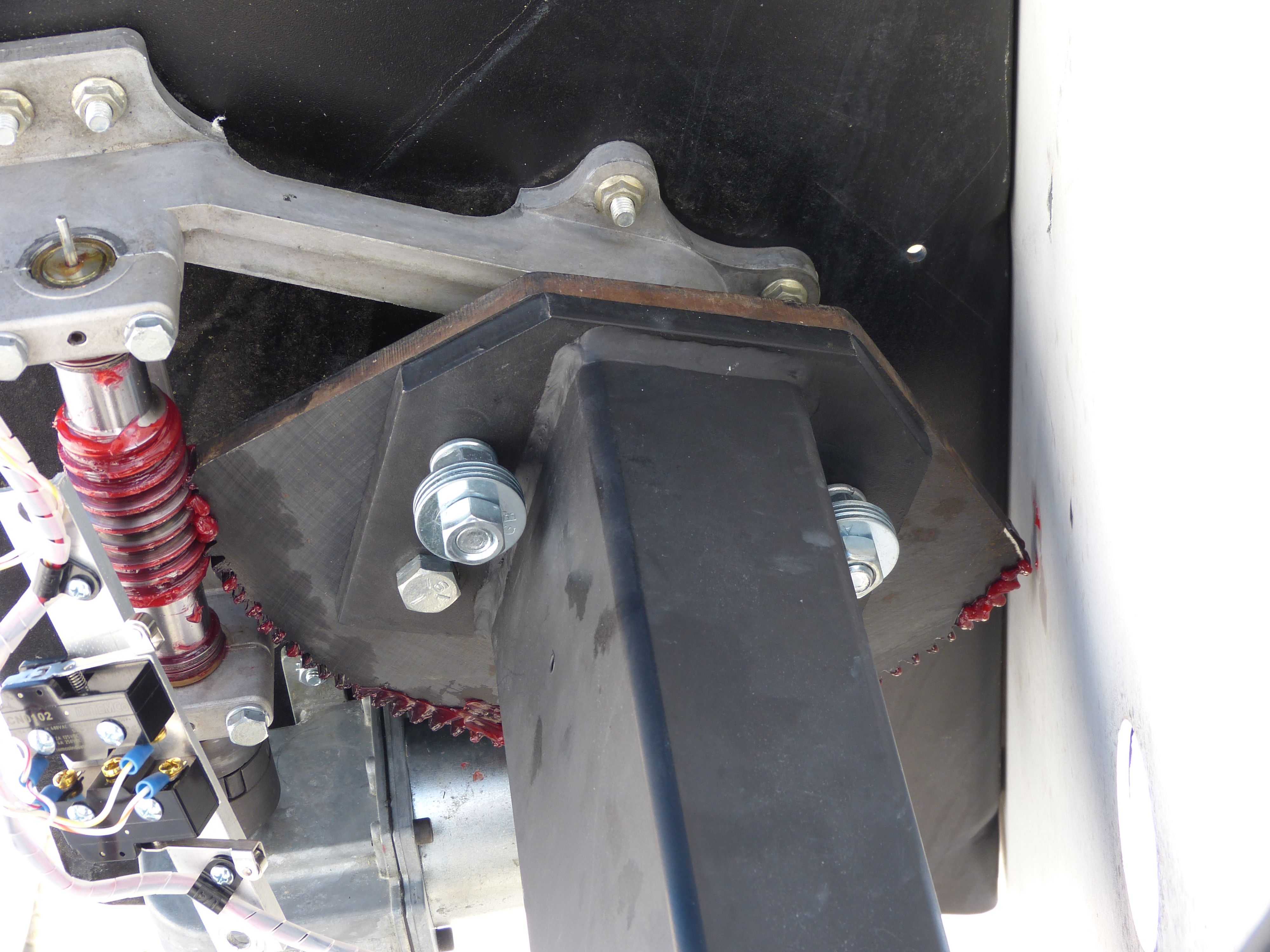

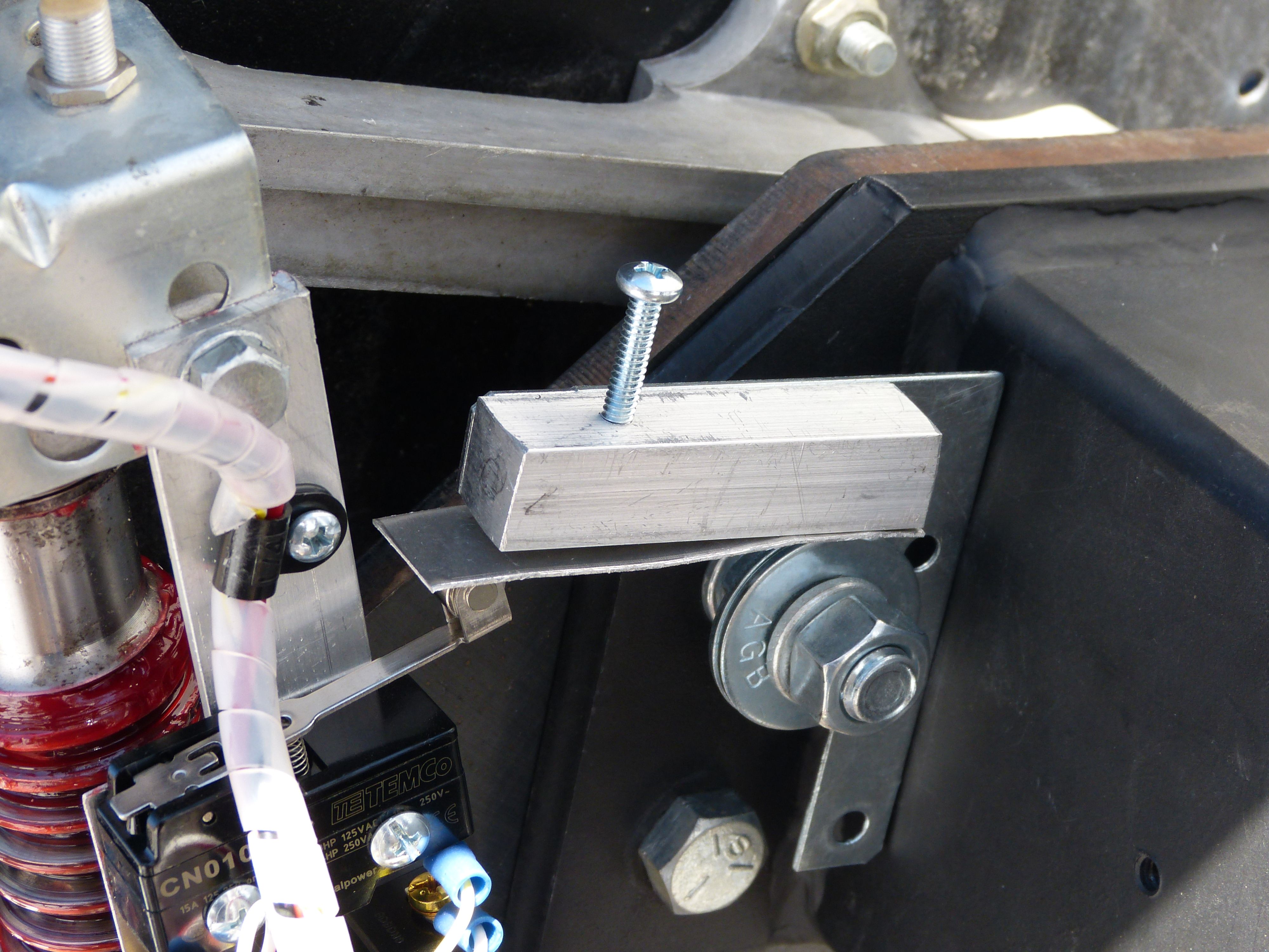

Yep, I get about 142 degrees out of my BirdView. Routinely use it from 36W to 139W and it will go to maybe 178W, but it is pointed into a hill there. I've had it down to 34.5W a few times, but it definitely won't go to 30W.
When I first set it up, the limiting factor on low elevations was the sector gear hitting the back of the dish. I used some oversized nuts as spacers to move the back of the dish away from the mount. Now the limit is either running out of teeth or the mount hitting the pole. I'm not about to find out which, so I added limit switches.

From your photos, your motor assembly looks like it's in very nice shape, especially compared to mine. Is it aluminum? I'm definitely jealous. Really fits with the title of this thread - 'More findings to make you jealous' !

WOW! That is clean! Show car quality. Thanks for sharing.
