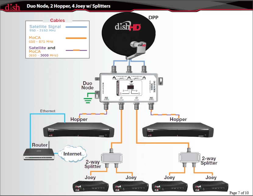

We are planning on a 2 hopper/2 joey install. The first hopper will replace the uverse dvr in our family room. We would like to install the second hopper in our master bedroom. We have not previously had a dvr there only a set top box in the past. Is there any special wiring needed for a hopper? We have the one line (obviously) coming in but do hoppers need 2 lines?
Also, we do not have ethernet available other than in the office. Any issues with this as far as internet connection? We currently use AT&T for wireless in our home.

Here you go :-
Just ignore the 2-way splitters since you'll only need 2 Joeys. Basically, three lines are needed from the dish to the node, and 1 line each from the node to each receiver. The Hoppers require RG-6 preferrably swept to 3GHz though many modern 2.2GHz RG-6 lines will work as well. Joeys only need RG-59, however RG-6 preferred (IMO.)

The RG-6 cable needs to be rated for 3G, anything less will cause all types of problems. As far as an internet connection, the hopper can connect to the wifi if that's the only option.

Your present RG-6 , six year old wiring should be fine. You just have to have new cable run from the Dish to your present "wiring hub".
