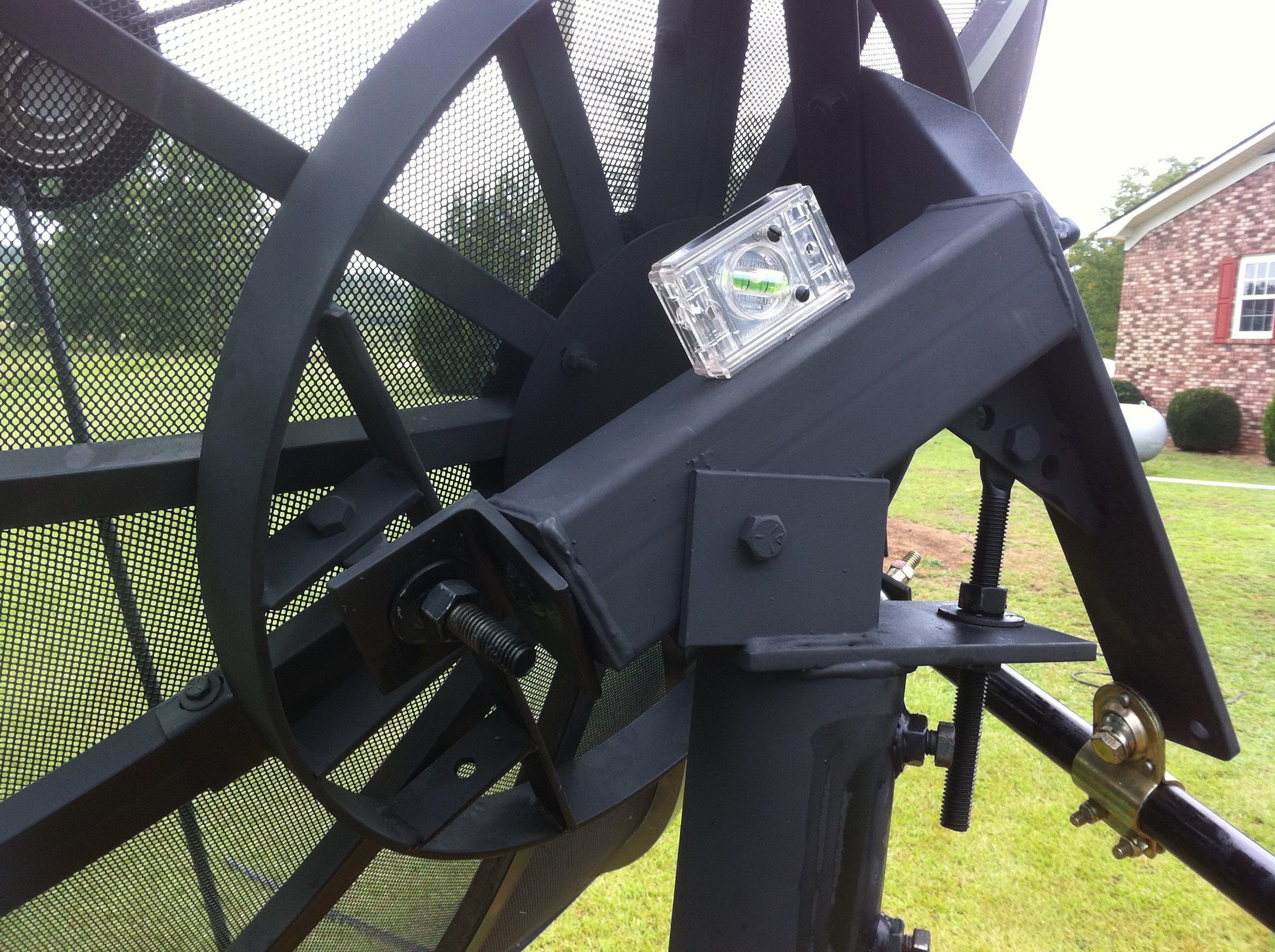

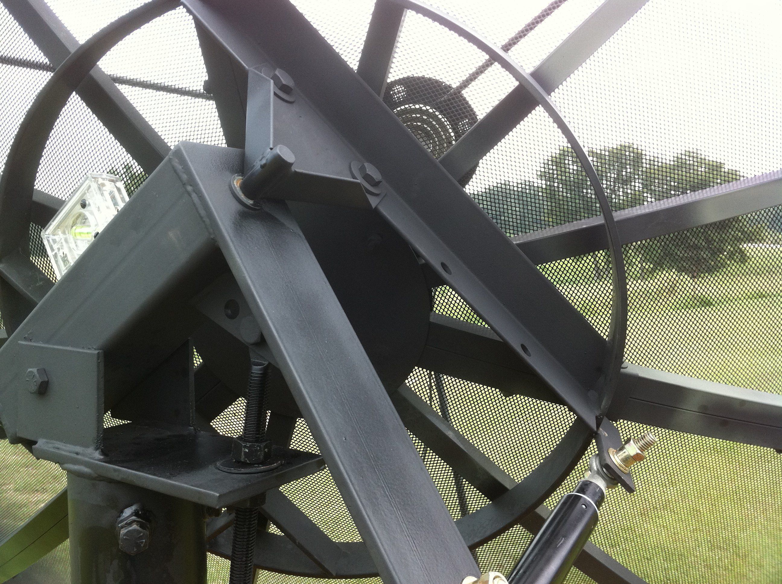

I am trying to set my dish on the arc using one of these arc sets. It appears that my elevation is good, I knew where to measure that. But I can't figure out where to put the arc set labeled "zenith" to set the declination. I have attached two photos of my mount. Can someone please help me to know where to put the arc set to set the declination. Thanks

So where did you have to place the ARC set labelled Zenith. Someone may benefit from your answer in the future. A picture will be fine too. :D
You can see it here..
attachment.php
My dish has a hole in the center, so stuck it on the bracket directly behind the center of the hole.
Sorry for the late relply, I finally figured out that you put it in the center plate of the dish (if your dish has one).
