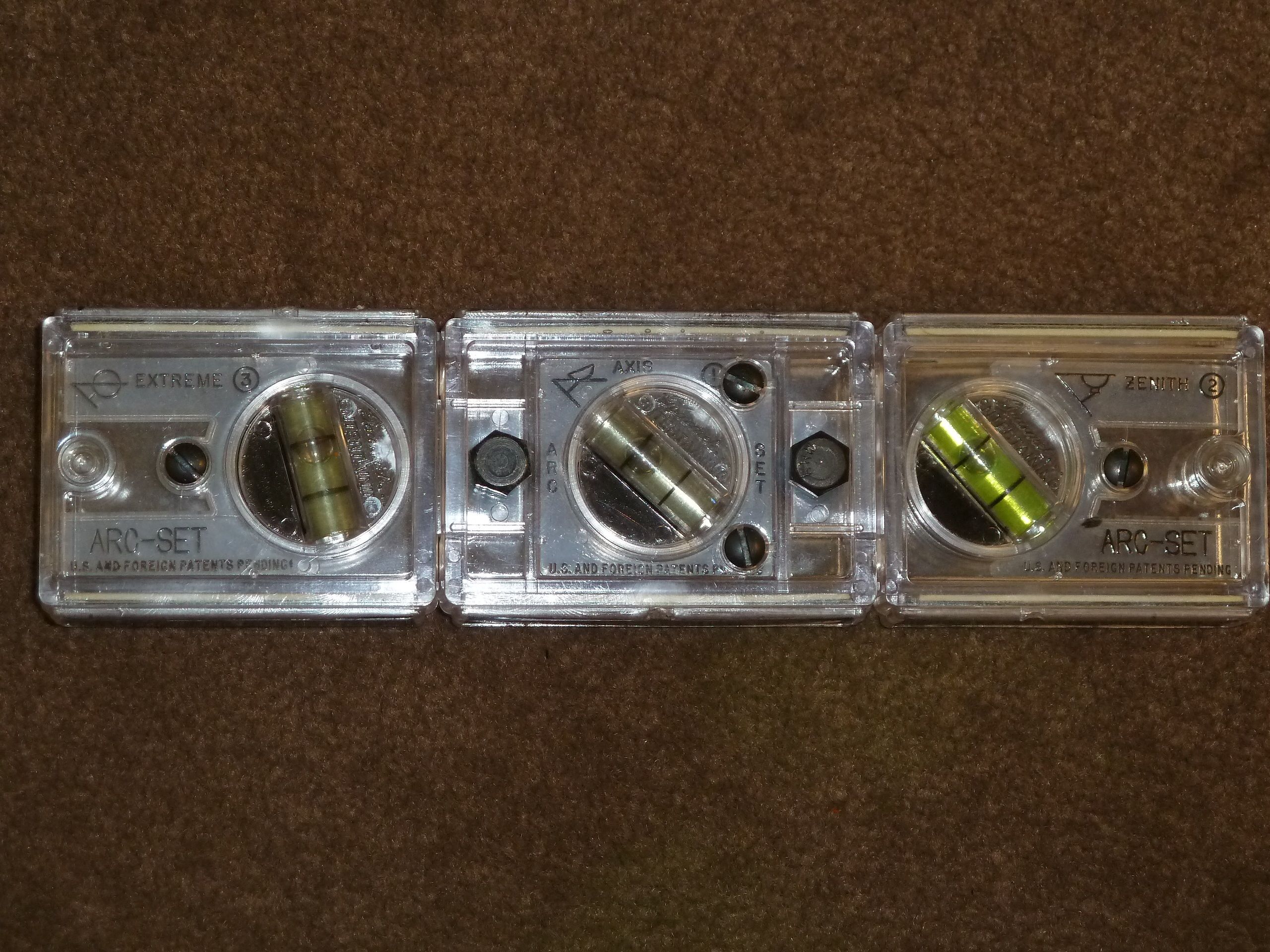

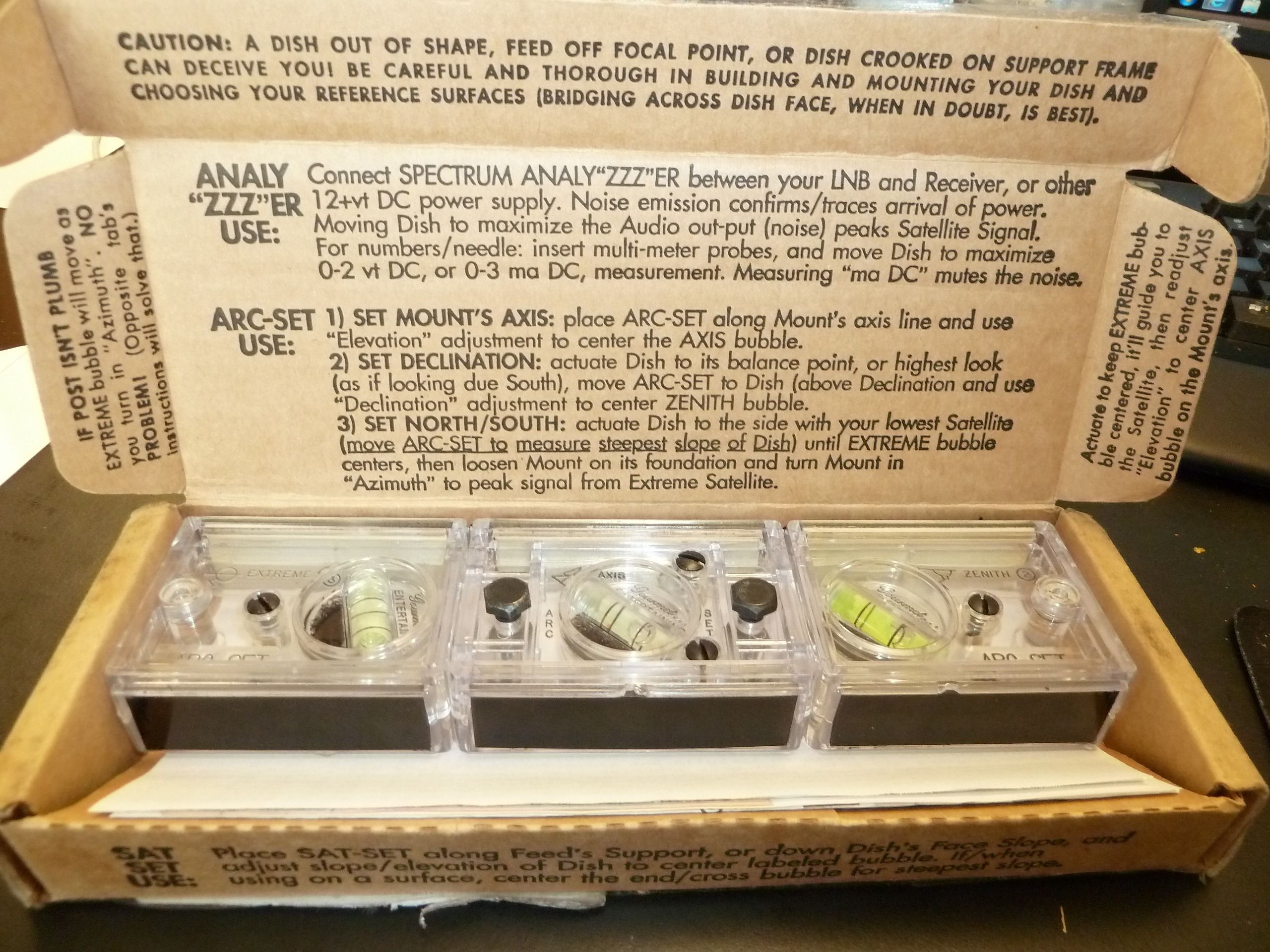

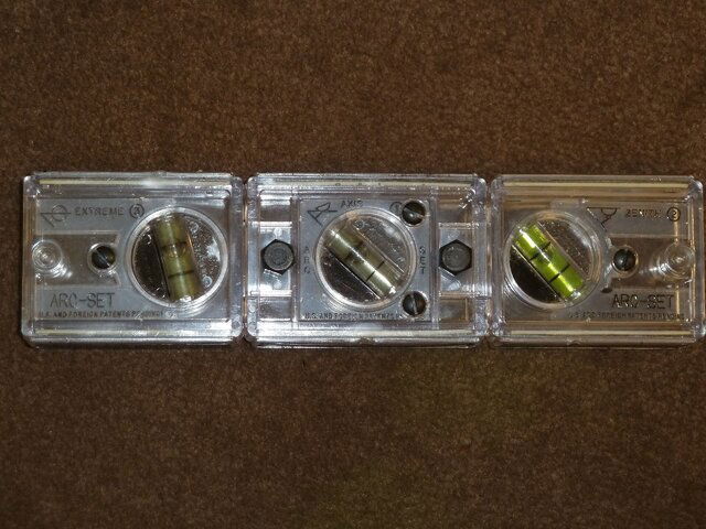

So today (after being told for the past year from a few Old Timers) I ordered an ARC SET from Jim Roberts of Gourmet... ENTERTAINING.
My condolances... Knowing what I know now, I would have never gotten an ARC SET. I bought one like 10 years ago, used it to set a couple of my dishes, and put it back in its cardboard shipping box and set it on a shelf next to my TVRO books/other tools. I looked at it about a year or two ago when I was thinking of maybe using it to check my dishes. One of the three bubble vials had cracked and the liquid seeped out or evaporated. The other pieces of the arcset felt fragile and looked aged. I emailed Jim to find out if he warranties or stands behind his products and no response. Obviously once he makes the sale, he doesn't care what happens to his devices. I bet your ARC SET will be good for maybe 5 years and then it too will start to crack or deteriorate and become worthless because of cracked plastic due to aging. Did Jim even get back to you - i.e. fulfill your order or maybe tell you he isn't selling those anymore? All you need is the satfinder (what I got when I gave up on the ARC SAT replacement/repair possibility) or I think you said you had a super sat buddy. That meter that can lock onto digital signals and give you s/n or BER and a working knowledge of the steps of putting a C-band dish on the arc is all you need and that meter works great for me and touching up all my dishes on a yearly basis.
Got my Arc Set in the mail yesterday. Haven't used it yet. But I was impressed with the build quality of this thing as well as the shipping box which houses the instructions for how to aim your dish. The plastic is heavy plastic with all the logos and words on it engraved into the plastic. This is no off the shelf item that has been modified to work for aiming satellite dishes. This was crafted to do this one job.
The device will be fine for a few years, but as it ages it will start to yellow and possibly develop minute cracks and if the vial plastic cracks, the liquid will seep out or evaporate. Since I have a satfinder meter now, no need for an ARC SET because I understand the reasoning of the steps of setting/repeaking a dish on the arc and using my satfinder to dial things in for maximum signal strength.
The material sounds not too good. Did you by any chance keep yours in a dark place for storage?
Well today I broke out the Arc Set too and all I can say is WOW, this thing works!
By god this thing worked and worked well! Setting up the dish only took a few minutes, I wish I would have purchased one of these years ago!

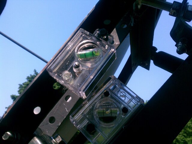

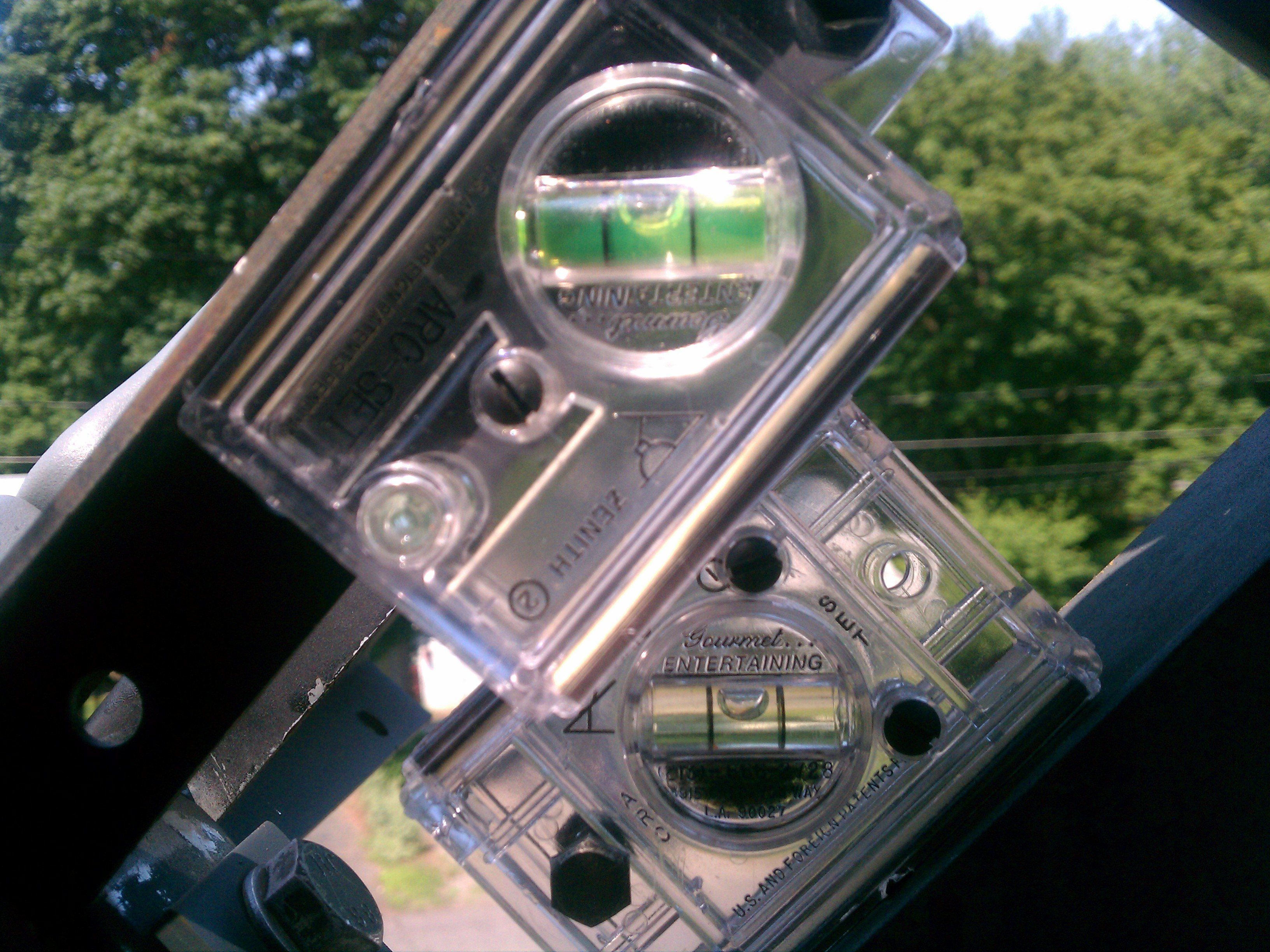

You dont need to know any number such as your elevation, your declination or anything like that at all.
First put one of the units so you can set the declination. Keep adjusting until the bubble is in the middle, once its there stop.
Now attach another one to the back of the dish and move your dish to the center point. Now adjust your elevation until that bubble is in the middle...

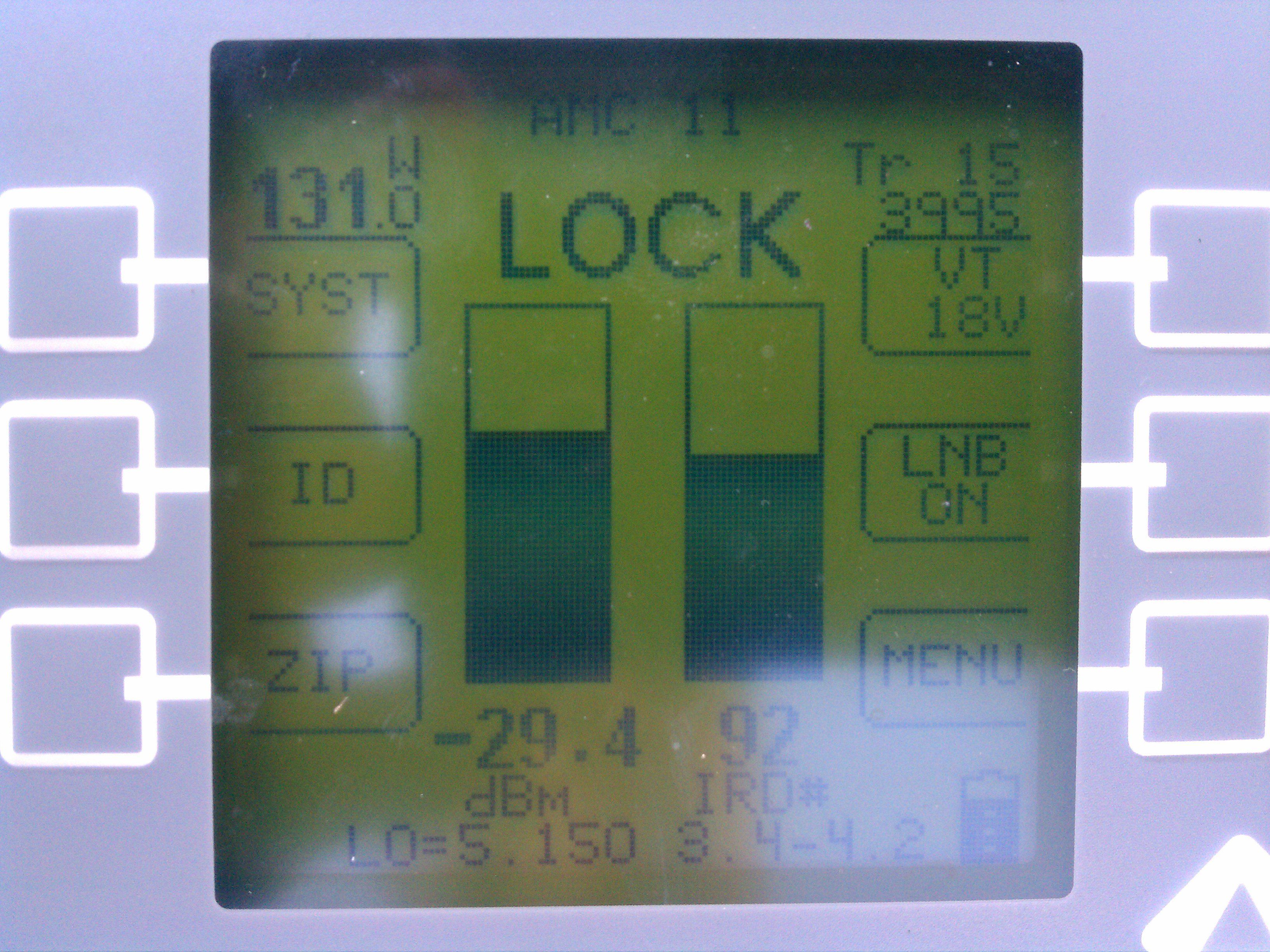

Now use your motor and move the dish to the furthest satellite you can see for me it is 131. I took a piece of sheet metal I had and placed it in the back of the dish so I had more area for the unit to stick to. When the motor was at 131 that bubble was in the middle and I had to turn the dish on the pole just a smidde then boom looking at my meter I had signal! I then got on the ladder and adjusted the LNB skew and pushed it in and out until I got the highest signal possible then locked the LNB down. Now the proof in the pudding was I moved the dish to 91 degrees and when I got there I was locked on the satellite and had a nice high signal.
Signals that were in the 40's or 50's were now in the 80's... some in the 90's!

Here are some photos. :)
Again worked GREAT and no needing to know any numbers.
