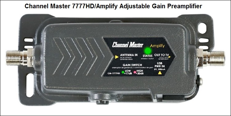

I like the CM7777HD Amplify. It has high and low gain: 30 and 17 dB.

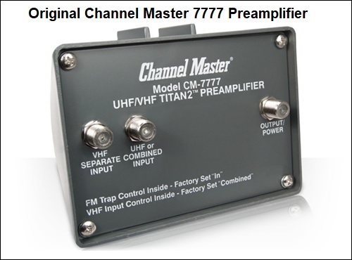

The original 7777 had two antenna inputs; one for VHF and one for UHF. That was my favorite preamp.

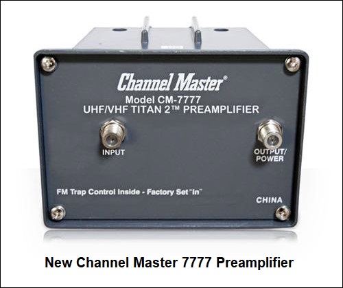

It was replaced by a 7777 that only had one antenna input.
That is the preamp that freeisforme shows in his attic photo. Its gain was stated as 30 dB. CM received many returns. Some users had high signal levels which caused overload. Also it wasn't very reliable; it failed soon. CM changed the design to 24 dB gain, but they didn't change the printed specs.

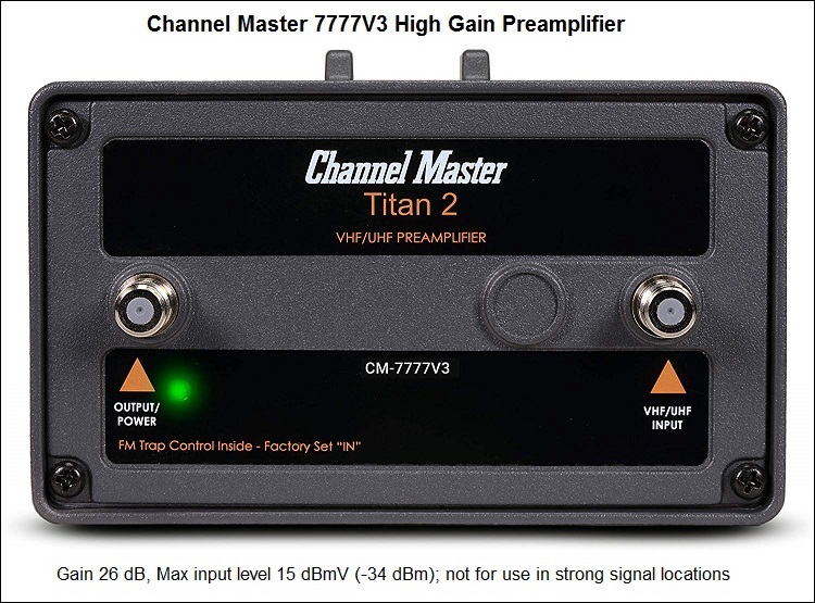

And now there is yet another 7777:
Well, that IS confusing!
