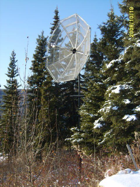

Here is my 12' dish, 20 feet off the ground on a free standing steel pole. It is heavy well casing from a used steel yard, telescoped with 3.5" OD schedule 80 pipe. Hole was about 4 feet deep, with a lot of concrete in a large hole. Can't remember how much. As strong as it is, it still wiggles a little bit in a good wind. ENough to make a weak C band signal twitch a little.
