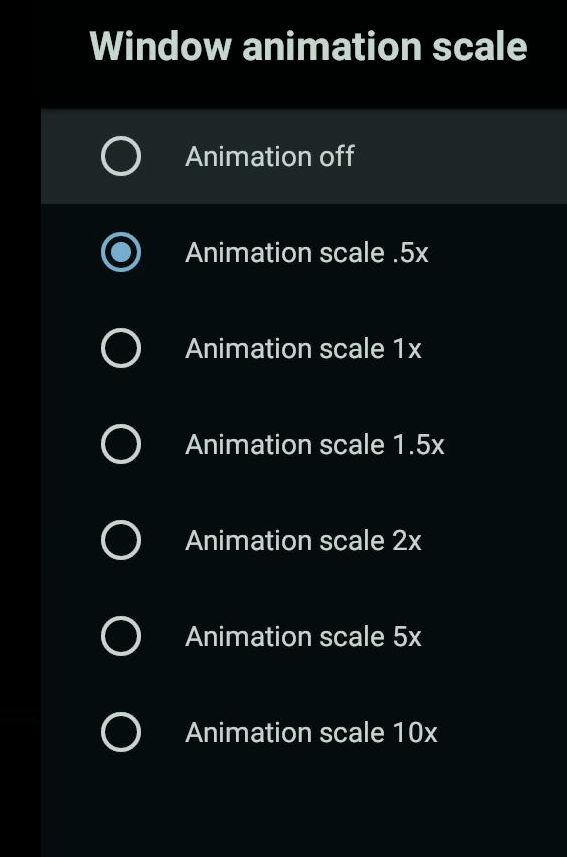

Can someone post what the default settings for 4) under 2) Speed fix above?
Default Settings attached
