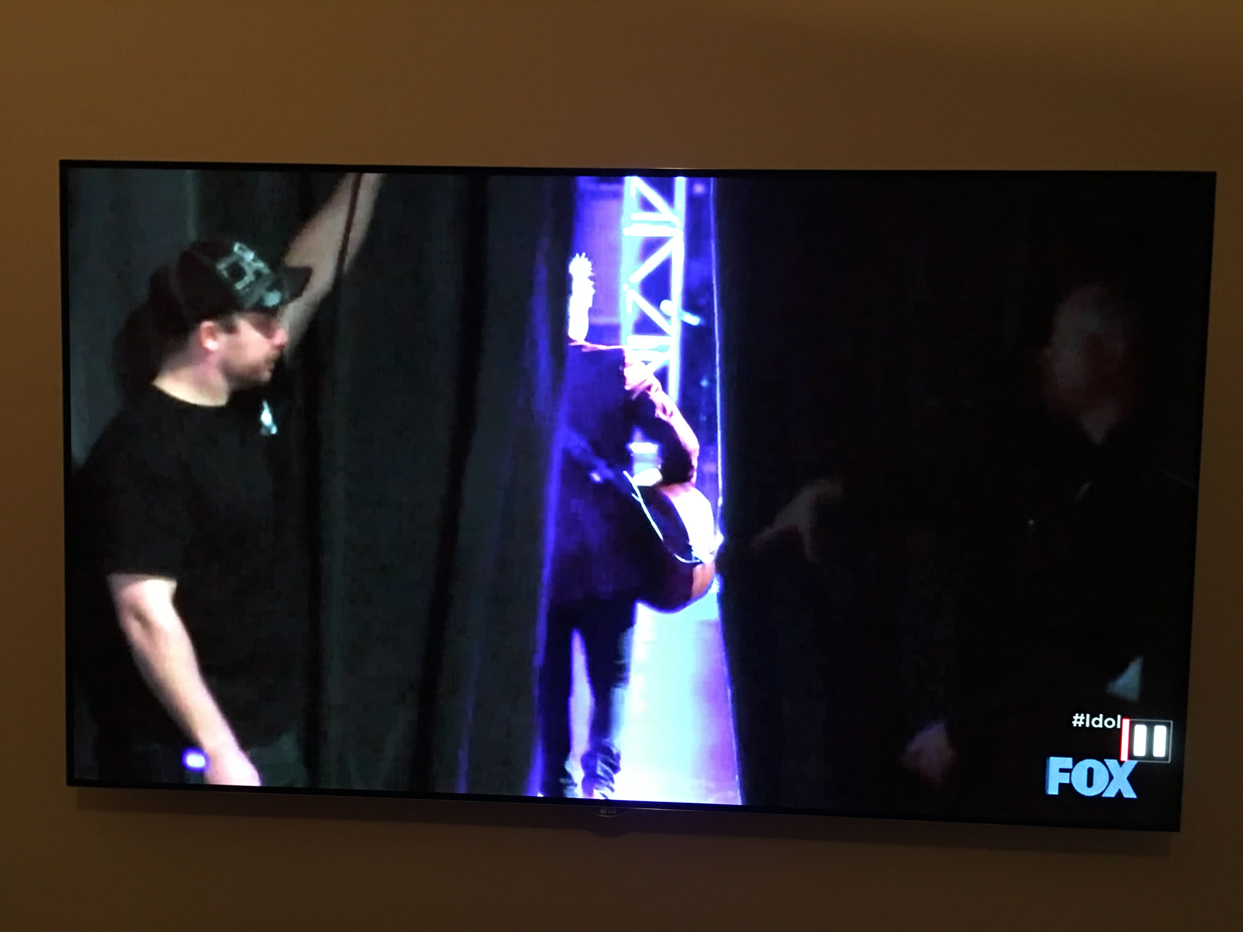

Here are some pictures.
This is on an LG 65EF9500 4K OLED

Looking at the picture, that looks more like a power issue then anything. Would love to see it hooked to a power conditioner and see what it looks like then.
