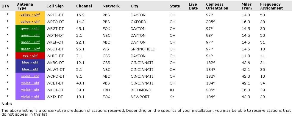

I live in ohio zip code 45381 and I want to replace the old antenna on the roof that has some of the vhf pieces broke off.
Some of the stations out of dayton have a 90+ signal strength, but others only have a 60+. I also wanted to pick up some of the sations in cincy which is 40+ miles away.
What kind of antenna do you recommend for the best possible reception, this is for the HD channels of course too, but the other TVs are regular.
Thank you
I would look at a few of these if all you want is the Dayton/Springfield channels:
$25 Channel Master CM 4221A
$46 Channel Master CM 4228
$19 Winegard PR 4400
$39 Winegard PR 8800
$40 Antennas Direct DB2
aka
$40 Terrestrial Digital DB2
$25 Radio Shack Model: U-75R / Catalog #: 15-2160
www.solidsignal.com
or your favorite place to shop.
