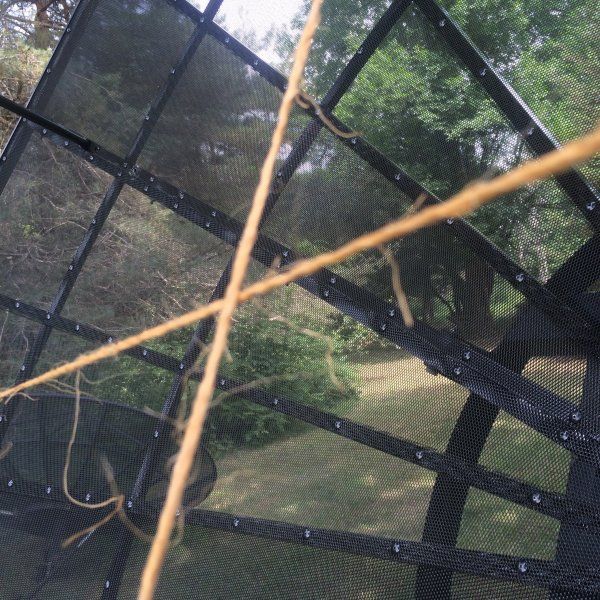

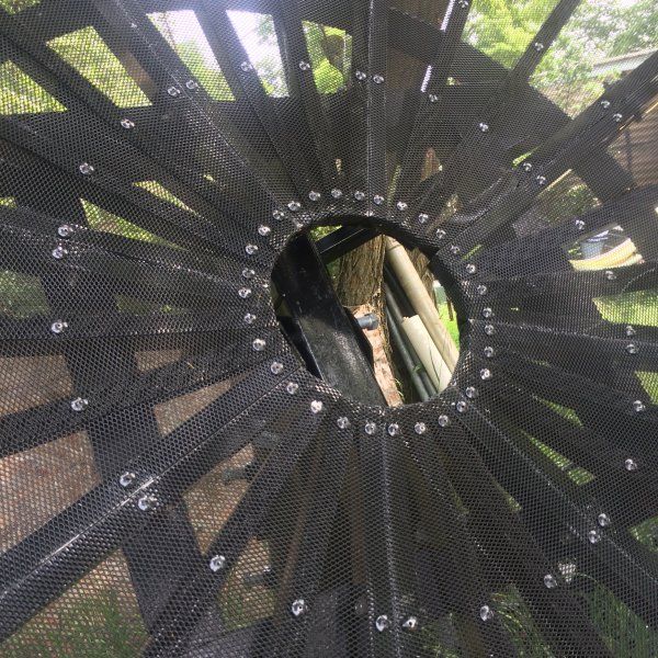

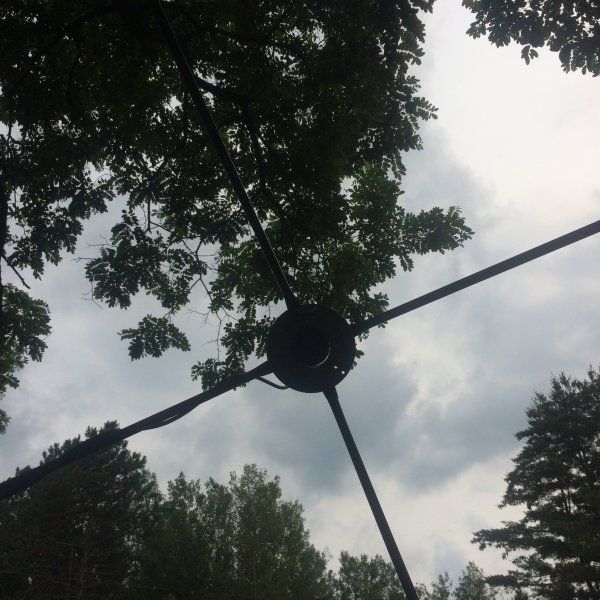

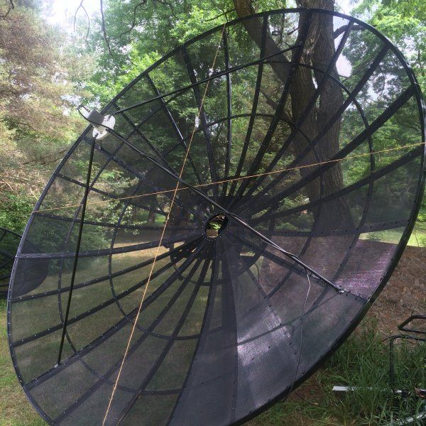

Judging from the pictures of the strings, you got the dish assembled as well as possible without the center plates. The plates are added support and they help bring the ends of the panels together even all the way around. I've seen a lot of installs where they were left off and the dish performed like a pro. Nice job. Too bad you didn't have a better view of the sky from your location. Pretty much everything we watch is on 4 satellites, all high in the sky, and with a little effort, you may be able to clear a path to them.

Thanks for noticing my job didn't take to long maybe 2 hours. Goes good when ya know how I guess. She's doing her job that's for sure
