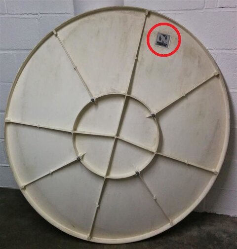

But why do you call it Prodelin? I have exactly the same dish and it is labeled Echostar. Working area 1214 x 1348 mm and offset angle 22,7*

Think Echostar is a rebranded Prodelin, Many were BITD. Even BUDS.

When I first got it, I got a lot of responses from the forum members here and did aditional research and found out it was a Prodelin, but I don't remember anymore what pointed me to that conclusion.
I just looked and some info I saved about it on my hard drive and found that it is a Prodelin 1130 series. Googling that I learned that Prodelin is now called "General Dynamics SATCOM Technologies".
