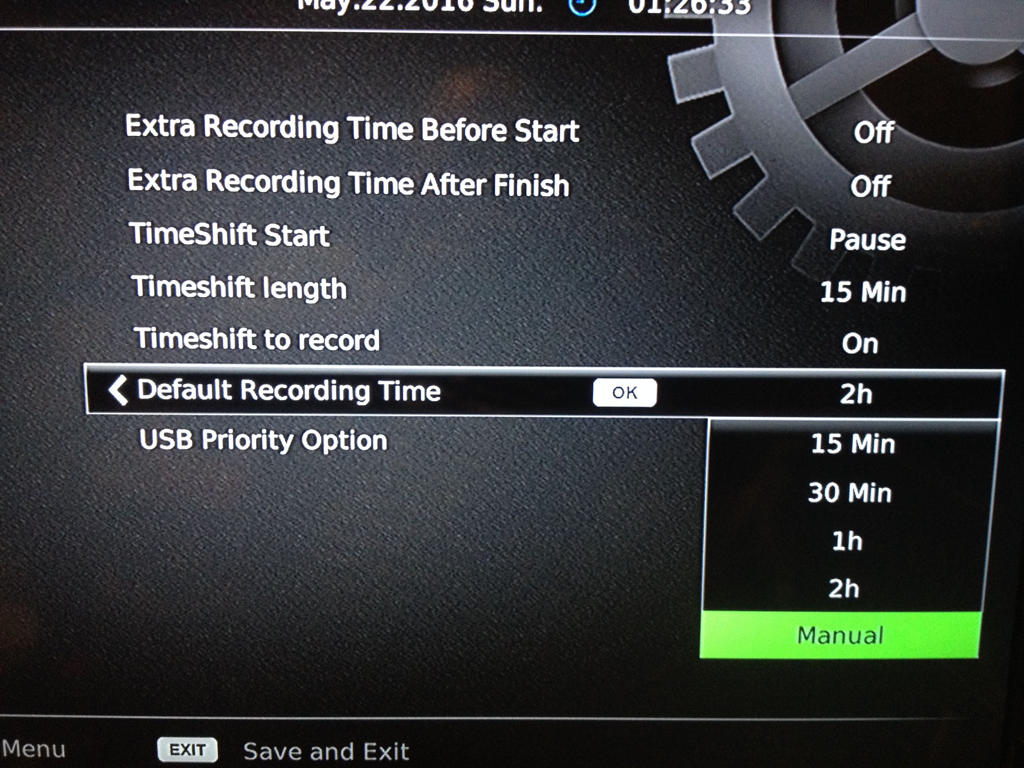

Ok Before when you hit record it would pop up with a box allowing you to input for how long. Now there is no input box it just starts recording. How do you set a stop time for an ad hoc recording?
Press Menu on your remote
Choose Settings
Scroll down to Configuration, Recording Option
Choose Default Recording Time
Change to Manual
And that should do it...
should now show the pop up box when you press record after changing this setting
