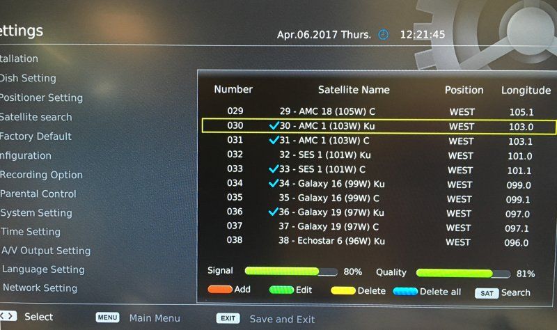

Haven't been on here in a while, is 1372 still the latest firmware? Also I'm having issues with my HH90 motor. When I select 125w Ku it goes there but doesn't stay, goes all the way back to 0 position then returns to 125w and stops. I get weaker signals from this satellite, so I'm wondering if that may be causing it to act that way. Everything below 125w to 77w Ku seems to be fine. Haven't been able to get anything below 77w where I live, or above 125w, but I think I may have a little blockage due to being in a low lying area, thinking about installing the dish on top of an old 36ft. radio tower to see if I can get better reception.

I discovered my HH90 problem, bad cable... and now I can pick up 58w to 125w with most averaging between 85% to 98% signal quality, but 103w's NBC/COZI feeds being the weakest signals averaging 10%

Same problem here. New satellite and normal skew, still very weak NBC & Cozi. 90cm dish. I assume I need a larger dish to bring in these DVB-S2 signals?

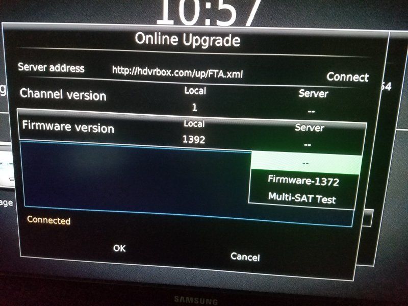

Great news, Team. We now have Multi-satellite scan enabled. If you are on FTA firmware, just go to Menu > Version > Online Update and select version 1392.
Please report how it worked for you.
For manual USB update, the link is here: http://hdvrbox.com/up/gs/multi/usb_update.bin

I would like to know the difference between the firmware file and the multi-sat test. Also the online version is lower than the usb file supplied.
Multi-Sat test adds ability to scan all selected satellites at once, where the receiver will send Diseqc or USALS commands to move your dish and scan all the satellites you have pre-configured.
This firmware ads additional corporate features like the automatic BISS key updating. (we have several corporate clients that roll keys)
There is minor improvement in the IPTV and Application support. We are also going to introduce option of Glorystar starting with IPTV list instead of satellite as well as Only Adventist channels if customer wants to enjoy only Adventist channels and not all the Glorystar channels in their main channel list.
Steve, were you looking for a particular feature?
No, but regarding IPTV, do you happen to have a glorystar IPTV channel .xml file? I would like to customize it. The reason I'm asking for the glorystar IPTV channel list, is that ~20 channels do not work, and I do not need the spanish, french, and radio channels.
In the non-glorystar firmware, you should remove all of the glorystar locks and IPTV defaults.
