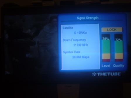

Well, I'm Dallas, and I now get it at between 70-80% signal quality after getting my dish peaked. Thats on my Fortec lifetime ultra... using an old Dway 1 meter dish with Dway LNB. That's on my motorized setup. To get that signal level I had to make a few adjustments and accept signal in the 70% range on my TS satellite (IA5) versus the 90% I was getting on several transponders.

Well... now I get to eat crow... about a hour after snapping that picture and bragging on how well I was getting that TP in, I started getting only 50% again.
Fortunately, I was busy so I didn't go and mess with it....
The little light bulb came on about 10 minutes ago.... notice the Transponder number in my blurry picture .... I wasn't actually on the TUBE transponder, I was on one of the stations on a different transponder rebroacasting TUBE... whoops! :rolleyes:
