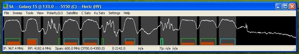

I'm seeing the beacons on my Broadlogic Spectrum Analyzer.
Have they switched over to Galaxy 12 yet?
The signals are looking very strong tonight.
