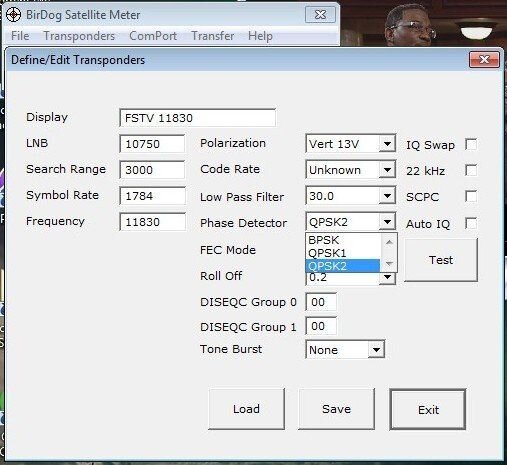

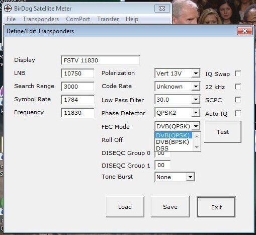

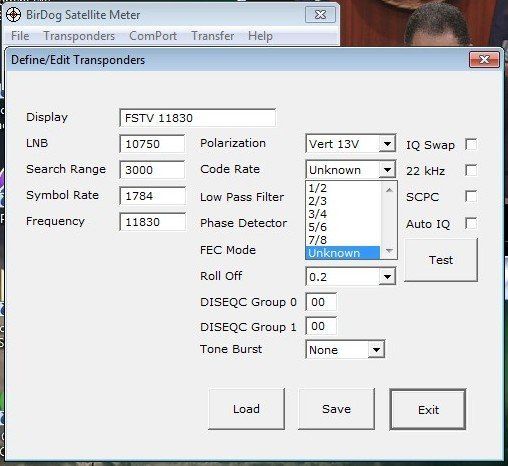

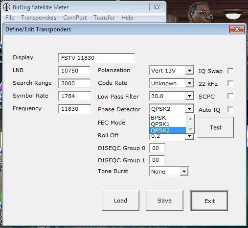

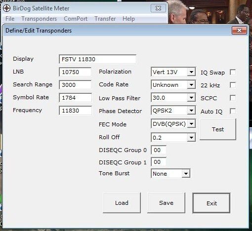

My birddog meter is one of the first models, it doesn't have a spectrum meter in it, it's not the USB model.
I was trying to configure a file to upload into it for 11830 and 11840 and there is no provision at all for anything except DVB-S and QPSK. The FEC options are very limited too.
I don't see any way possible to make either one of my two DVB-S only meters find the S2 signal. :(

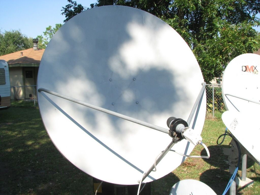

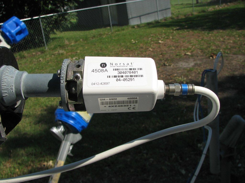

The dish I am using is a 1.2m Andrews and the LNB is a Norsat.
I used the Openbox to find and fine tune FSTV on 11840/1784.
I adjusted the tilt, skew and side to side until I got the highest signal I could. (The OBS9 does not have a meter for BER and my handheld meter doesn't tune S2 so setting BER isn't possible for me with what I have on hand.)
On their tuner the channel comes in great. Yay! Right? Maybe not.

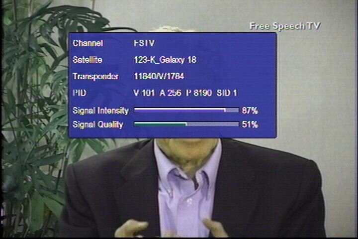

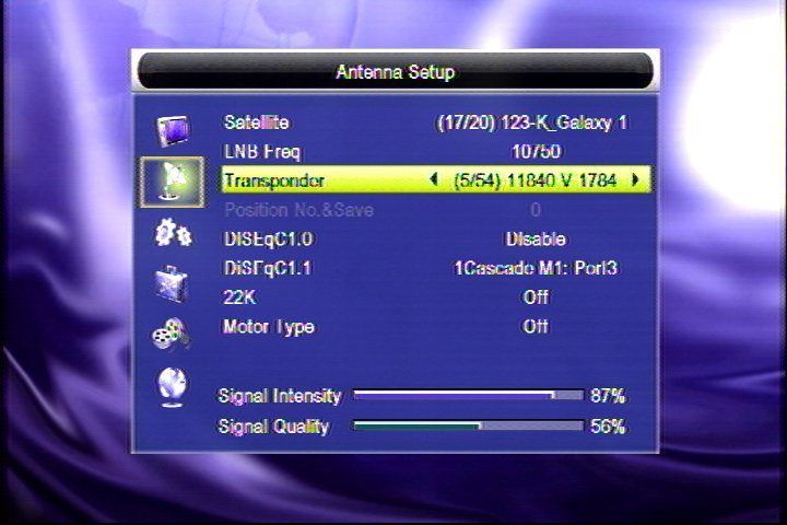

I took some screen shots of my folk's OBS9 tuning in FSTV. However the info button doesn't get you any technical details like if it's seeing an S2 signal, what the FEC is or stuff like that. All it gives you is the frequency and the symbol rate. :(
