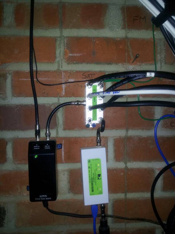

I'm surprised your setup works at all the way it's connected. Connect it the way Jimbo said and you should be good to go.

His is set up the way I set mine up.. with the power injector before the splitter. There's nothing wrong with the way yours is done (there's actually three ways it can be done.. the way you have, the way I have, and you can also install the power injector behind whatever receiver is on port 1. This is done if there is no electrical outlet near the splitter). The power injector only sends power to the LNB, it doesn't have anything to do with the downstream signal, which is why it doesn't technically need anything connected to the IRD port. As long as the "Power to LNB" port on the power injector is connected to the red port (notice the line between port 1 and the input that says DC Power Pass) its fine.I know Dish, but not Directv (obvious I know based on my stupid questions lately).
So my line from LNB is coming into splitter and yours is coming into PI? If so, is it going into the power to SWM port or Out to IRD port?
Where is your out to IRD connected to?
Jimbo said:I'm still not sure how its all working.... the hr34 & 31s require the PI to SEE the lnb, thus the PI supplys power to the lnb. .. so, without the PI output being connected, I dont know how the recvrs are seing the lnb, unless the Repeat Sat Set Up was never ran and its actally Not running off the SWM somehow.
Again, one of the other guys that do this regularly would know better, i would leave it the way it is till you hear from one of them here, or have a different D tech out to verify it, seeing it IS working.
Its connected correctly. The SWM output is running into the power side of the splitter and the other side if the PI is terminated so its not powering a receiver so, yes its done kind of oddly but it will work with no issues
JerseyMatt said:His is set up the way I set mine up.. with the power injector before the splitter. There's nothing wrong with the way yours is done (there's actually three ways it can be done.. the way you have, the way I have, and you can also install the power injector behind whatever receiver is on port 1. This is done if there is no electrical outlet near the splitter). The power injector only sends power to the LNB, it doesn't have anything to do with the downstream signal, which is why it doesn't technically need anything connected to the IRD port. As long as the "Power to LNB" port on the power injector is connected to the red port (notice the line between port 1 and the input that says DC Power Pass) its fine.

JerseyMatt said:That's where all you guys are getting hung up.. the PI does not "power" receivers. Its sole function is to power the LNB. It has nothing to do with the receivers.

I was hoping you installers would pop in soon ... I only knew that I had mine set up with a line from the PI to the splitter, so the PI Out was being used.
Any ideas on what may be causing his issues then ?
Sounds like a faulty LNB or a power issue of some sort. I can't see 2 receivers being bad and he said both was acting the same. Could even be a bad line running to the LNB from the splitter. Frequent loss of signal but not enough to disrupt anything except guide data
