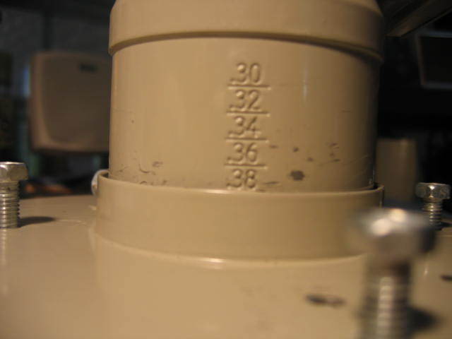

So in my original thread it was posted that the focal length of my dish is 33.75". So I would need to measure 33.50" ( or is it 34"?) from the center of the dish to my scalar ring?

You would need to measure 33.50" to the point of the wave-guide nearest the dish (the inside part of the feed-horn that slides into the scaler ring).
Do not measure that distance to the scalar ring itself.

When I inserted the waveguide there defintely WAS a sweet spot for signal, and that's where it is, regardless of the distance printed on the side of the waveguide.
Stogie,
I just re-read one of your earlier posts. The markings on the side of the wave-guide are the F/D ratio settings.
Set that first, then the focal distance, then in and out with the whole assembly for fine-tuning.
Fred

Okay, I think I followed that. I am going to take the whole thing off the dish, set the f/d, re install it on the dish, and go from there. Thanks. :up

Correct?
Then measure 33.50 from the edge of the waveguide of the center hub of the dish.

If your F/D ratio is .38, then you have it set correctly.
That is correct.
Fred
Its .375. there is no .375 marking...I didn't think .025 hundreths of an inch was gonna matter that much...anyway its blindscanning G11 now...the EWTN's were bouncing between 95-100 SQ. :)
