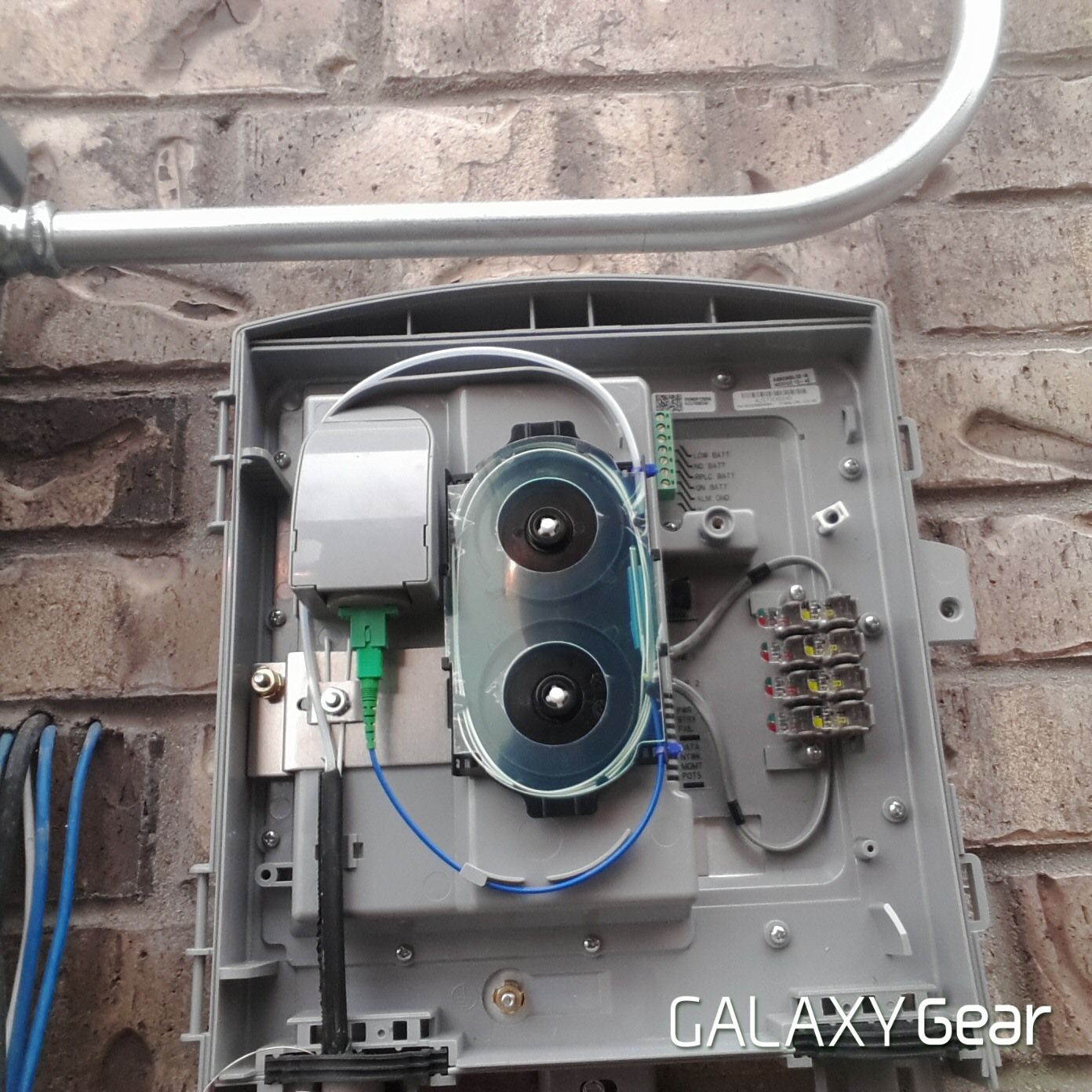

They add an ONT (Optical Network Terminal) on the outside of the house that translates from the fiber to Cat5e/Cat6 Ethernet which is what connects to the gateway.

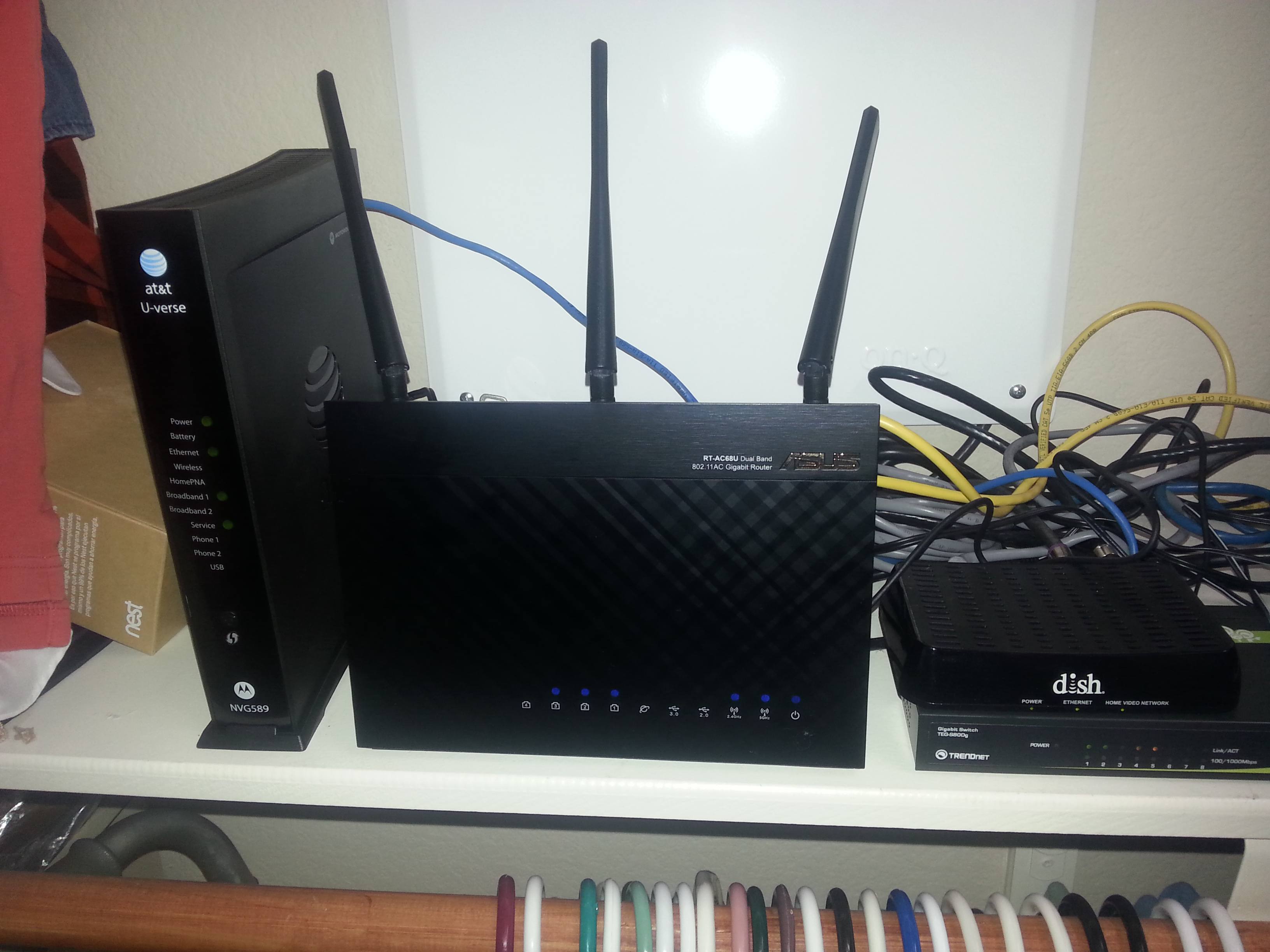

Then they have the aforementioned Motorola NV-589 Gateway device on the inside of the house which brings the internet and (if you have it) TV to you.
In my case, their radio is single band, and I wanted something better, so I upgraded my router to an ASUS RT-AC68U router that does 802.11ac as well as 802.11a/b/g/n.
Putting AT&T's router into a Passthrough mode takes a few steps that are nicely laid out on the AT&T Forums.
What you need to do is put your Routers MAC address into the PASSTHROUGH page on the AT&T gateway, and set it to DHCPS which has the AT&T Gateway assign the PUBLIC address it gets to your Router's WAN side. This makes things like DynDNS work.

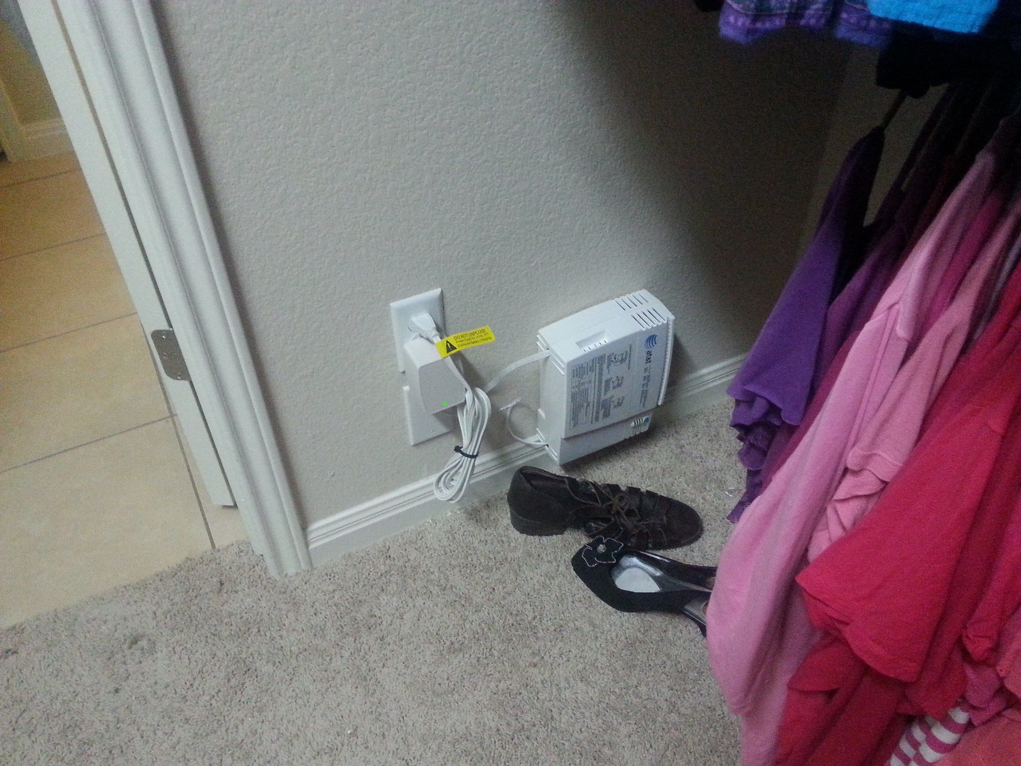

attached are pictures of the AT&T Power Box, The AT&T Router, my ASUS Router, and the ONT.
