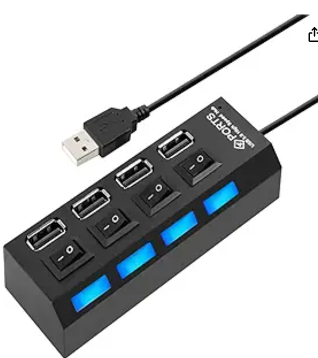

At Amazon. Looking at Bobby's WD. 2 TB is only $15 extra compared to 1 TB at $55. It makes sense to me, doubling the size.
Also a hub with individual on/off buttons. Only $15.
Do I get 'Go for it'? :D
Absolutely, I was only showing the 1TB because I have one. 2TB is a better proposition. That hub is an excellent idea. My hubs don't have on-off buttons but I don't see why it wouldn't be useful.

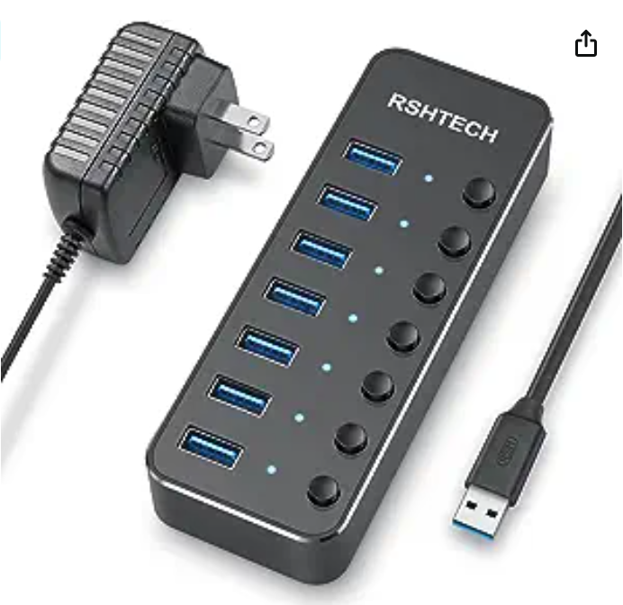

For #1, the numbers are assigned randomly so it will say External Device x connected where x is the device #. If one only had one devices connected, then it will always say 1. If you have more than one device connected, it will randomly assign the # each time from my experience which should still be a number between 1-3. With H358 and H362 versions of software, the x can be 4 but the problem is you will not see the drive show up in Other Devices as the software apparently cannot allow anything higher than 3 to show up. So what I mean by connected is assuming that you had a regular powered hub where there are no on/off switches for each port, every connected EHDD that has power and connected is considered one device so if the EHDD has a power switch, turning it off is the same as disconnected or you can use one of these which is what I think bookworm370 was referring to so you can connect as many EHDD's as your heart desires but only 3 ports should be turned on for the devices connected to it. I don't know if one can daisy chain USB hubs on a DISH Hopper 3 or not but for example, you can have maybe 70 EHDD's as you can probably put another of the same hub on each port and then connect EHDD's to it so in any case, what's considered connected is the port has to be turned on first and also the power on the EHDD is turned on if the EHDD has it's own power switch.
The above is $24.99 at Amazon product ASIN B08TT1ZK8G
View: https://www.amazon.com/RSHTECH-Expander-Aluminum-Universal-Individual/dp/B08TT1ZK8G/ref=asc_df_B08TT1ZK8G/?linkCode=df0&hvadid=647118588855&hvpos=&hvnetw=g&hvrand=17752310323818618456&hvpone=&hvptwo=&hvqmt=&hvdev=c&hvdvcmdl=&hvlocint=&hvlocphy=9031961&hvtargid=pla-1281146724450&th=1
So your assumptions is correct and that should work well because you don't have to physically disconnect anything, you just either need to be sure only 3 of the buttons are turned on as think of the hub as the master switch while the one on the EHDD if there was one would be secondary but in the later case, that would usually mean the EHDD has it's own power supply so it might be better to use the EHDD's power switch instead as that will turn off the drive as well and only turn it on when you need it to save electricity and wear and tear.

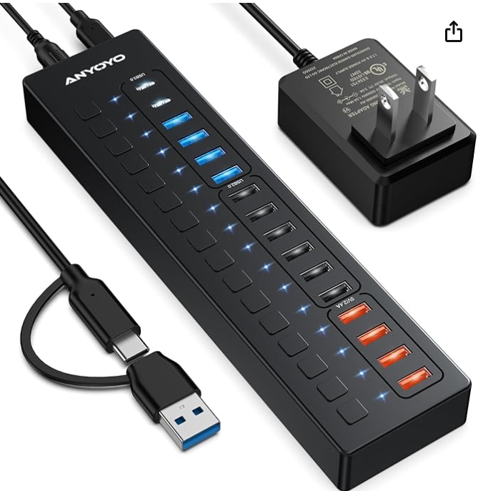

Here is one which is $59.99 but also has 16 ports (10 USB 3.0 Ports+4 2.4A Charging Ports+2 USB-C 3.0 Ports) just as a example that you can have more EHDD's than the DISH Hopper 3 supports physically connected:

As for the USB Hub mentioned, are the charging ports just for charging only or are they also connected with other devices for data?

The on-off buttons are useful because it will also help in not having to keep unplugging and plugging in cables as you can disconnect to the EHDDs using the buttons so if the Hopper 3 doesn't detect the drives, sometimes it requires pulling the cable and plugging it back in which may involve rebooting and if that still doesn't work, it will require disconnecting the cables first, reboot and then plugging it back in. With the on-off buttons, you would just use the buttons to serve as the connecting and disconnecting which will save wear and tear on the ports and the cables which would explain why I was actually looking for USB-A cable(s) with on/off switch to add in front of the EHDD USB cables.
That is why I said "I don"t see why it wouldn't be useful." I was acknowedging that there could be positive uses for it.

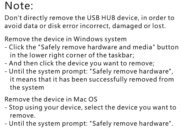

From the RSHTECH hub shown above manual:
arlo - Yes, don't treat the on/off switch for safe removal but it's more of a way to disconnect the connection to the port in general without plugging in and unplugging the cable or basically without wearing down the cable or the port which was what I was saying. So if you do use it, it's the same effect as pulling the cable when you put it on off and plugging in the cable when you put it on on as a better way to describe it.

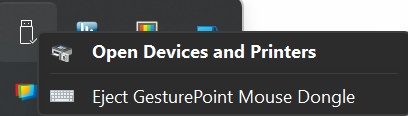

The on/off buttons are similar to the on/off switch to turn on and off the lights in a house so the light bulb can be in the socket or not but until the power switch is turned to on, there won't be electricity going to the light socket. Same with the on/off switch on a USB hub so with the power button in the off postion, that is the same as a EHDD that was not plugged in even if it was plugged in and when you have it as on, basically it allows the signal to reach what is connected to the USB port. or think of it closer to a surge protector where there might be a master switch. If you turn the master switch off, nothing plugged in is going to get any power but in this case, they are just giving one control of the power at a local level so each port can be turned off instead of it being on normally without the on/off switch. The older USB Hubs with individual on/off switches had a different type of power switch and not the push buttons like this below which might make more sense:
The select safely remove hardware icon is a software level thing and not hardware. There were several builds versions of Windows 11 Beta Insiders a few weeks ago that was completely missing the Safety Remove hardware icon a few weeks ago before it was fixed. When that bug existed, the only way to get that icon was to either plug in something else that was USB that can be removed or in my case, my mouse USB charger/receiver when taken out and plugged back
in would bring back the icon.
