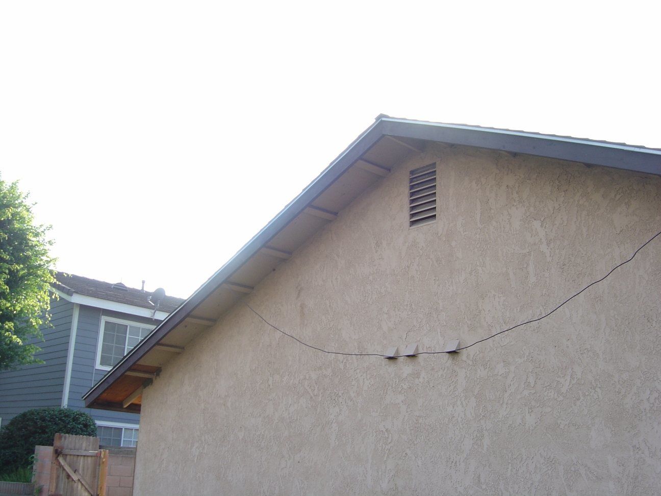

The first pic is the overhang the 'lords want showing the tree, the tree is currently as tall as the tip top of the roof as far as I can tell since I don't have a ladder.

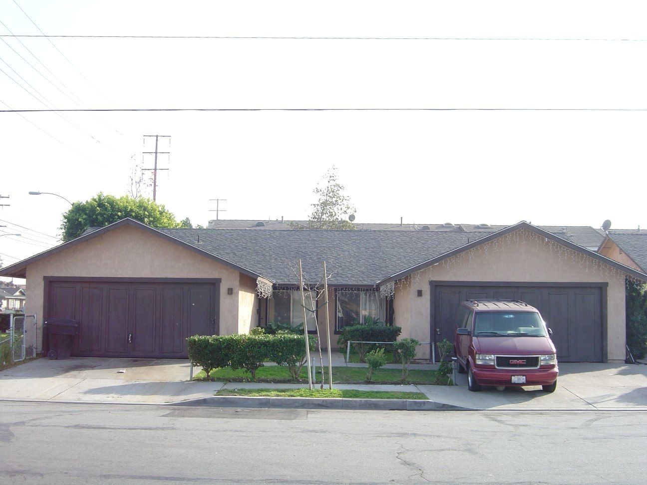

The second pic shows the solution my landlords want to do with the cable, basically run it in that attic vent on the side. Notice the "professional" wiring done by an Adelphia installer. Also shows part of the apartment complex.

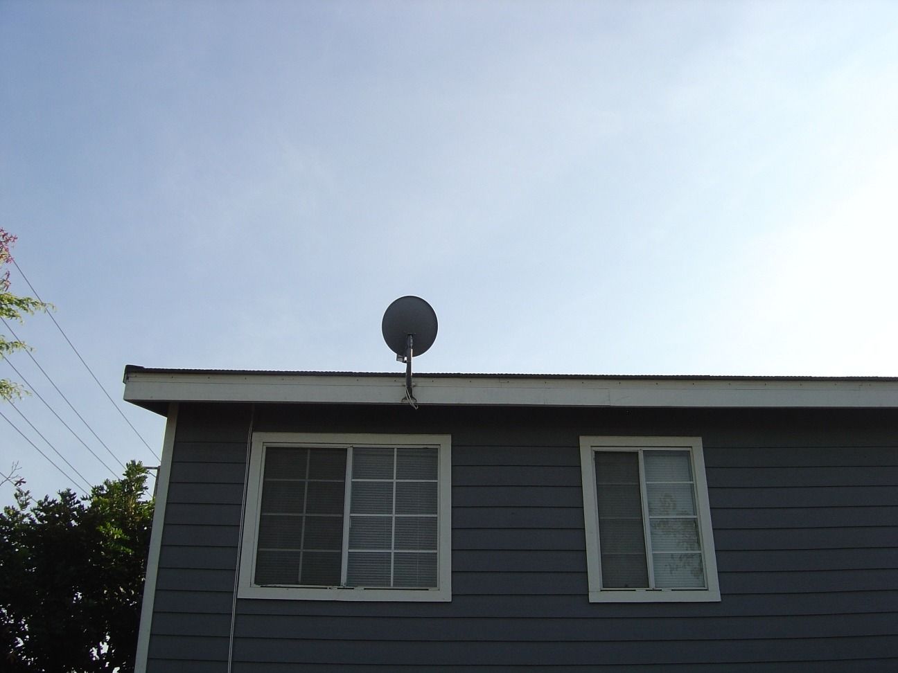

The third pic shows the apartment complex complete with a DirecTV dish installed. This complex is the 2nd obstacle I have to contend with.

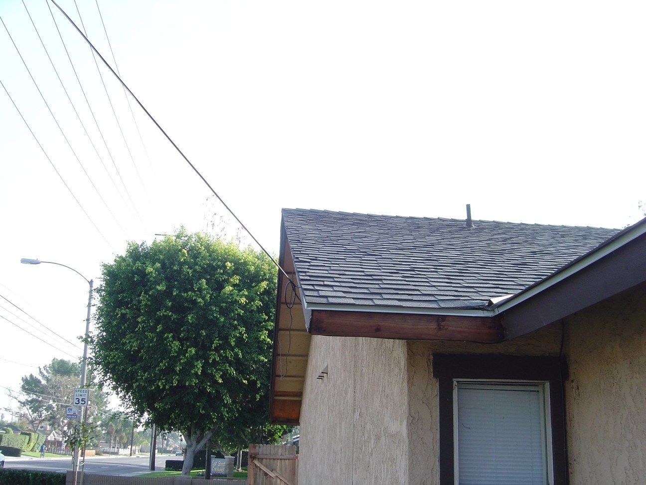

The last pic shows the duplex, I live on the left side of it. The next duplex you can see another DirecTV dish installed on the overhang of the roof, I didn't take a picture of upclose but the cable does lead into the attic vent on the side.
What I would like to do is have the dish installed on the right side of my duplex. My neighbors would have no problem with the idea. So I'm willing to finagle the landlords to go in that direction. But if that fails, is there any other way I can get a dish installed.

Looking at the picture, the tree should not be a problem. Remember that the singal from the satellite comes from 22 degrees above where the dish appears to point. I've seen some dishes that appear to point in a neighboring house's window! :)

If the landlord said the only place that you can put the dish is on the fascia at the corner right where the tree is then yes you stand a good chance of a problem. I looked at all the pics and comparing them along with the other dish's in the pictures and the location I can see that the back of the house faces south south/west. Talk to your landlord again and ask him if it would be ok to have the dish mounted further up the fascia towards the peak, this would still keep it on the side of the house and off the roof, placing the dish down at the corner will either have the tree blocking the 110 signal probably or with a breezy day you will loose 110 and 119 sporadicly but enough to cheese you off.

Sorry for the confusion, but it's okay for me to have it on any part of the overhang. I'm not limited to bottom corner, so if the top is ok, I'm gonna go ahead and go for it.
