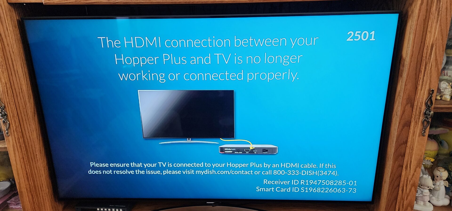

I am removing my H+. Unplugged H+ & H3 electric cords and plugged HDMI cable back into the Hopper. Plugged Hopper electric cord back in. Got the start up screen few minutes later got this screen and nothing else. Should I reboot her again?

Just now got the startup screen again. Time will tell
