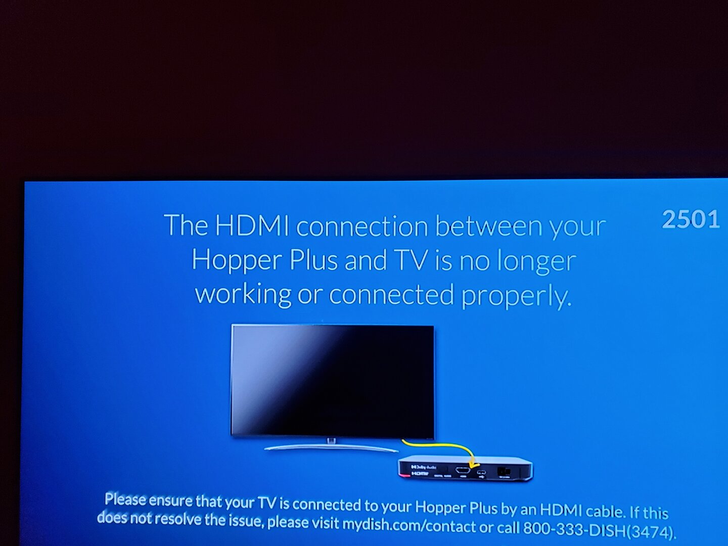

I'm getting a blue error screen when do this that tells me that the Hopper Plus must be connected to the Hopper 3 if I try and put humpty dumpty back together. Hard to say at this point if I have a Hopper 3 or Hopper Plus with power issues.

Is this after you rebooted the Hopper?
Yes, it comes up about ten minutes into the reboot of the Hopper 3. Doesn't let you past that screen.

Sorry for all your headaches. You got me worried now. I may not remove my H+. Did you remove the H+ USB connection & remove the HDMI cable and plug it back into the Hopper?
Yes, completely powered down, disconnected, reconnected the HDMI back to the Hopper. Everything is working again now after so many reboots. It all started when I tried to update the software. I've been getting the software update messages every day, but it never goes to the newest release. When I tried to go into the menu today to upgrade, it started the process of dozens of consecutive reboots. It would land on the starting channel, go a few seconds, freeze, and then reboot again. Now I have no idea which device is failing, or is this just some sort of update failure and both devices are fine?
