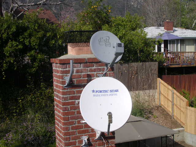

Yes the Dish 1000 works on the west coast, as long as it doesn't rain very hard:D I went with a 2 dish solution. Signal strenght went from the mid 60s to the low 90s.
