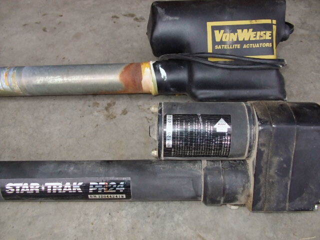

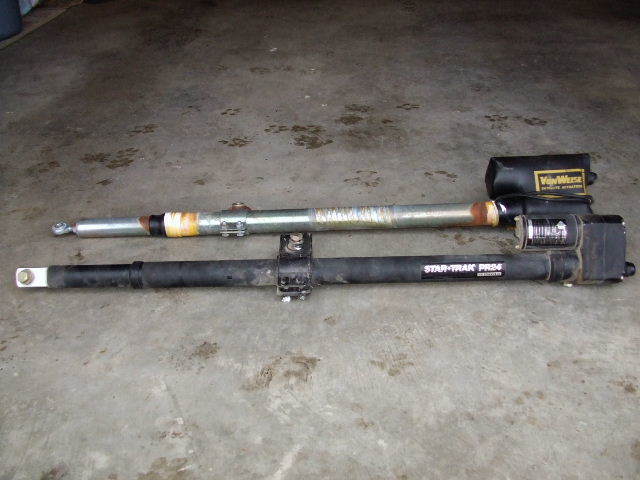

4- I have a Star Track PR24 and a VonWeise same same size to move the dish wich one is better to use with my dish?

What is the Star Track PR24? also the Von weise motor should be fine, 24" would be good.

an the Von weise much better actuator model # V-76 is their 24inch.

What is the Star Track PR24? also the Von weise motor should be fine said:
I got the two actuators from a couples of guys did not use BUD anymore see pictures below...wich to use?

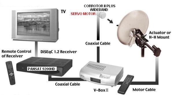

The question is I have the conection in the attached image for my V-Box, Pansat 9200 and Corrotor II Plus Wideband. Alll seems to connect and work properly but I do not know how to connect my Servo Motor with this set up anybody please.

I thought the "Star Trak" was an Analog Receiver, not an actuator.
You need some type of receiver that can control polarity via Servo Motor - 4DTV, Analog, or some of the older Pansat receivers to name a few.
