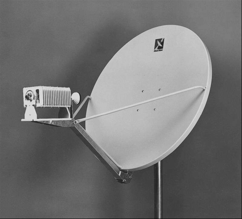

I just picked up a Channel Master 1.2m offset dish. The dish is missing the lnb support arms and lnb bracket. I can make these support arms out of conduit but I need exact measurements so I don't waste days trying to find the correct focal spot. If someone has this dish, can they please measure the 2 side arms and the bottom support arm so I can get this working? I plan on using this dish on my sg2100 motor for a mini c-band. I only paid $10 so I figured I couldn't go wrong. Here is a picture of the dish:

So out of all you testers, nobody has a Channel Master 120cm dish? I am getting desperate here and have searched google all night. Let me know.

I have this sheet but I need someone to measure their support arms. This sheel doesn't have these measurements.
I ended up ordering them from the NA distributor, Dow Electronics. I thought they would be expensive and was going to make them but they ended up being inexpensive at $14 for the whole set. That was cheaper and easier than me buying the conduit and making it myself. If you ever need parts for your Channel Master dish, I recommend you give these people a call.

Just to let you know that these channelmasters are far too heavy for a sg2100 motor. You'll cook the motor if you use it on these babies. I know, I was going to buy one on ebay for around 70$, and checked the specs.....way to heavy.

I think the STAB 120 H-H will move this dish. It has a maximum weight of 37 pounds, and I think the dish and LNB will be under that. At $10 a pop plus the $15 for the feedarms, $25 for one of these dishes is hard to pass up!!!

How heavy is this dish? Fortec 120cm dish is about 37 pounds. And while SG2100 struggles just a little bit (but it is doable), HH120 handles it just fine.
The fortec 1.2 is made of the standard coated galvanized out there (18 or so gauge). The channelmaster is made of a resin (kind of plastic) and has reinforcement members formed on the back to maintain its shape. as a result its about 50+lbs. Can't remember where I found the weight specs of the dish, but nonetheless, I looked into it because I was looking at doing the same thing. I think even the manufacturer recommends a regular actuator for c band to move these.
This is simply not true. Without LNB (but with arms) the dish registers at about 14 kg, which is less than 31 lbs. Standard Az/El mout is about 5 kg (11 lbs) more, and there are custom solutions that could reduce the mount's weight.
